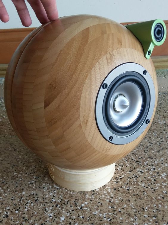

How to build a spherical speaker?
As planet10 was writing, B&W has done further research ending up with a teardrop shape that is better than spherical.
I bought two 28 cm Matte and two Gronsaker, the former to be used in front where the speaker is, the latter on the back to give the teardrop shape.
I’m open to every suggestion, but the idea is to have a full-range speaker, indeed.
Olsen's chart shows the sphere is almost ideal, hard to get the freq curve much smoother IMO. The tear drop may be thought to have advantages internally with standing waves, but these can be addressed using a small and offset insertion of dense damping material within the sphere, and this again IMO is far easier to do than try and construct a tear drop that attempts to match what B&W does out of DIY materials. The B&W shape is precisely manufactured (you can do this with molds for example). Are you looking to glue together one Matte and one Gronsaker (which is essentially a half sphere with a base)? Then, where would you look to cut the hole the mount the driver?
As for full range, my opinion has always been there really is no such thing if you want to cover good bass well below 100Hz through to really crisp highs. Something gets sacrificed. You can focus on mid bass to the high end but still would need a sub to complement IMO. So you can attempt to DIY the high tech tear drop shape while putting in a single driver.
Attached is one example of a DIY that uses the large bowl for a single driver mounted plus a small tweeter on top (not hard to do) and then a simple base. I would use a decent say 6" - 7" woofer and 1" tweeter with small face plate and cross over where appropriate based on the drivers selected. There's plenty of room to stick the crossover board in the sphere and the terminals on the back lower down to the base. And put in place inside an offset object to break up any standing wave issue. Most smaller woofers need a 1/3 cu ft or less volume (sealed) or less with a port, and the sphere gives you about 1/3 cu ft.
This can get you down to maybe 80Hz pretty well, and if you want deeper base, add a sub to the system. You can just buy one as at these low frequencies, the sphere shape no longer really matters with the very long wavelengths.
In order for a sphere to vibrate with any resonances, it needs to pulsate which is unlikely as it is simply the strongest enclosure, even more so than an ellipsoid. I use a 3-part damping approach with acoustic paint (essentially latex with cement mixed in to make the wood as much like cement board as possible), then dense carpet underlay glued in and finally fiberglass stuffing. I put in my 4-sphere design a 6.5" Skar sub (down-firing) into the bottom sphere and played a lot of deeper base stuff (incl. prominent base drums and cannons in certain good recordings) and have not been able to hear any vibrations caused by the enclosure.

I would think about adding a styrofoam tail to the bottom of the Gronsaker. but if the 2 mate up (you do need a connecter ring (where i put the vents) as these vbowls are not fully hemispherical.
