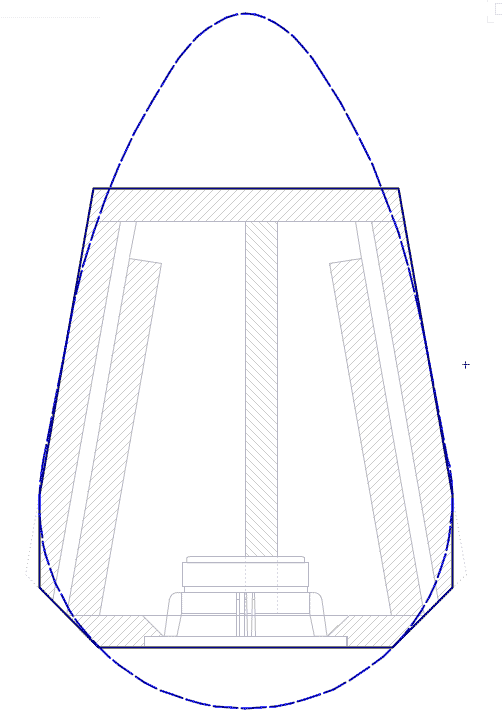

As to the teardrop shape i would reference the work done by B&W and Eclipse.

I can see in both teardrop examples, getting the tweeter closer to the midrange cone was more important than maintaining a symmetrical interior shape. In both cases, the tweeter housing intrudes into the interior shape. Is there some sort of tradeoff between having the sound seem to come from one source vs having the sources farther apart and the interior of the cabinet symmetrical? Why not move the tweeter until its rim is touching the rim of the midrange? Do those two drivers need to be separated from each other or should they be brought as close together as physically possible?
The B&W speakers seem to have a rod running down the length of the teardrop on the inside and the Chinese ones have that chrome bullet shape in the center. Does anyone know the purpose of those structures? Would those speakers sound worse if the interior structures were not there?
In the case pf the B&W the rod is at tension and is what holds the driver in place. In the Eclipse the bit you refer to is part of the “suspension” system. In these the driver is connected to the stand and the enclosure floats around it.

Here is the meat of Olson’s worl that Rod used to write that piece.
His research was extended by B&W to get the teardrop.
