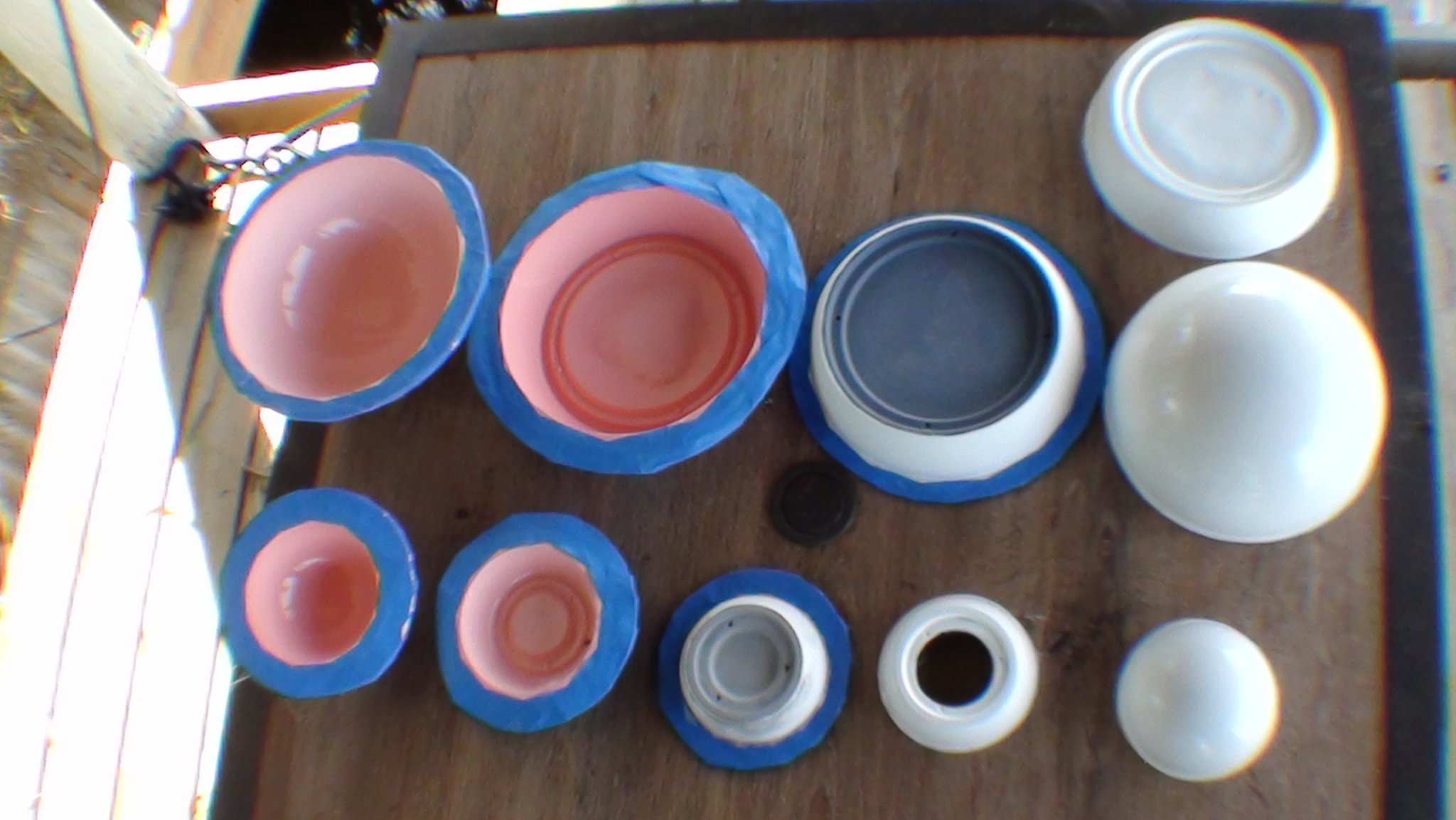

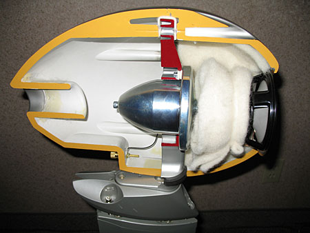

Dave, I manufacture industrial prototypes. I can fabricate any shape. Can you share references to those complicated looking shapes and why a sphere is the worst? What is the function of the rod extending from the back of the driver through to the pointy part at the very back of the housing? I started making spheres because everyone here is making them. This is a lot of work to go after better performance, and in my case, just about any shape is a similar amount of work as any other. Please inform me of the ideal shape if such a thing exists.

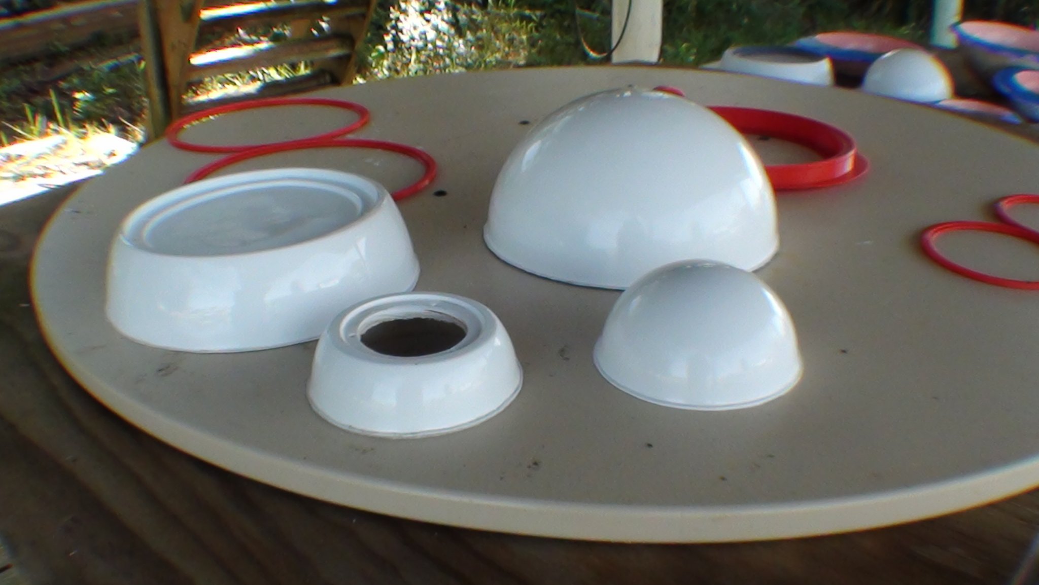

I began my spherical speakers using acrylic hemispheres as molds. The hemispheres can be purchased in a wide variety of sizes. Some shops like globalplastics can make custom sizes for a little extra. I made fiberglass molds from the acrylic because fiberglass resin attacks the acrylic. The actual fiberglass spheres were made using the fiberglass hemisphere molds.
Having made several fiberglass hemispheres, I cut a hole in one and 3-D printed an insert shaped to fit the flange of the drivers. After gluing the insert into the hole in the hemisphere, I made another mold of that. Each speaker sphere needs a front and a back mold to make the front and back half of the spherical enclosure.
Prep work involves many coats of paste wax in the mold and several coats of sprayed-on polyvinyl alcohol that serves as a release layer. Layup starts with two or more layers of gelcoat painted inside the mold. Gelcoat and polyester fiberglass resin need to be mixed with about one or two percent peroxide hardener before use or they will not harden. Wait for each coat to harden before applying the next. Then I paint the inside with polyester resin (don't use epoxy because it will not dissolve the binder in the chopped strand mat that comes next). I use chopped strand mat for the structural glass in the composite. I tear off little chunks that I glue to the interior of the hemisphere one little chunk at a time using a brush and more polyester resin. This is the easiest technique for complex curves like a sphere because the woven cloth will not flex into a complex curve. Gradually I cover the entire interior with the chopped strand fiberglass. This is random fibers held with a binder until you apply it. Then the resin dissolves the binder and the loose fibers can conform to any shape.

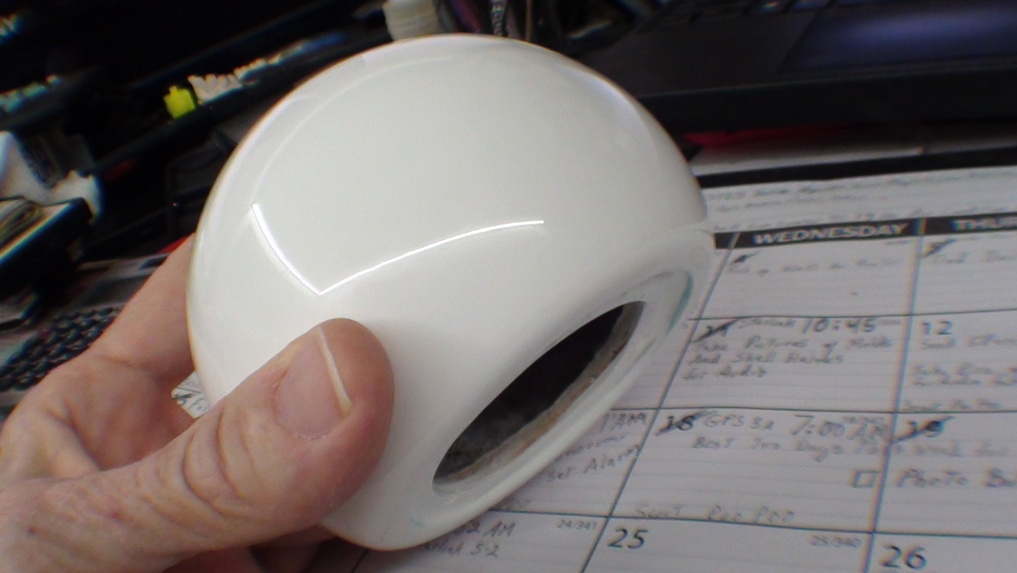

The spheres in the picture were for a cheap set of drivers from a Dayton Audio B652 bookshelf speaker. We want to do whoop tests on the unmodified speaker and one made with two hemispheres. If a spherical enclosure and possible internal reflection mitigating structures work, we plan to make some for nicer drivers. This is my first post on the forum, so any advice from members is welcome please!

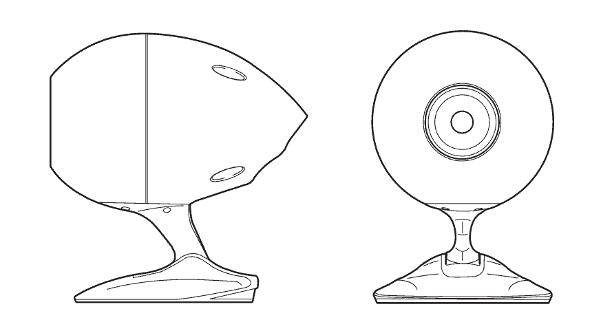

The issue is that the internal dimension is the same, which gives a very strong internal resonance. No reference required, that is just geometry.
On the outside a sphere is very good as long as the driver mounting leaves no discontinuities.
As to the teardrop shape i would reference the work done by B&W and Eclipse.

I have been working with sciencelookes in the fiberglass speakers. Some more pic. One of the advantages of fiberglass is that the strength of the enclosure can be increased to avoid resonances. I will be measuring them and comparing with the ba52, just used as a driver donor to make a/b test. I have several ideas for the Internal resonance that will be testing and posting the results.

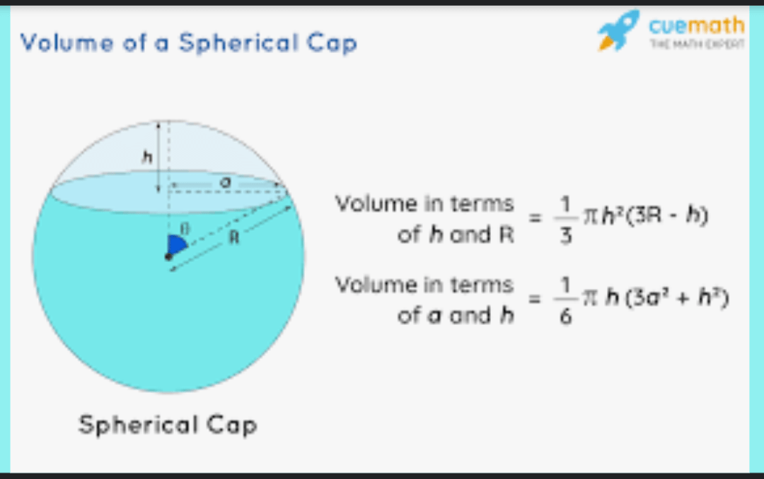

When calculating the volume of a sphere for a speakers cabinet, the formula to use is the one for a truncated sphere.
We can calculate the volume of a section of a sphere using the formula, V = (1/3)πh2(3R - h), where, height h of the spherical section, and radius R of the sphere from which the section was cut.
Below the hemispheres before attaching and the tweeter driver
Thank you so much! I started making fiberglass spheres because everyone is making spheres, but almost any shape could be created using this process. The teardrop shape could be cut from foam on a lathe to make a solid buck that serves as the model for a mold. We could even use a CNC if there is a specific geometry.
There are so many considerations once you move away from rectangular boxes. So we want the front to curve away smoothly on the outside but we do not want a symmetrical sphere inside because it creates resonances at wavelengths that are multiples on the interior radius? Is this why the interior cone shape at the back? To create a continuously decreasing radius that prevents one wavelength from dominating?
Should the inside of the teardrop still be lined with foam or other sound absorbing material? We were planning sort of a radial honeycomb inside the spheres or possibly soft foam fingers with a ball of butyl rubber at the tip of each finger as a way of dampening internal reflections.
The first is important, the driver should deform the semi[[sphere on the front as much as possible.
dsc00104-jpg.1147784
This is probably too flat.
The teardrop shape (and the bits inside) work to decrease and distribute internal resonances. The long shape is a half-wave TL (it could be quarter-wave). It also works to decrease eddy current as the wavefoems pass back past the fatest part of the semi-sphere.
This is what B&W came up with after likely 100s of thousands of £ of research.
And the research would have been in Yen here.
dave
Hmm.. as written, you have h2 instead of h^2 . Do you mean:
Or is you're gonna write it "normal" then, it's V = (1/3)(pi)(h^2)*(3r-h)
It's the volume of a spherical cap.
