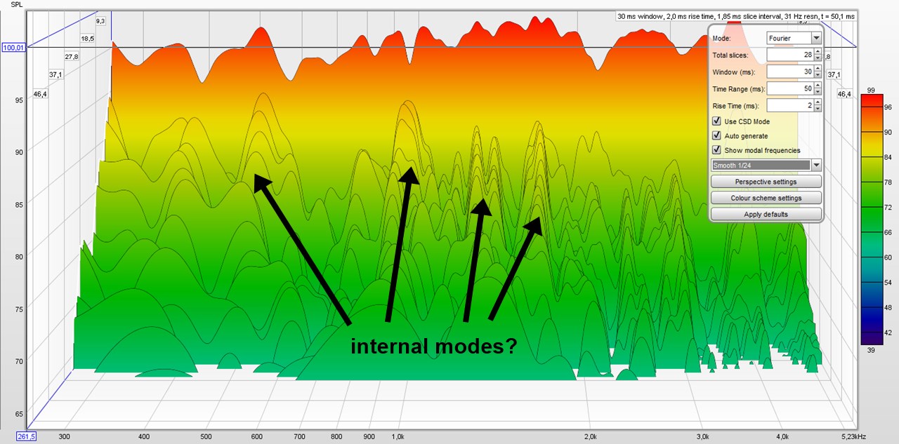

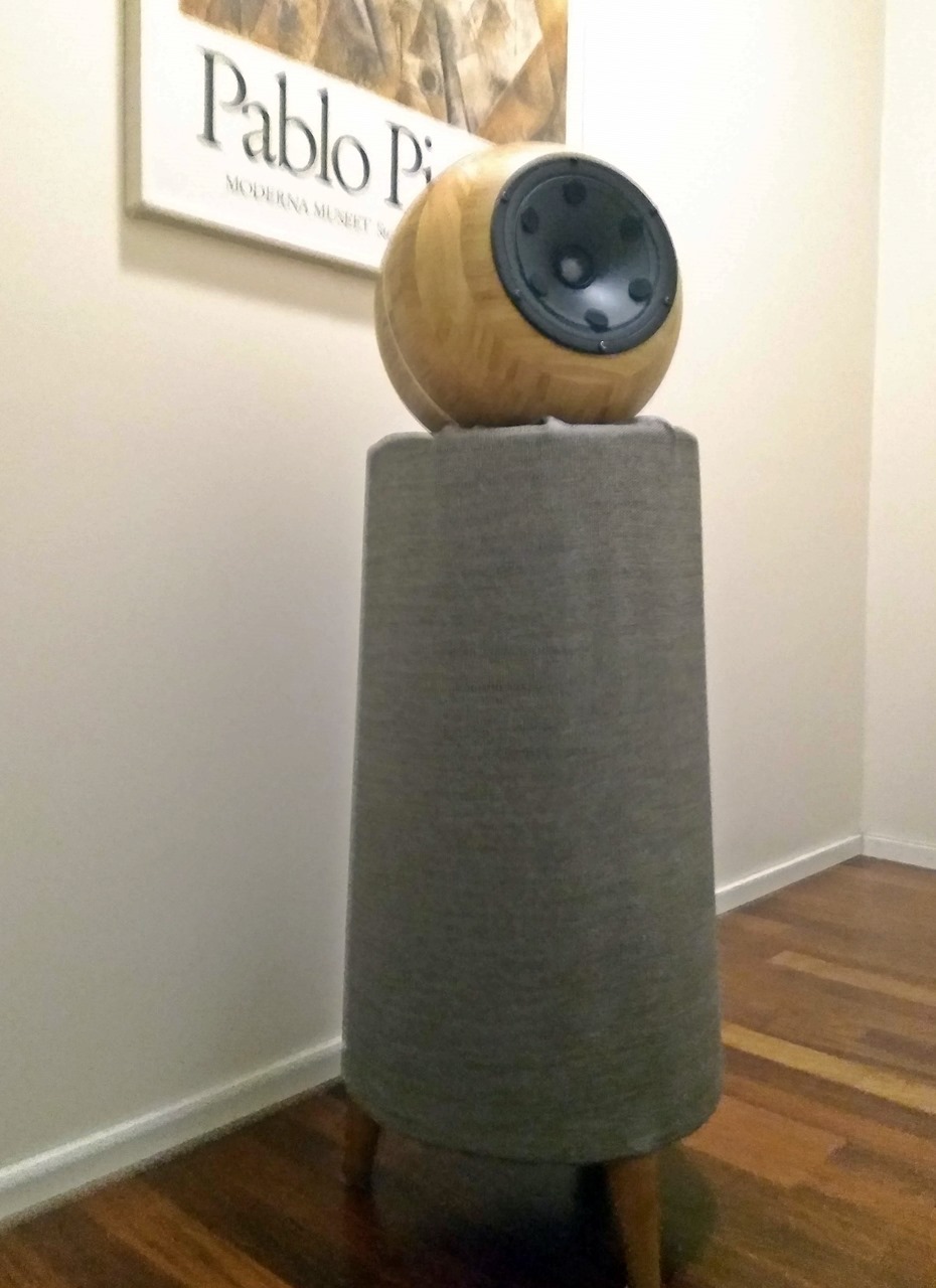

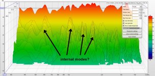

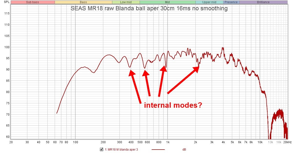

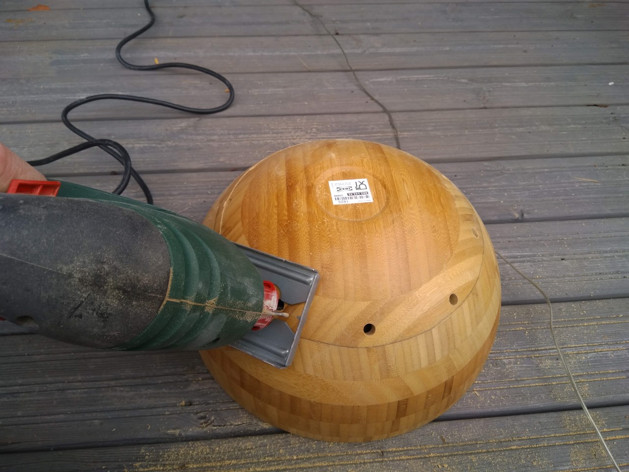

I used IKEA Blanda bowls too, in 2018, with aperiodic vent and SEAS MR18 coaxial. Halves glued together with silicone. Sealed bass box as the stand.
https://www.diyaudio.com/community/threads/seas-mr18-3-way.322839/
A ball has very strong standing waves, because diameter is same in every direction. In case of IKEA Blanda approx. 600Hz is first mode. Stuffing in the middle of the ball helps a little.
A ball is not necessarily problematic because of the same distance all around for a standing wave. The inner shape does not have to follow the outer shape, it can be anything.
^Yes, the motor of a cone driver might be near the mid of the ball and break waves. Anyway, it is the worst internal shape one can have. If the inside of the ball has golden ratio dimensions, it will have very small volume.
My spherical speakers are now at my daughter's apartment, so I can't take more measurements, eg. with the mic inside or nearfield of the cone.

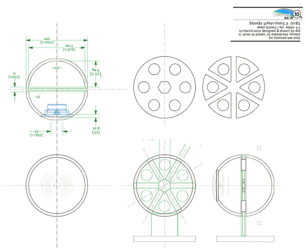

I designed these for a fellow in Spain.
dave
dave

A ball is strongest structure yes, it will not pulsate - no "box" resonances. But, the driver's membrane will react to the internal pressure of standing waves! Lowest mode is always strongest, and easiest to kill. Multiples are countless but much weaker. A 2-way driver's woofer also doesn't excite hgher modes much because of lowpass xo. So, focus on attenuating the first mode!
I don't have my Blanda speakers at home any more, so please someone else perhaps can measure impedance of the driver and put a mic inside the ball !

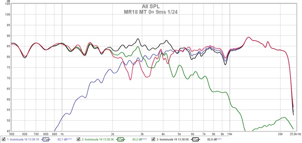

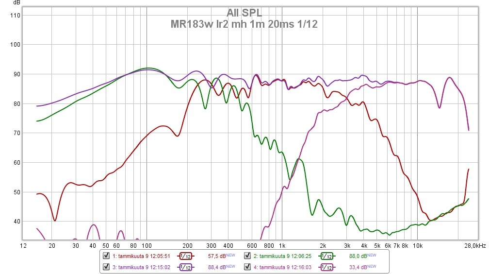

I haven't saved a measurement of my ball's vent, but I remember measuring it and the effect of stuffing. In my case the motor of the driver is smack dab in the middle of the ball fortunately. The vent is on the bottom of the backside ball, ¤6cm, and I made it right away, without any tests of a closed ball -because my speaker was inspired by Gradient 1.4 introduced in 2018. And I remember having read of these other spherical/Blanda speakers at diyaudio.com earlier

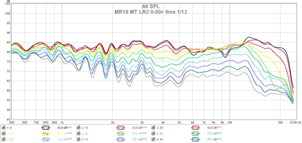

Here is semi-nearfield measurement of on-axis response of the mid with without eq or xo.

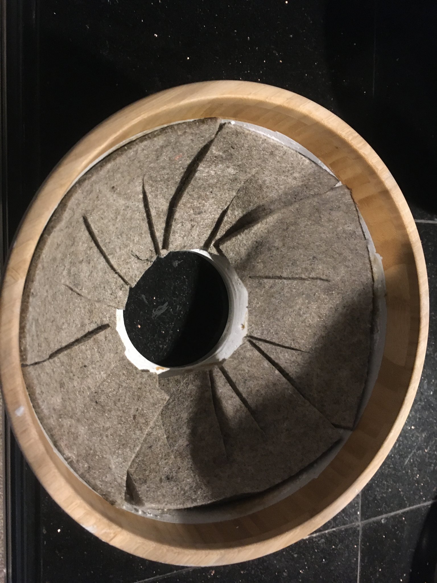

I have used a 3-part damping system in my spheres, including cement-based paint on the inside of the spheres to increase density, a layer of dense carpet underlay glued on top of that, and then generous fiberglass stuffing.How about damping material? Broadly speaking, different shapes for the same volume will still have standing waves. In this case you have the driver at the edge, which is interesting.
The boundaries between pressure areas are opportunities to damp.
Pic of damping...I have used a 3-part damping system in my spheres, including cement-based paint on the inside of the spheres to increase density, a layer of dense carpet underlay glued on top of that, and then generous fiberglass stuffing.
Admire your experimentalPic of damping...
Admire your experimental approach. Some many variables to consider in audio you have to often think outside the proverbial box. Dave seems to have the physics nailed down on internal wave reduction. Posted some great pictures too on multiple small sound wave capturing black holes. No reflections in a black hole that any one has actually heardPic of damping...

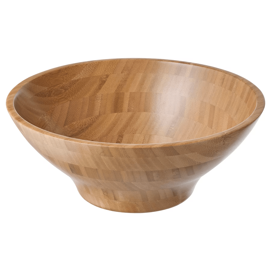

Hi Dave,I designed these for a fellow in Spain.
yesterday I was at Ikea and saw the Blanda (the big one, not the small one you used for this design), then I saw the Gronsaker that has the same diameter of 28 cm and, together, they create a drop-like shaped cabinet that I remember you wrote is one of the best shapes.
What speaker and with which configuration would be the best for this cabinet?
They will be most probably on a desk, because the livingroom will have the Silbury with MA10.3 and another room the FHXL with MA11ms.
