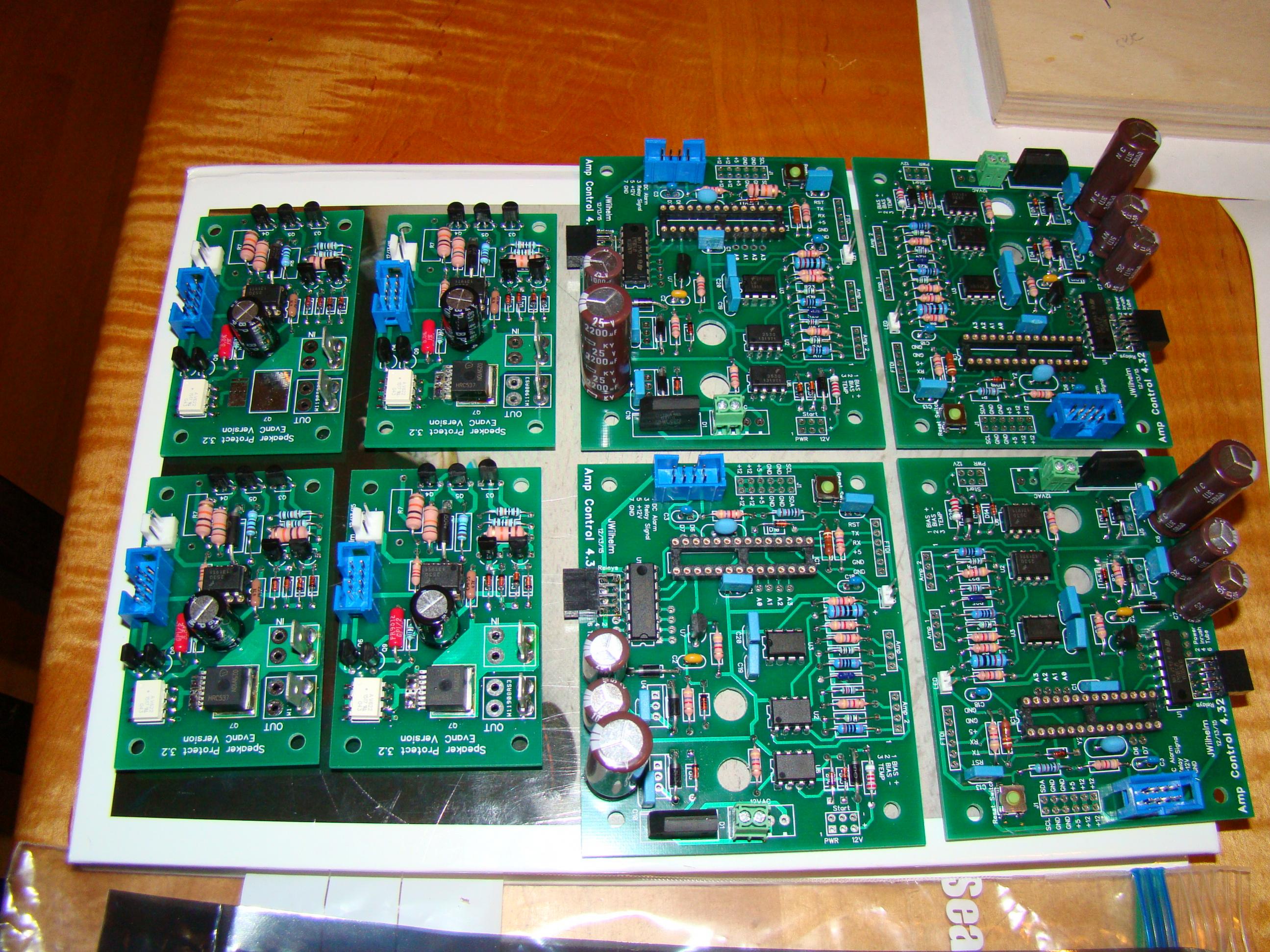

Four more sets about ready to be pressed into service. All my amps are mono so no worries.
These are going into service in my monoblocks. Unfortunatly I blew D5 on the atmega on one of the boards, so I have to replace the chip. It's gonna be interesting to remove and solder a new atmega with fully populated board.
You will need to concentrate the heat from the heat gun. A tinfoil funnel might work. I usually preheat with an iron and a big tip first. Lay a lot of solder on, then add more with hot air until the IC is free. Don't pull the IC, traces will come with it. Get it hot enough to fall off.
Another option would be to cut the trace to D5 and jumper it to D6 or D7. It's easy to alter the software to run from another pin.
I keep lots of boards in stock if you make a mess.😀

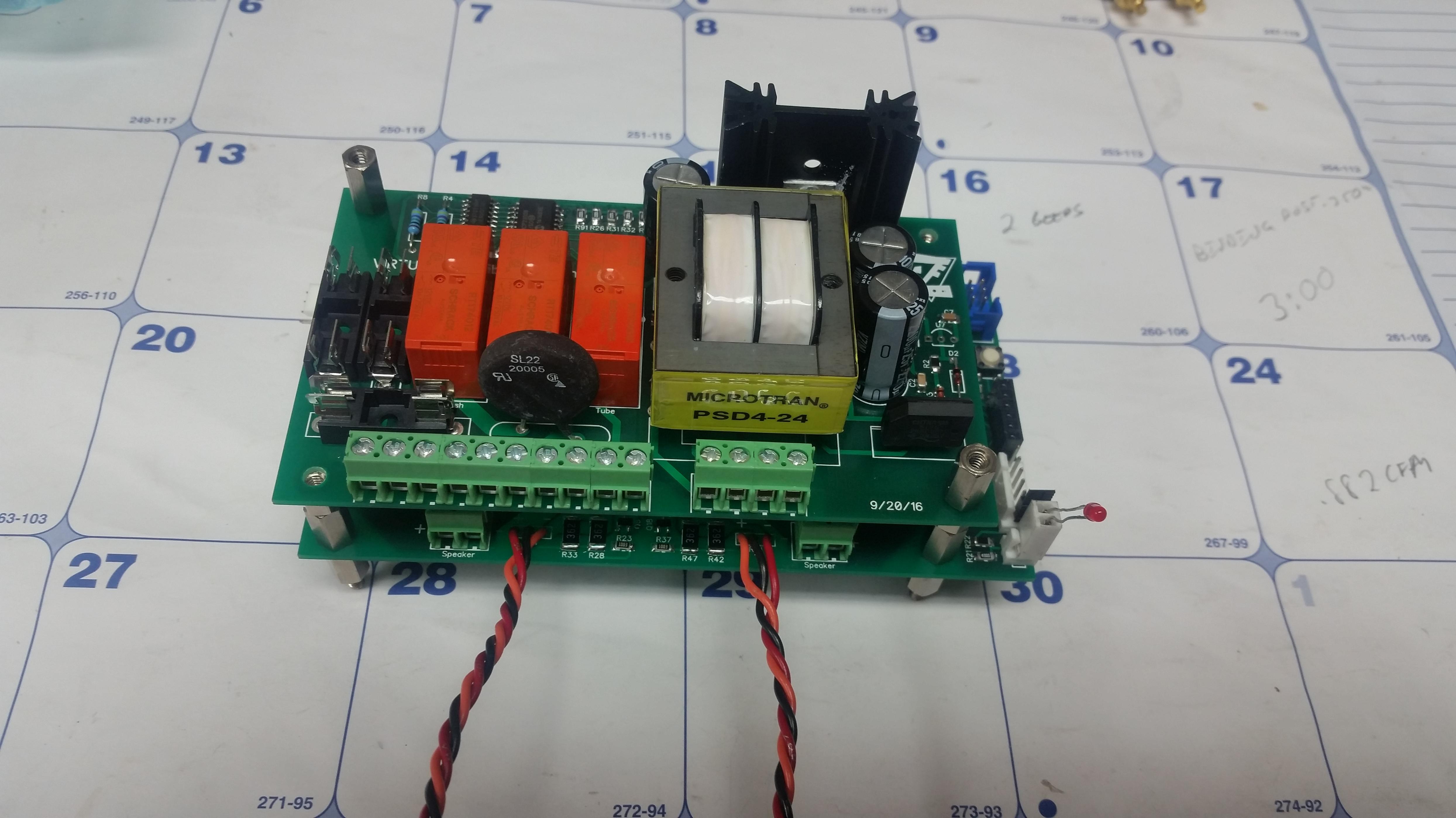

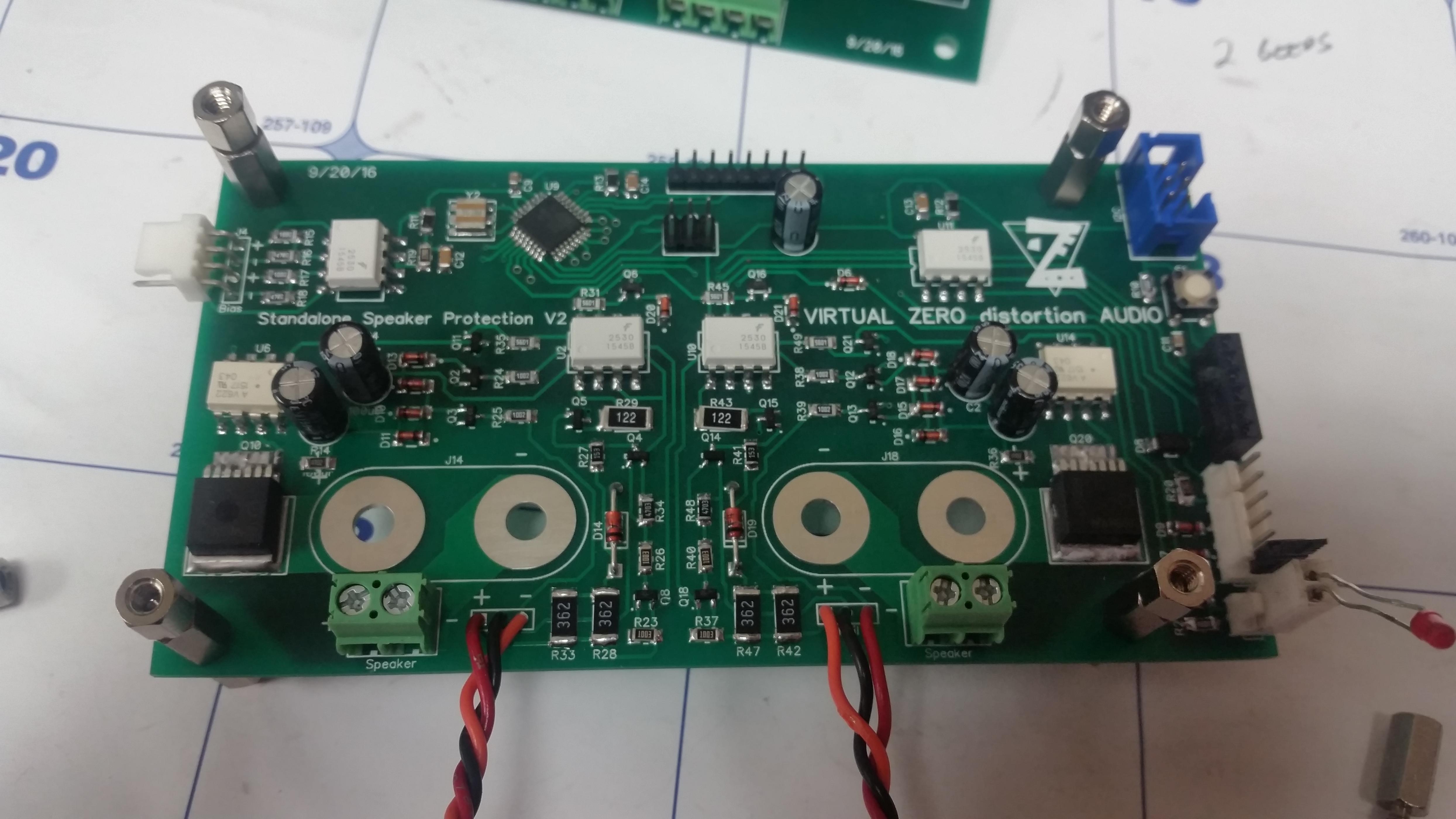

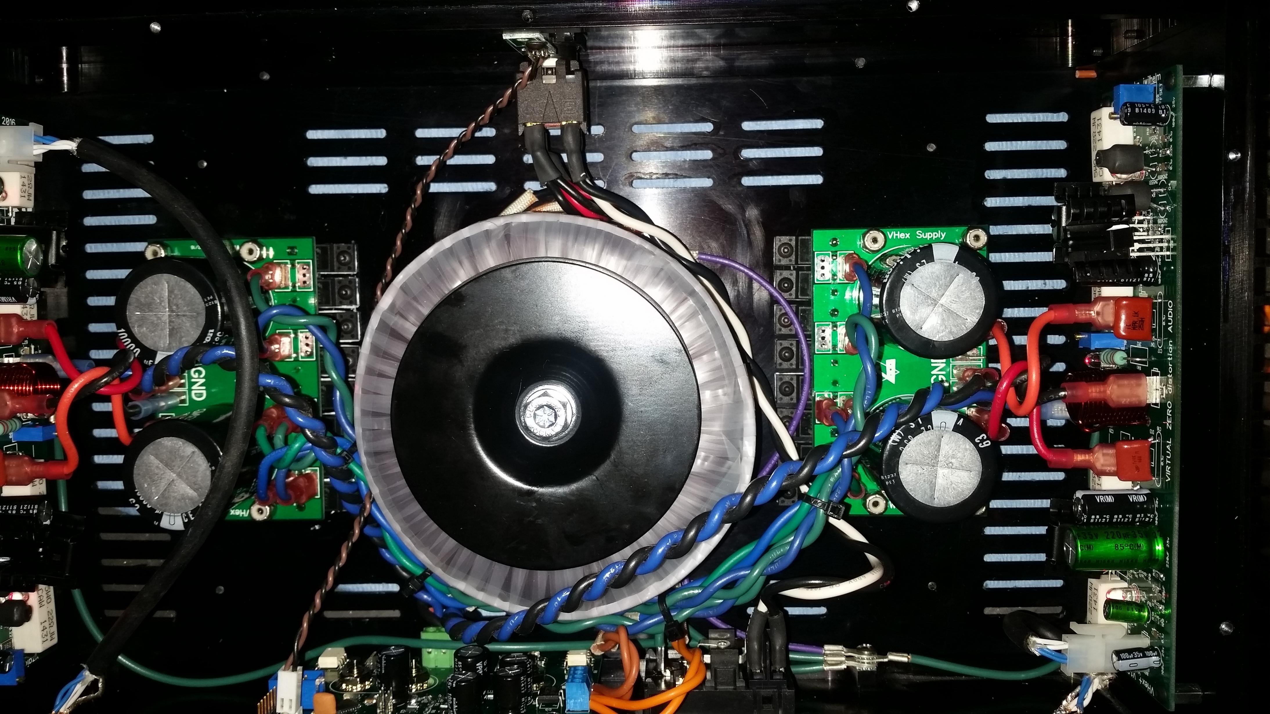

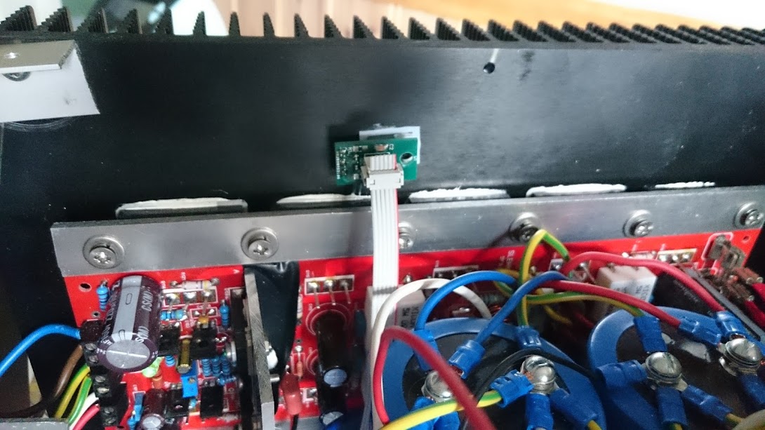

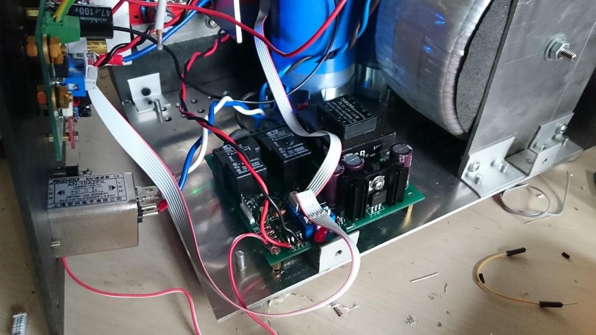

My latest version for the VHex amps is a stacked version that mounts on a 2U rear cover and has everything on board. I've put some time into lowering current consumption, so I can get away with a much smaller transformer and regulator heat sinks. This one barely warms up.

What I never understand is this discussion of the separate star grounds or a single star ground. It seems that even with the separate star grounds that as soon as you go back to the power outlet or somewhere not far from that point the two separate grounds will merge at some point, so isn't that just a larger loop area but still a loop that connects both ground sides together? Wouldn't the single star ground have the least loop area to contend with?

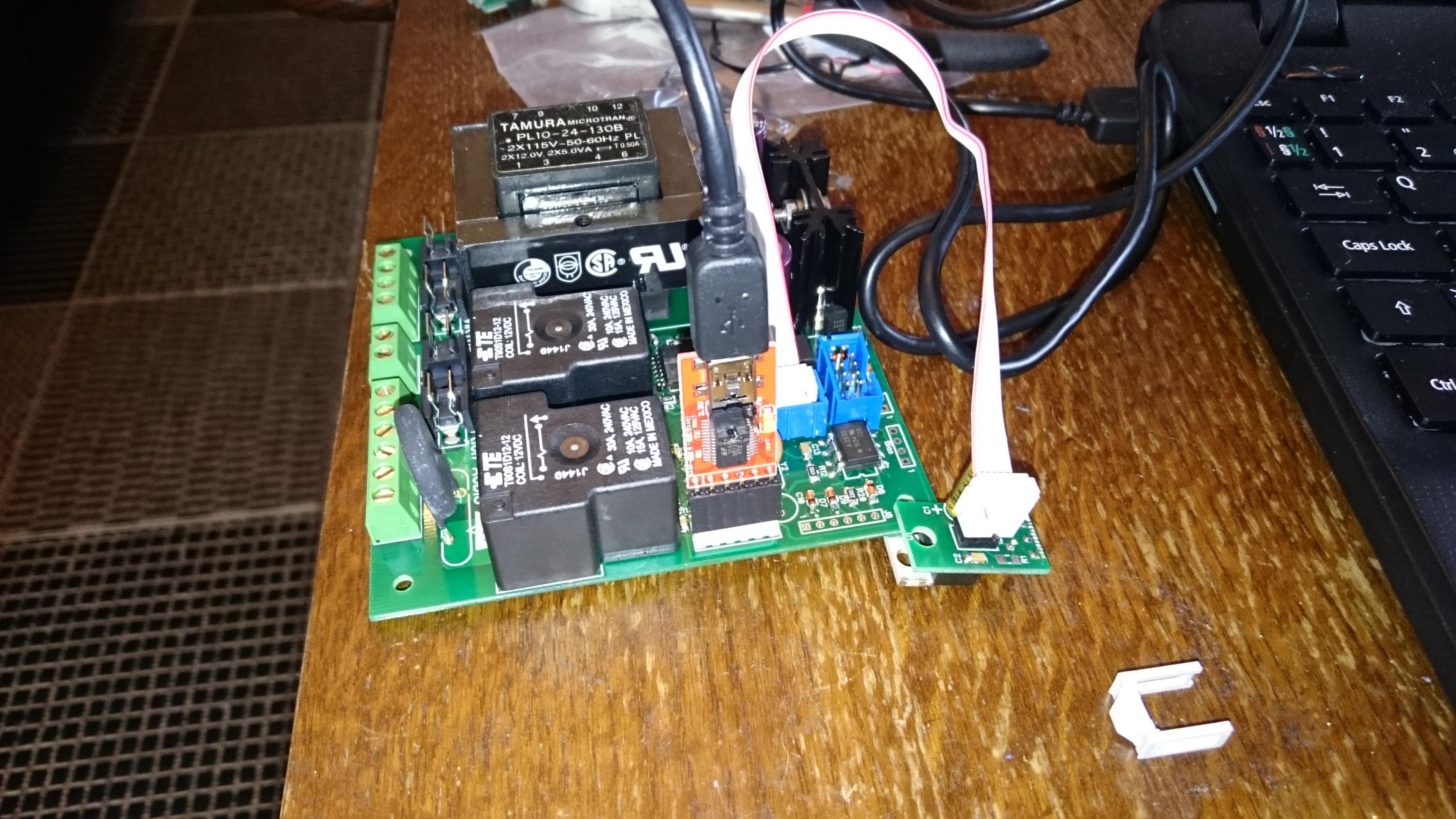

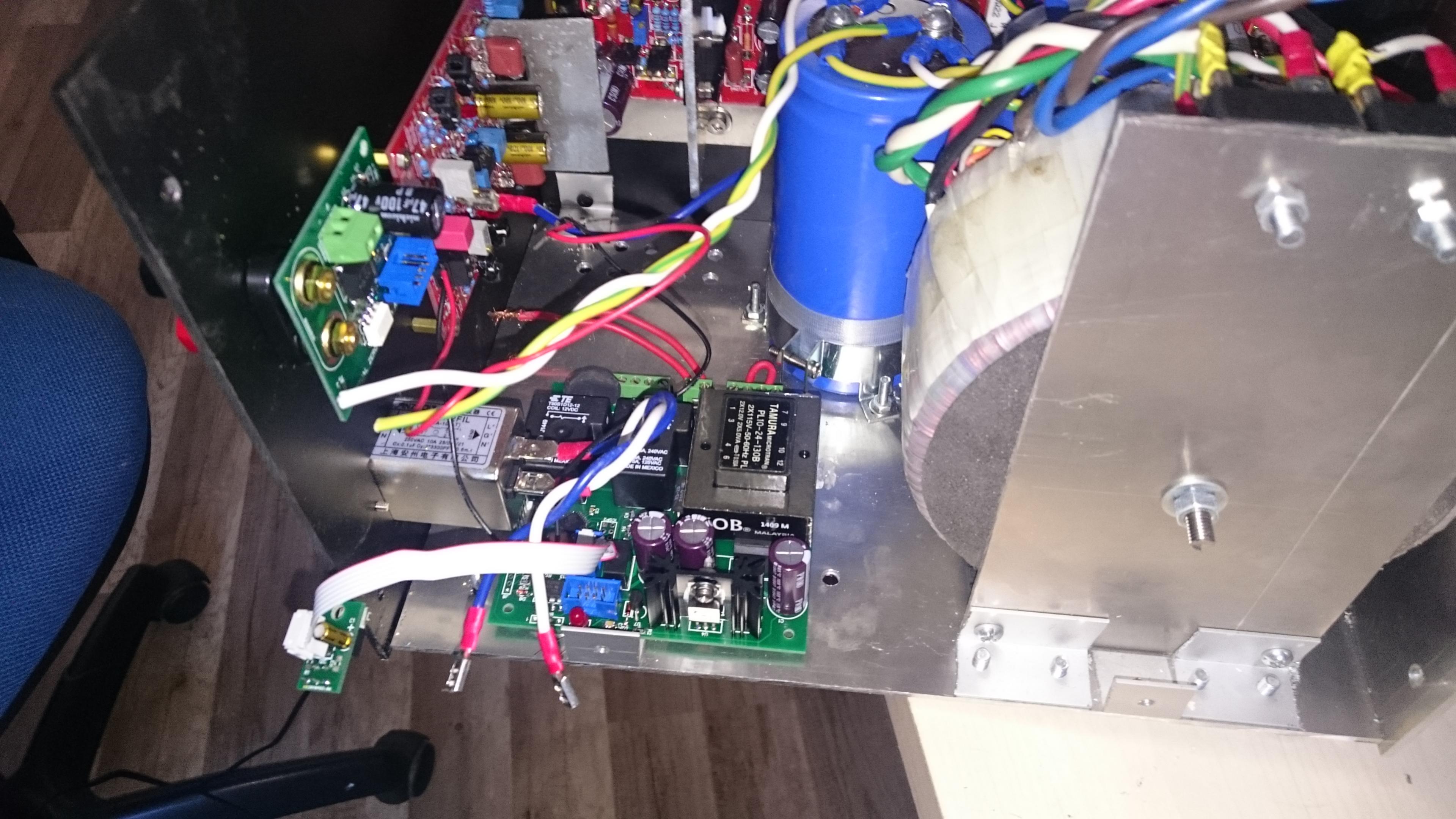

I desoldered and bent away D5 and blobbed some solder on to short the pad to D6, changed the code and tested. That worked. 🙂
Now I have a strange problem.
The amplifier starts fine with no load connected, but when I plug in my subwoofer, it trips on DC offset after a few seconds.
If I start the amp with the subwoofer connected, it goes through the startup sequence, then i get a slight thump in the subwoofer before it shut off.
If I start the amp before I connect the woofer, it will play bass for a few seconds before it trips on DC offset.
Any suggestions what causes this?
Edit: Never mind. It's caused by real DC. The relay won't hold in when It's going through the resistor, shutting down the transformer. I'll have to change the code again to keep it from switching off. 😉
