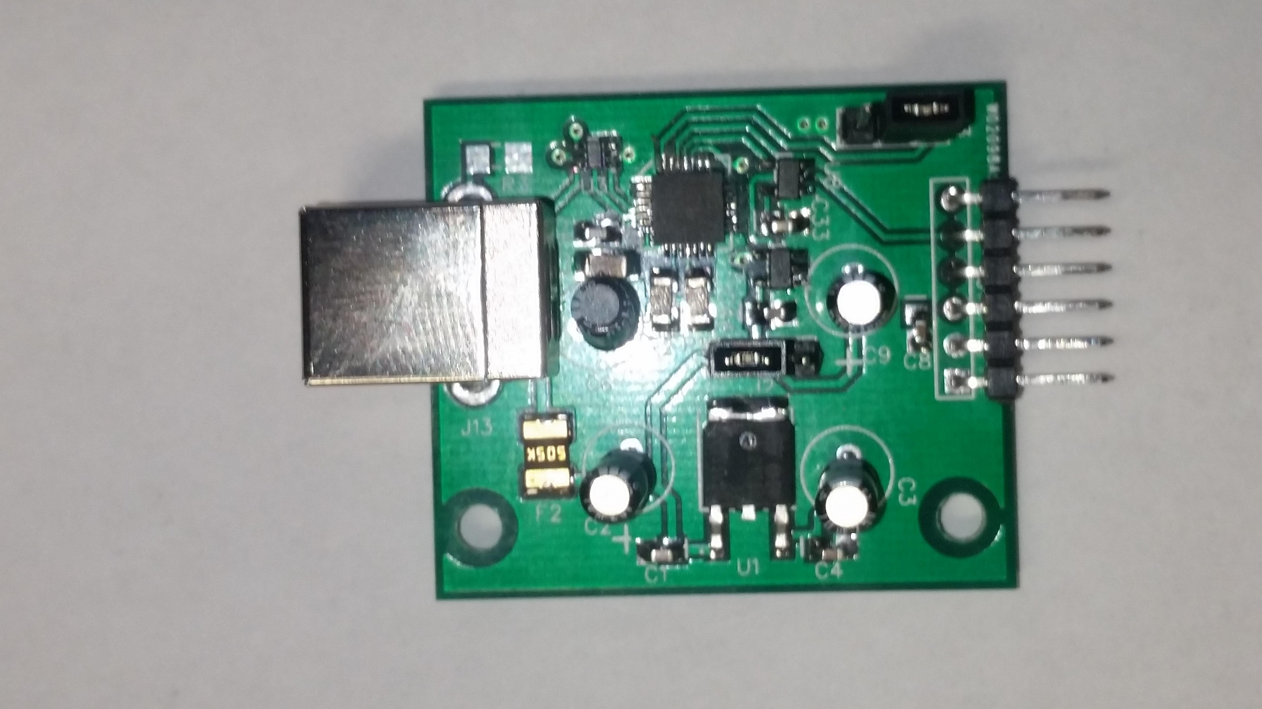

Here's the next step in the move to external interface for the amplifier. I've got a proper USB to serial adapter running. It uses the CP2102 USB to UART bridge, which operates at 3.3V. I added proper level shifting for communicating to 5V devices, and some ESD filtering and level shifting on the USB connection. It uses a old style USB B connection, so it's tougher to break too. It should mount nicely into a rear panel for a permanent connection.
Parts are $8 USD from Mouser. This can be scaled back a bit too. I can loose some caps and put a smaller regulator on board in the next version.
I'm going to look into designing an inexpensive in circuit programmer to flash the bootloader too.

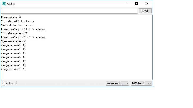

$8 is not bad. What kind of info will we be able to get from it? The state changes and continuous temperature update in the diagnostics mode was nice, if it could show other parameters like for example emitter current it would be awesome.
At the moment this is just going to be a programming interface. We need to be able to communicate with other devices without slowing down the monitoring of the protection systems, so we should be offloading this onto some other device. Using the serial monitor window for example, uses a bunch of interrupts to do the communication with the PC, so there would be short lapses in the monitoring while it passes each bit to the PC.
