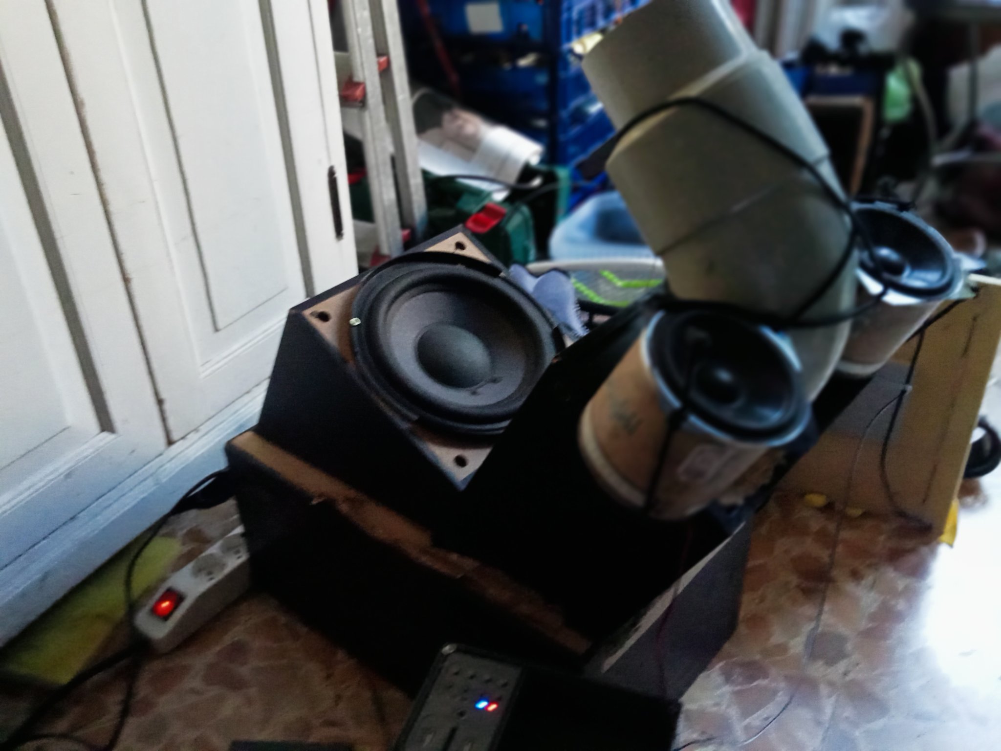

I passed the whole afternoon listening to Bluetooth 2.1 with newly conception BIG sub in my room eh eh someone must take the task!
Outdoor, it works with a 18V drill battery!
yeah this this thing makes me sick! I cannot stand digital & associates, but three amplifiers in a 12X4 cm PCB with no heat problems and the ability to receive BT streaming is the "new thing" so we must face reality.
Little portable system, before applying some lead sheets ( I cannot stand extra sounds! )

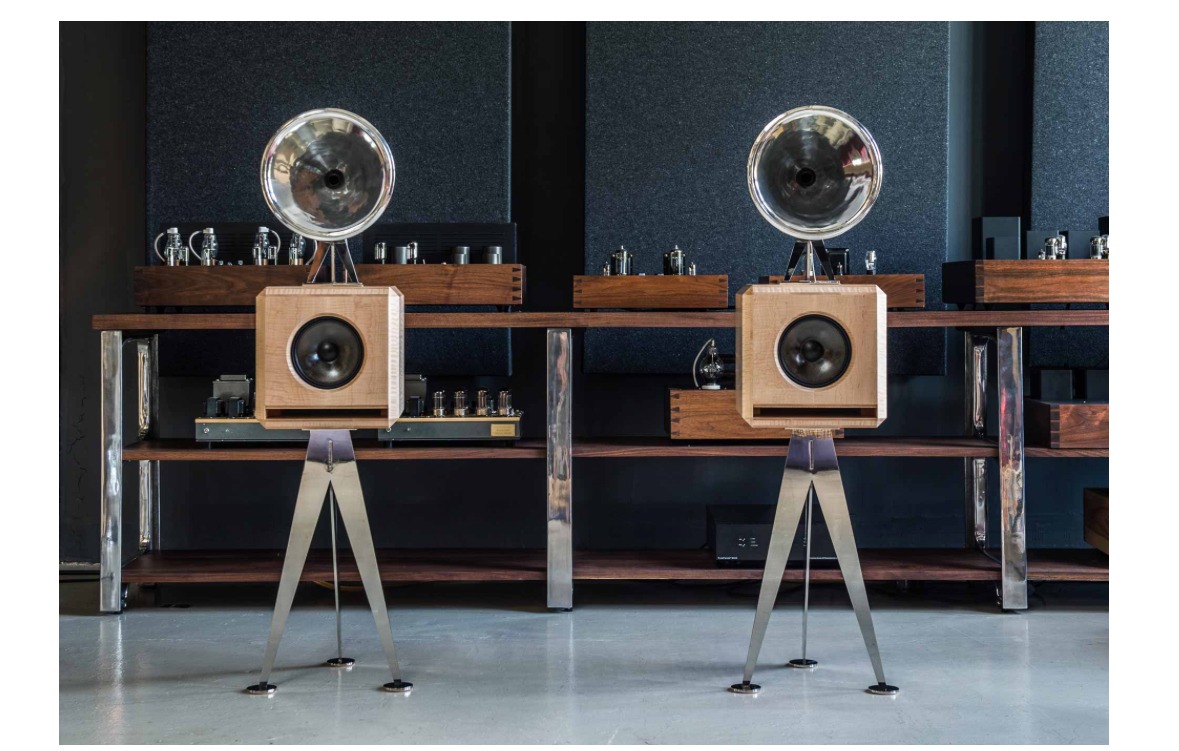

Where does diy have a clear advantage?
One advantage the smart diy builder has is to design a loudspeaker that will work in his room using outboard sub woofers for a smoother better bass response.
This approach directly translates to an improvement over a one size fits all approach adopted in tower system while also providing a cost saving. This is a result of a smaller main enclosure and less drivers needed and a much simpler implementation.
There are technical benefits too including making the main enclosure relatively efficient up in the mid 90 db area. Therefore less powerful amplifiers are needed. This provides the opportunity for a diy power amplifier.
Dave Wilson was one of the first to consider this approach with the highly successful Wilson Watt. Bose then saw the market for satellite systems among others. More recently OMA devised the OMA mini which caused quite a stir. Such an idea could be the basis of a very compelling diy project.

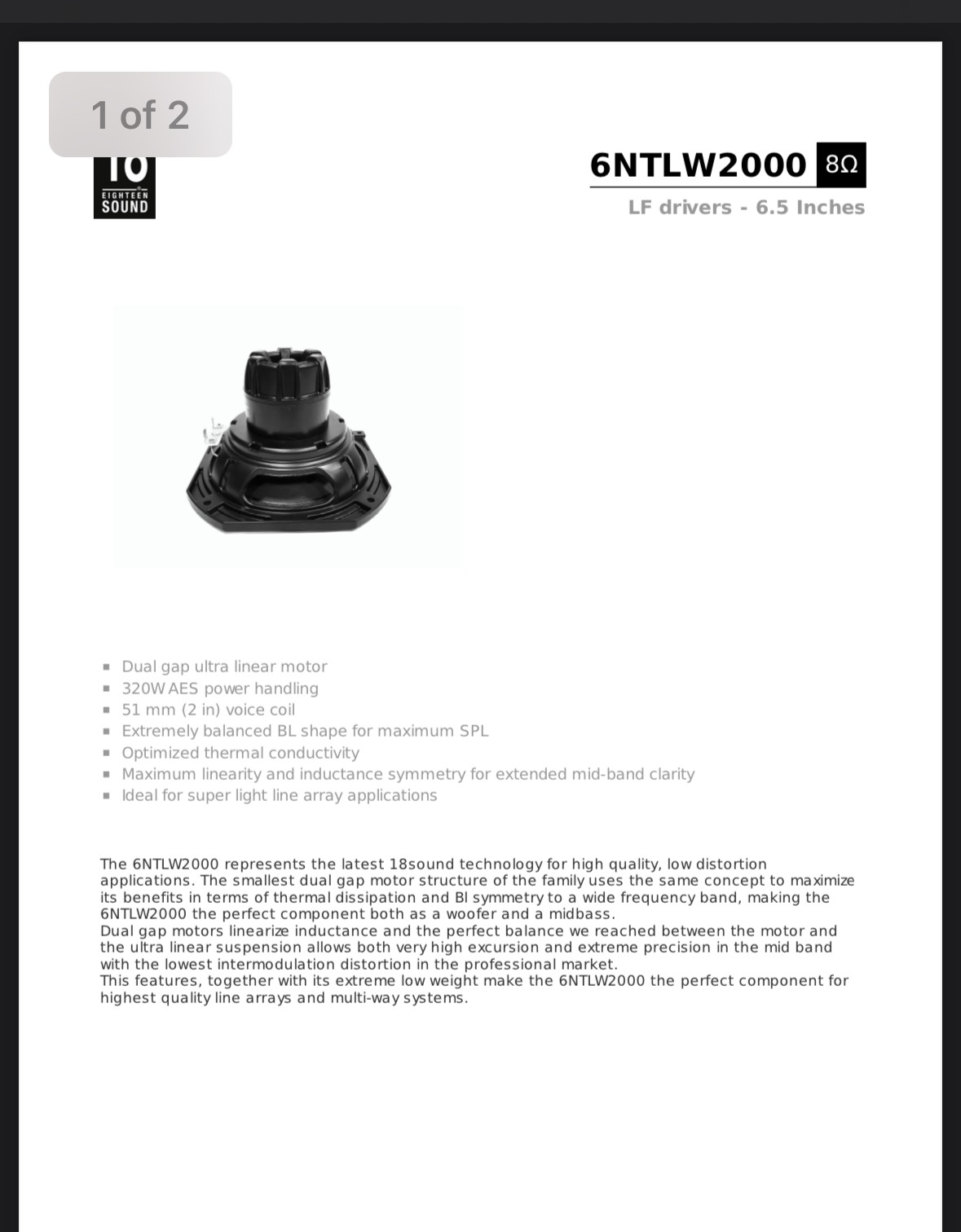

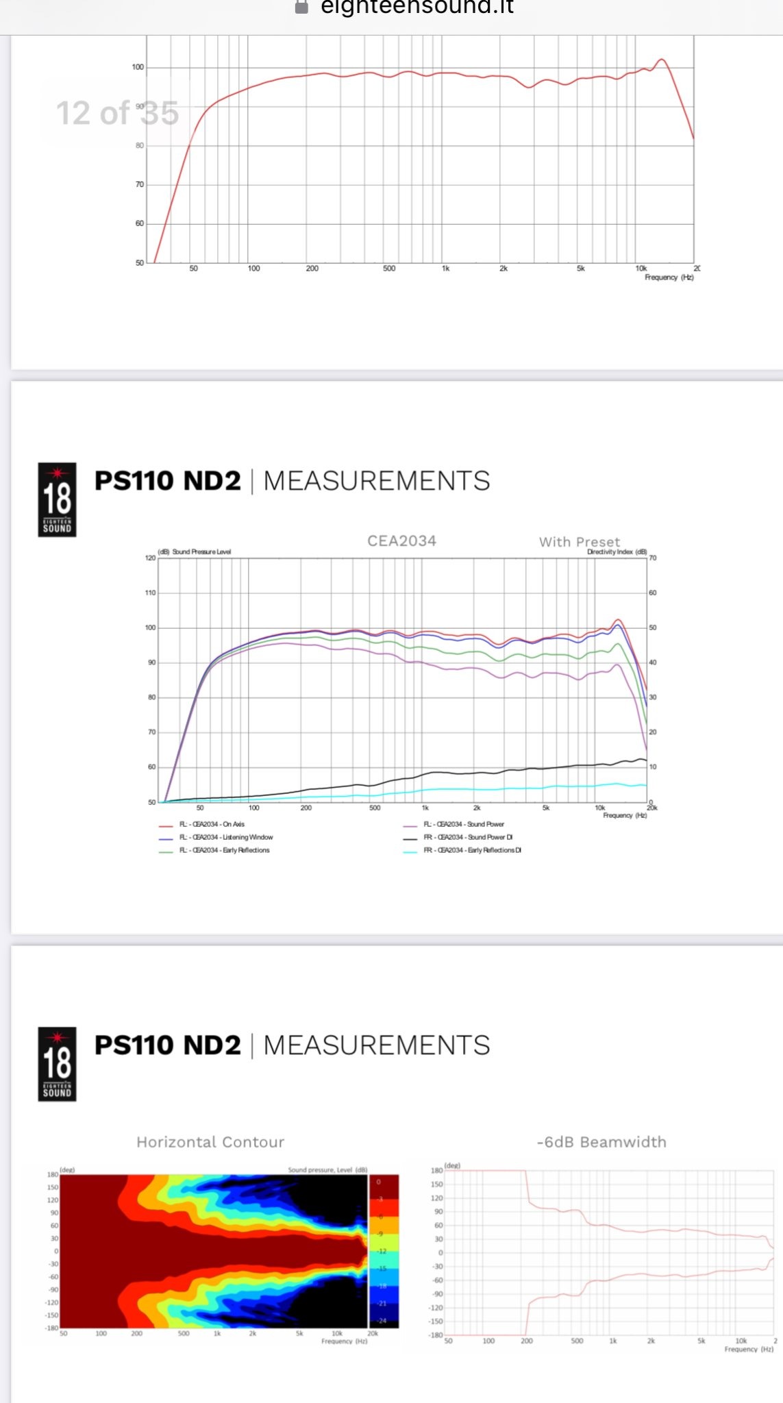

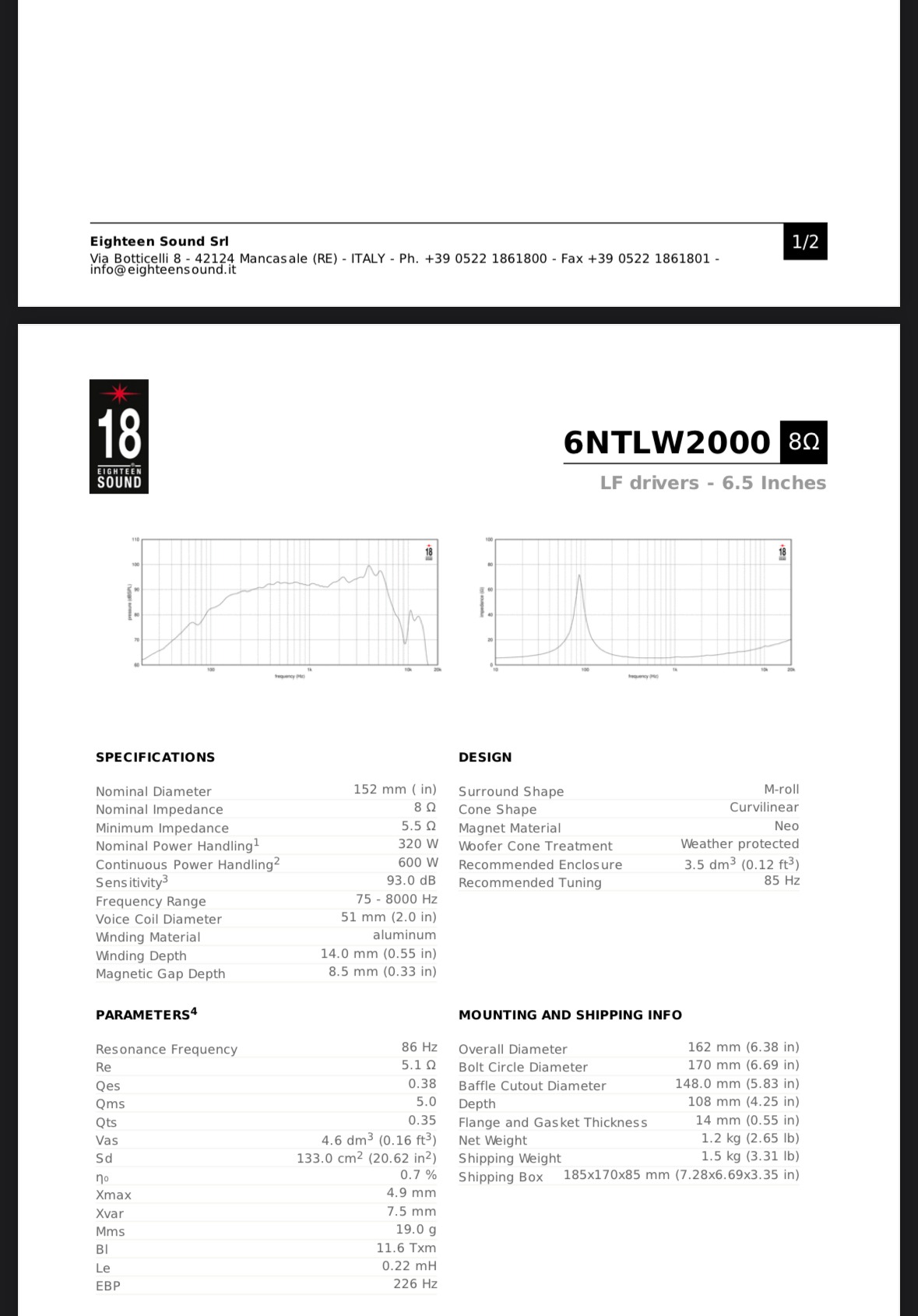

Looking at the example of the OMA mini the diy builder has an opportunity to be creative with the sub woofer.
It could be a 1/4 horn, a rear loaded folded horn, a bandpass, sealed, compound or reflex design.
The clincher is in selecting a design that will allow good performance up to a crossover point of 150 hertz. This might seem a high crossover point but not for a musical sub. The wave length is about 2 meters so the sub can sit right up against the floor wall junction and obtain an advantageous +6 of boundary gain at low frequencies. This translates to a smaller enclosure than you might think. The bass has far less ripple in the upper 150-300 hertz region due to the lower 1/4 wave reflections off the wall boundary. While the main loudspeaker can be positioned for the best sound stage.
This kind of focused or structured approach has a real payoff for diy.
Really excellent pro mid bass drivers can be used in the main loudspeaker to deliver life like sound reproduction along with a suitable wave guide and compression driver.
Diy loudspeakers don’t have to be difficult if you are provided an explanation of some real choices that you can build with great results.
