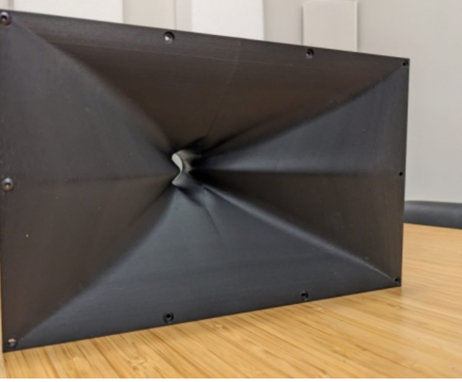

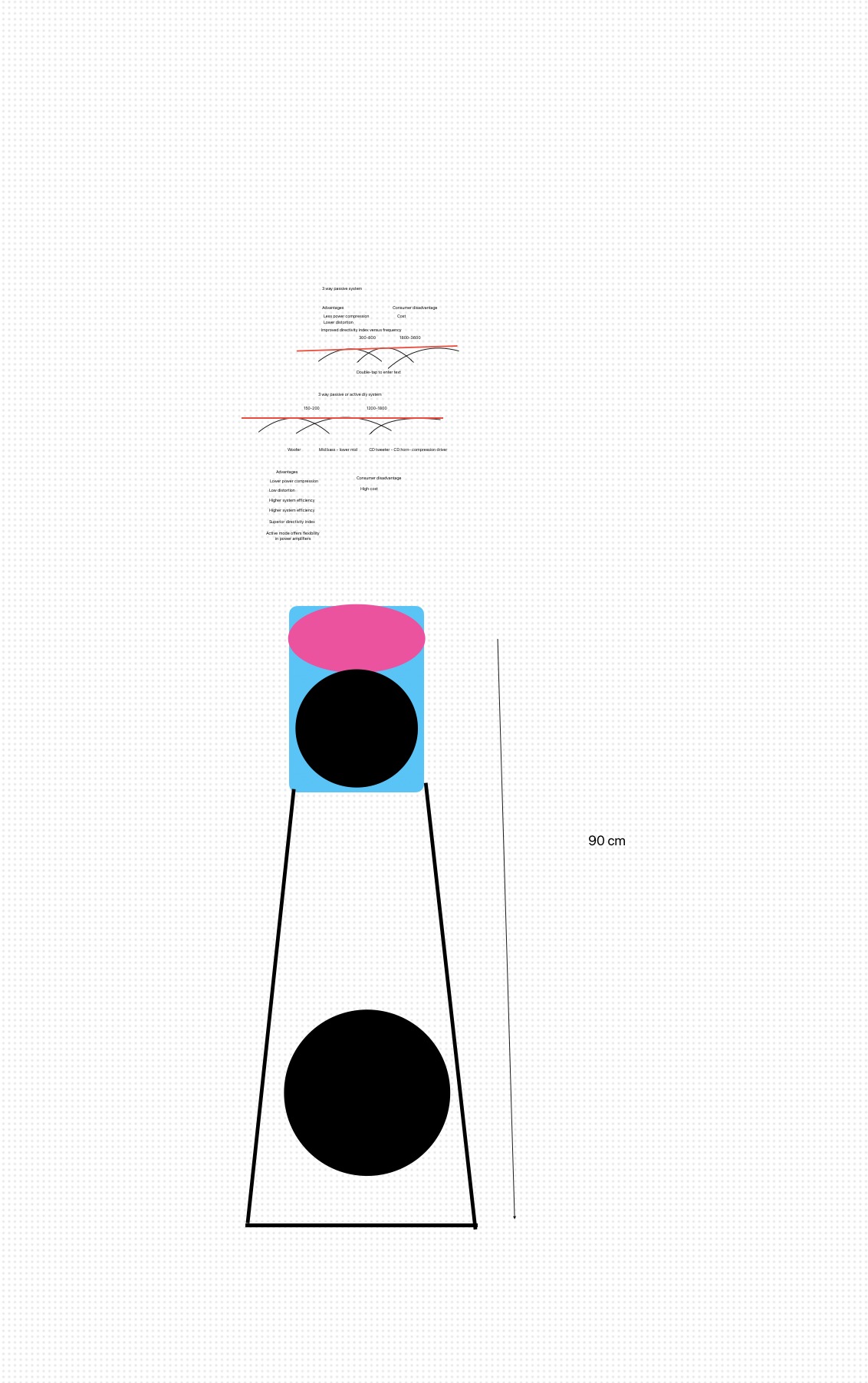

I have been pondering if diy loudspeaker builders are making the task too expensive and overly complicated by try to complete with popular consumer flagship or up market multi way systems?
Such consumer systems have to fit into a rigid framework of it must be passive, have to be of certain physical dimensions, have certain aesthetics and appeal to a particular buyer.
What if we diyers said no way and we took a purely objective approach to solving the acoustic challenges?
This makes me look at some interesting alternatives to expensive hifi drivers.
For example system with pro 10 inch mid bass driver in a bass reflex with an f3 of 70 hertz. Sensitivity 95 db. A high quality wave guide from Audiohorn and a high quality compression driver BMS or 18Sound. The woofer is a separate passive or active module under the mid bass - horn which is designed for low diffraction.
The whole thing not complicated, it uses reasonably priced drivers and delivers big bang on all metrics. Like a mini M2.
To my way of thinking being shoe horned into a sub 90 db sensitivity system using expensive $$$ hifi drivers is a no win situation against consumer systems. The amplifiers have to be big and everything gets expensive.
But if you can use your diy Aleph or your own diy amp then your sailing your own voyage into audio heaven!

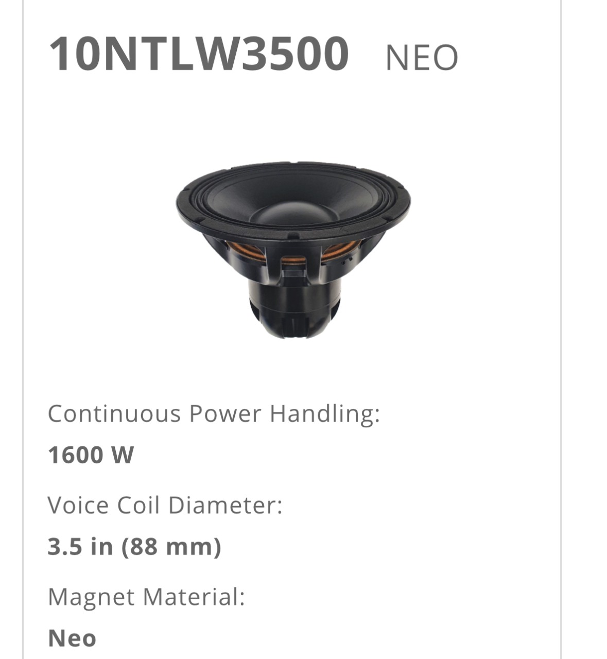

I think you are looking further than l was.
My context was the notion of buying a bunch of scan speak drivers and plugging them into the latest wiz bang simulators. All those diy two way and three way bookend systems are trapped within the same constraint’s.
l see hi end consumer bookshelf models based on this notion for up to $30,000. They use marketing with tantalum coated woofer diaphragms to justify the prices. What is a con job!
Those hi fi drivers in the 90 db category will not deliver the dynamic contrast or the harmonic expression that can create true realism of the original recorded event. So instead they deliberately offer you a loudspeaker with its own personality.
The reviewer is paid with twelve months of advertising to give the holy grail review.
This is unless you want to listen at one metre like a nearfield monitor with 85 db level.
At 3 metres it will be 75 db level.
So you increase the power input X 10 for 85 db. You want 10 db peaks to 95 db that is X 100 the power of the 75 db level.
At this point the woofer 39mm VC is 350 degrees C and your tweeter is flatlined dynamically with the acoustic impedance of such a small surface area of the diaphragm.
Enter the high performance FEA wave guide with a high performance compression driver.
A pro dual gap mid bass driver with 95-96 db only needs a 1/4 of the power or less input for the same level. The trade off of increased efficiency is reduced LF bandwidth which can be covered by a dedicated woofer if required.
Dual gap bass drivers have vastly superior motor structures which translates into harmonic expression and real dynamic contrast.
https://www.eighteensound.it/en/products/lf-driver/12-0/8/12NTLW2500.pdf
https://www.eighteensound.it/en/products/lf-driver/10-0/8/10ntlw3500-8ohm.pdf
Game over man. Game over.

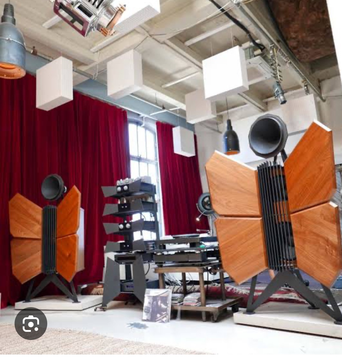

I think one of the impractical aspects of these hi end or more realistic systems is the size of them and the size of the room they are typically demonstrated in.
The equipment alone will fill half the floor space of some residential home living rooms. But in a large show room this isn’t nearly that obvious.
So unless you have a large expansive listening room to house a large system owning or building those systems is sheer fantasy or lunacy.
At one point l was set on cloning the OMA Monarchs only to realise in the end that they were massive loudspeakers measuring about 6 feet in height, 3 feet deep & 4 feet wide.
I did however model the Monarch in Hornresp. With dual 15” woofers they have a healthy in room response extending from -3 db @ 30 hertz with a sensitivity of 104 db 1 watt @ 1 metre. A tuned throat chamber creates a low pass filter @ 900 hertz making an electrical low pass filter on the woofers unnecessary. The horn wings load the woofers down to 65 hertz. Below that room placement and boundary low frequency reinforcement provides low frequency extension according to Hornresp.
I imagine they would pair well with a valve SET amplifier.
A brilliant design by the late Bill Woods.
