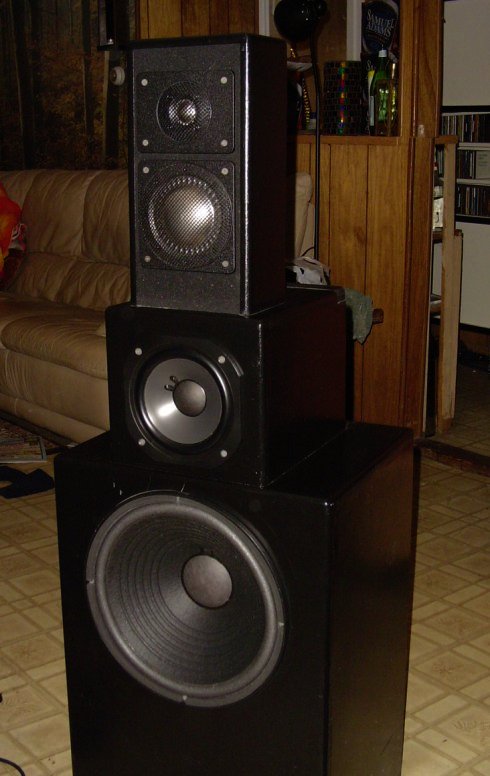

While l contend l don’t generally aim at furniture grade finishes to my diy loudspeakers l don’t believe it’s difficult to obtain a worthy outcome with patience, perseverance and an understanding of how to use your tools correctly.
Agreed you can get some fairly decent out comes if you take your time and are patient. Just a couple of coats black of paint over MDF. Or vernier if you decide.
Rob 🙂

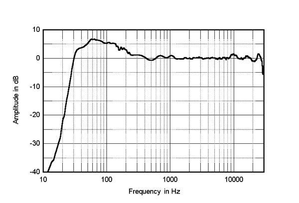

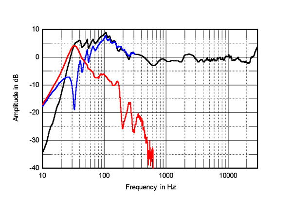

Here's the frequency response of the Tekton and the Kef, in that order. Although both have exaggerated bass, the Kef is much flatter in the frequencies where non-linearity is most audible. The Kef is also extremely easy to equalize because it's response is so smooth.

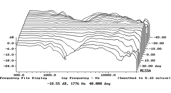

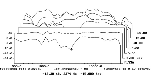

Tekton vertical polars courtesy of Stereophile

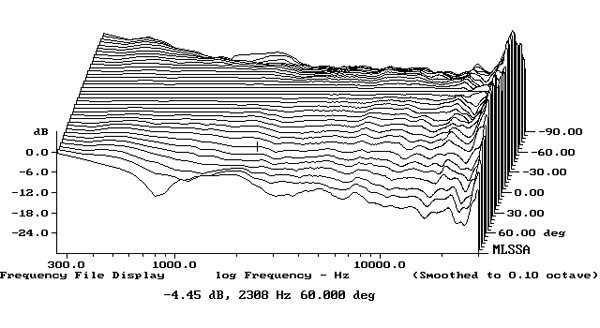

Kef vertical polars courtesy of Stereophile

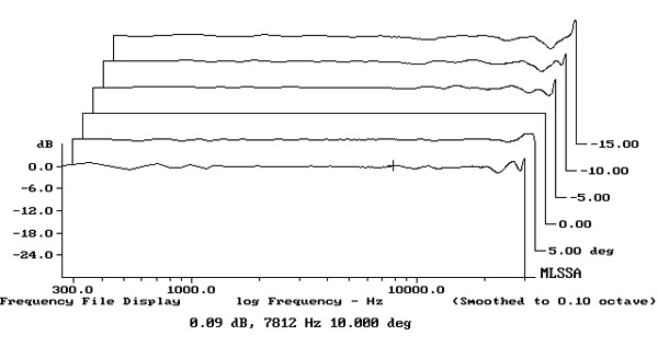

Tekton horizontal polars courtesy of Stereophile

The thing that REALLY blows me away about the Kef, is how absolutely consistent it's polar response is. Ever since Geddes got me into waveguides, I've really found that what tends to make a speaker sound VERY GOOD in a real room is the polar response. For instance, the entire side of my living room is a sliding glass pocket door. My wife REALLY doesn't want any curtains or the like on that, because pocket doors are really trendy right now, and covering them up defeats the purpose. Picture this:
This wouldn't be the first time that I overanalyzed something. But here's my opinion on these two speakers:

A couple of points. The low frequency measurements in stereophile are uncorrected nearfield ones and so the low frequency rise includes the baffle step correction. At a typical listening position the KEF is going to be close to flat excluding room boundary effects whereas the Tekton would have a small bump. Including room boundary effects and whatever is done to control them the differences are likely to be largely irrelevant.
