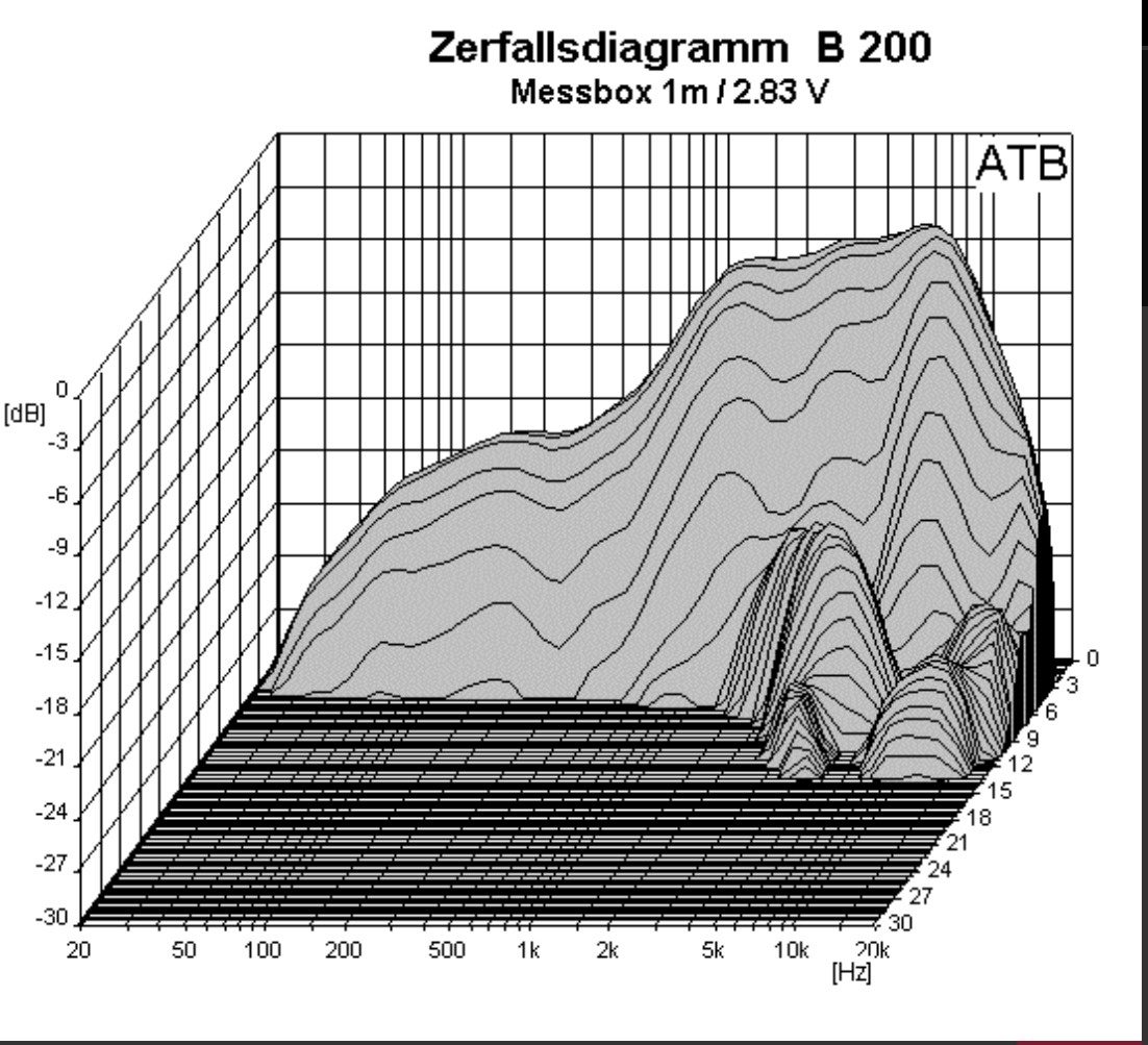

For example the initial diy project for a beginner could be a simple full range driver like this with a sub to fill out the bass.

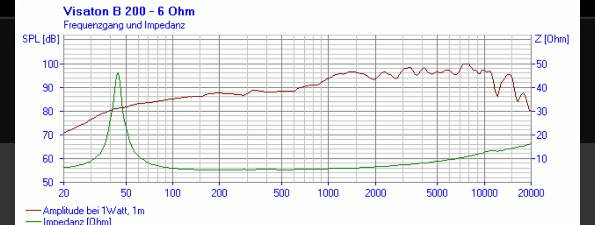

I am using this driver because it illustrates the possibilities in the diy space. Everyone wins with this simple design. It suits small diy amps, it’s straight forward to build and it can be evolved over time.
https://www.visaton.de/sites/default/files/dd_product/B 100_1263.pdf

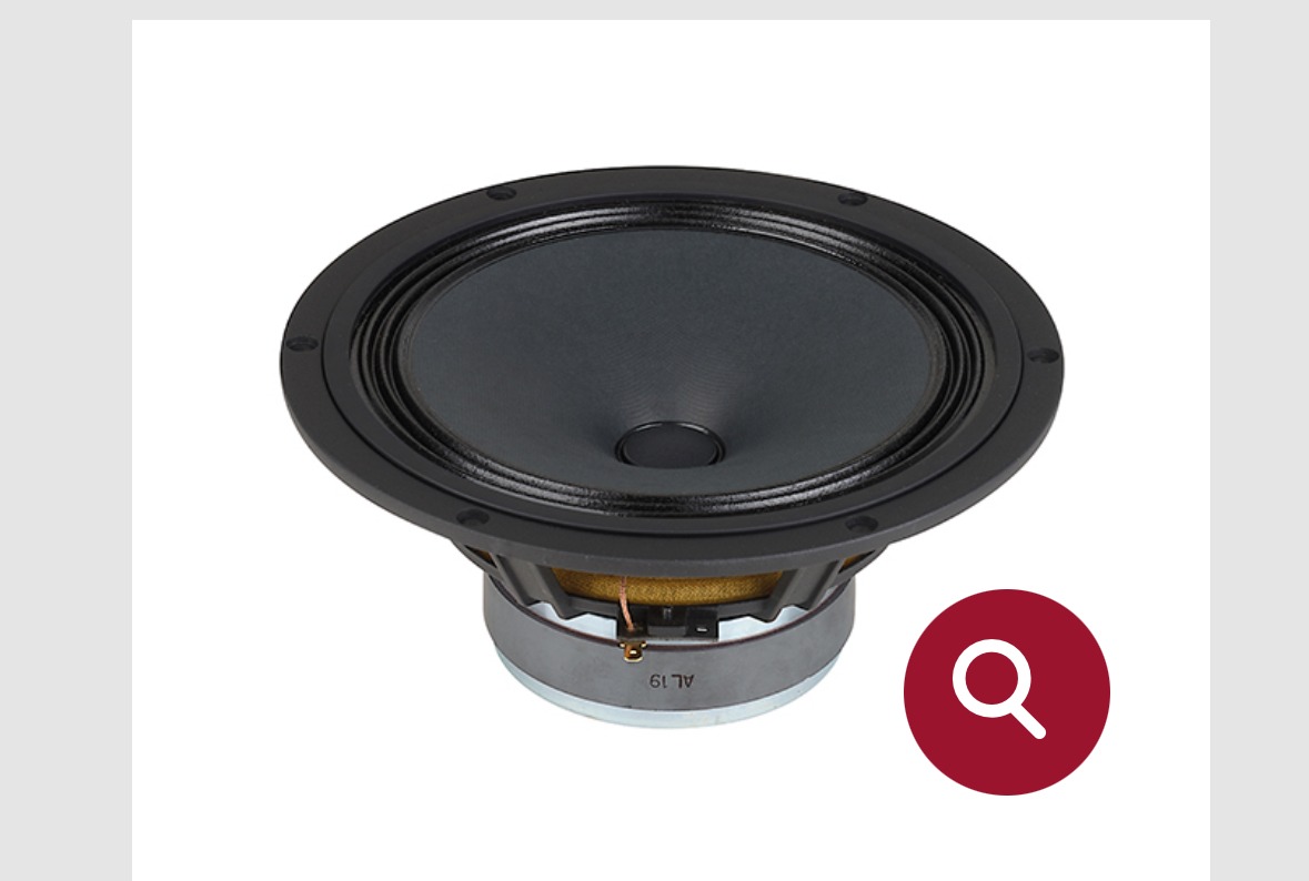

Or a larger 8 inch full range here
https://www.visaton.de/en/products/drivers/fullrange-systems/b-200-6-ohm
All the important information is provided like the recommended enclosure
https://www.visaton.de/en/products/drivers/fullrange-systems/b-100-6-ohm
Then the project could be enhanced with a super tweeter and a woofer so the full range driver becomes a mid range driver.
This way the diy loudspeaker builder gets to experience and understand the fundamental aspects of loudspeaker building such as efficiency, amplitude and impedance, directivity pattern ect.

The answer to the question depends on the level of DIYer and the company you are comparing to.
A lot of DIY efforts I see in forums miss some key techniques
1. Acoustic offset between drivers
2. off-axis measurements fed into the Crossover simulation software
3. wrong crossover points, not respecting the distortion/waterfall graphs of the drivers
