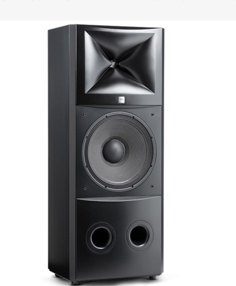

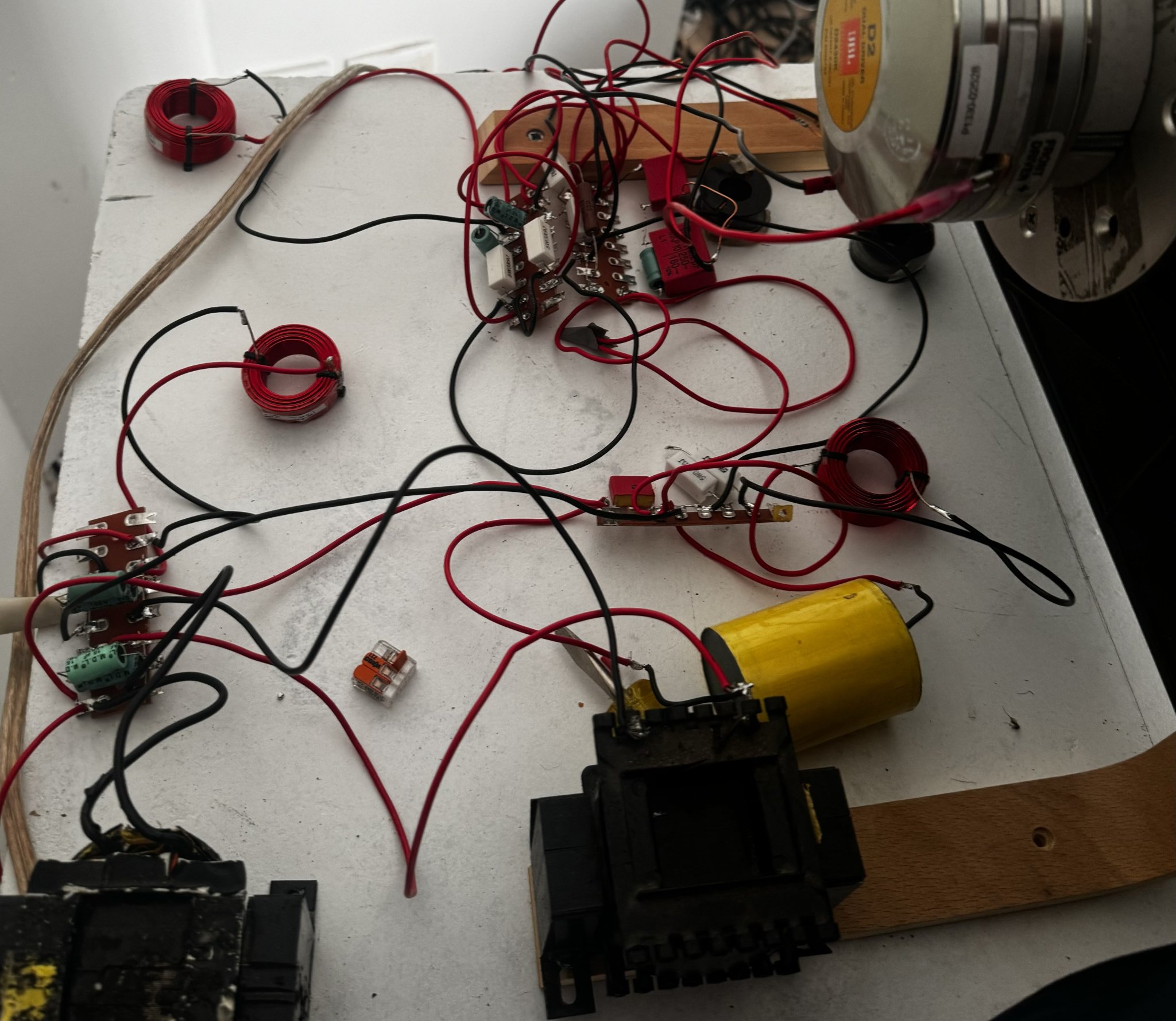

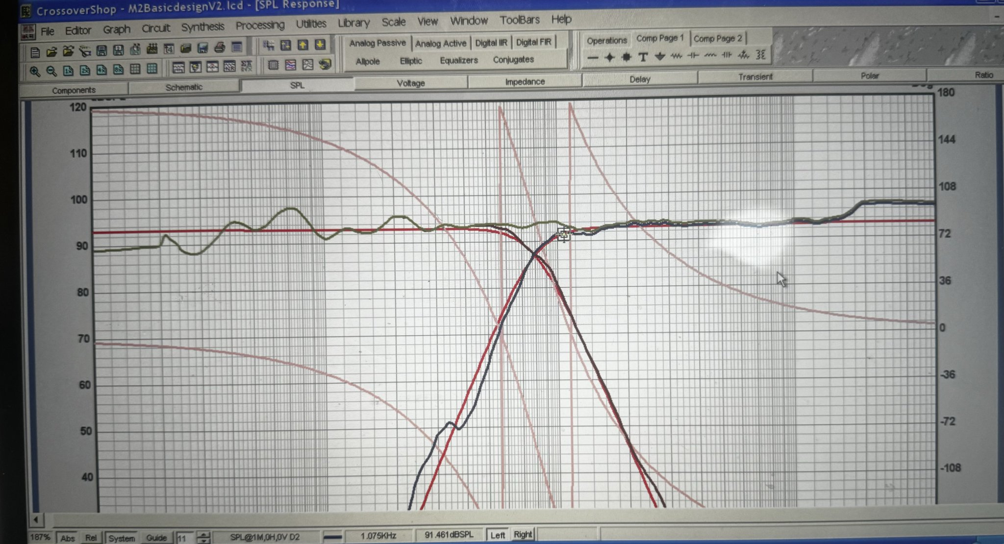

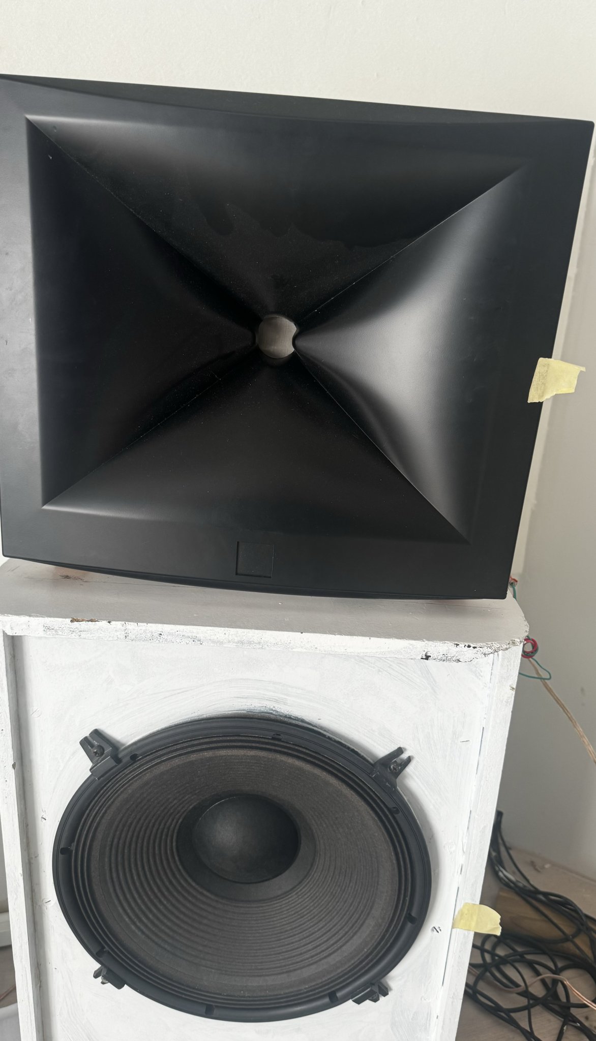

Another possibility is the M2 /D2 horn and driver combo with a 2216nd 15 inch woofer.
If you can get a wood shop to cut the mdf sheet to size for 5 cu ft 3 bass reflex enclosure you have access to essentially a state of art diy system.
* A number of M2 diy monitor clones have been built by diy addicts over the past 8 years using various dsp crossover set ups and with various jbl conventional compression drivers. The exact dsp crossover and EQ specified by JBL is normally only available for use in noisy Crown pro amps or a BSS London Sound dsp network which can also be prone to fan noise. This spoils other otherwise excellent performance of these transducers in a residential domestic living room.
The dsp approach has also proven a time consuming and arduous task to get right for those you aren’t versed in setting up complex pro processors.
To date don’t believe a passive version with the original 6th order crossover and a passive EQ characteristics has been attempted. I have therefore been trialling a passive 6th order 2 way network with passive EQ that l designed with Linear X Leap 5 recently. The low frequency electrical assisted EQ used in JBL M2 monitor isn’t absolutely necessary for consumer hifi use.
See the attached a a pic of the test rig using low cost parts from my parts bin and the indoor driver measurements with the Leap 5 simulation.
Rob has previously built a passive network for his 0476 Mg drivers using the M2 horn and the 2216nd sometime ago.
I think we are in agreement that it’s a very impressive set up.
These systems are in the order of 93 db / 1 watt. Your Aleph would sound wonderful. For the more adventurous a Diyaudio 6/24 active crossover could be deployed.
Performance.
There are numerous reviews of the JBL M2 monitors. I would suggest that for a much easier implementation a passive network does not give too much away.
If there is a single horn and driver combo that covers from 750-20,000 perfectly this it it. What is does is it translates the harmonic overtones and dynamic contrasts of a recording beautifully without introducing any colouration or artefacts. It doesn’t have a sound. What it does do is cast a pin sharp sound stage with a broad sweet spot.
For around US$2300 in components for a stereo pair it’s a high value diy project compared to the MRRP US$280000 of the M2 pro monitors including Crown power amps to make it work. A passive system doesn’t require that palarver of cables and programming a dsp crossover.
The above defies what a diy loudspeaker builder can achieve without a lot complexity, over thinking , worrying or sleepless nights. You turn it on. It goes and it puts a big smile on your face.

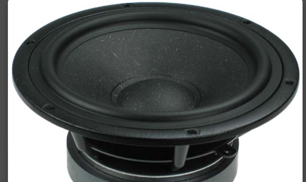

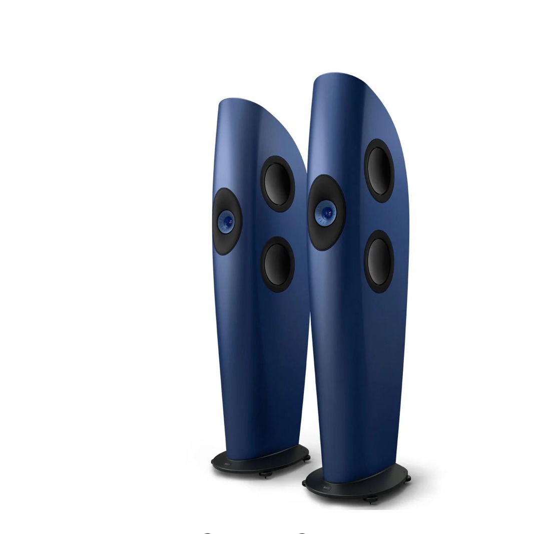

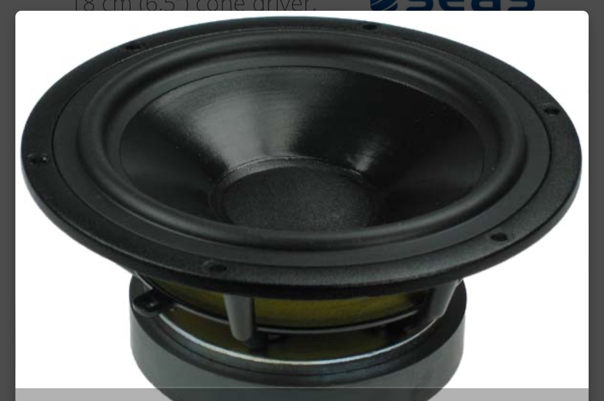

How good are our DIY units compared to off the shelf stuff?

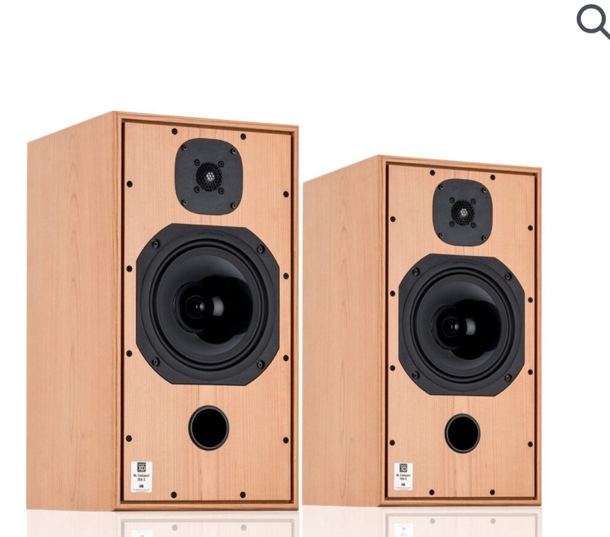

Post 304 outlined the benefits of opting for a pre determined diy loudspeaker design (multi way), a single full range driver design or cloning and existing consumer loudspeaker.
The advantage with these options is that you know at the outset “what” it is you’re going to build and what it will do? You also know that it works, it’s been tested and it’s likely been reviewed. This closes the loop on the above question.
In layman’s terms it’s easy to assume that by using best in class or expensive hifi drivers that the diy build is going to be better than an equivalent consumer version. Or the diy enclosure might be better. But is this actually the case? Is there a ceiling upon what a given design can achieve in terms of objective and subjective performance?
Are we splitting hairs like a long winded Stereophile or Absolute Sound Review?
In my opinion there are limits and there are diminishing returns. We are also competing with the laws of physics which mother nature isn’t going to let us break.

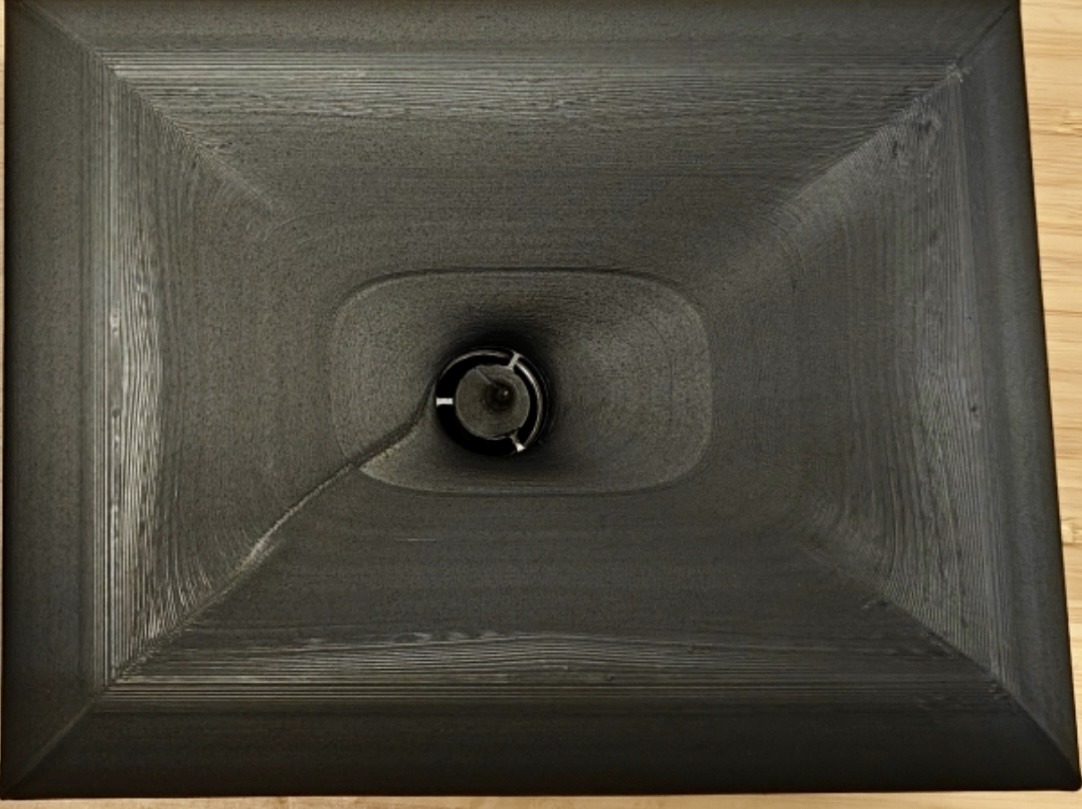

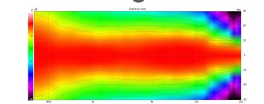

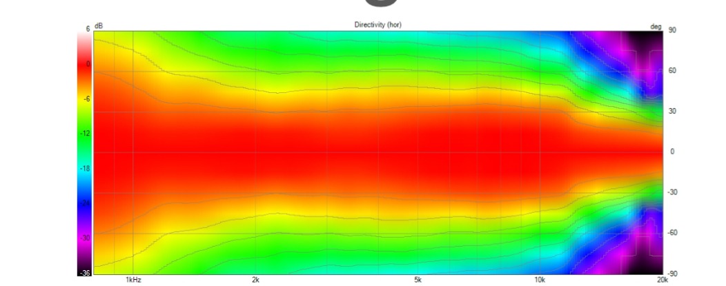

This brings us to the endless debate of what makes a better loudspeaker? If we were to all to agree it might be bigger and more expensive to build than we care to consider.
The M2 diy clone comes to mind. It seemingly breaks free of the limitations placed on most hifi loudspeakers. It trades the tonal flavours of competing lower efficiency hifi drivers using Magnesium, Nextal, Graphene, Metamodal TPCD, carbon fibre or paper pulp cones for perfectly reproduced harmonic overtones and true realism in dynamic contrasts.
The compromise is size and cost. We then consider alternatives we can afford and live with.
The diy builder can opt for his own original HiFi loudspeaker design or what he believes is going to be better than an equivalent consumer loudspeaker. But, as outlined in a number of posts this assumes a lot of caveats or hurdles in favour of a diy loudspeaker builder versus the consumer manufactured loudspeaker.
Then there are the challenges of determining if the diy loudspeaker is superior to a consumer model? Should this be an objective determination or a subjective determination or both?
Given the disparity between what consumers believe subjectively about an individual consumer loudspeakers we may never definitively come up with a yes or a no answer.

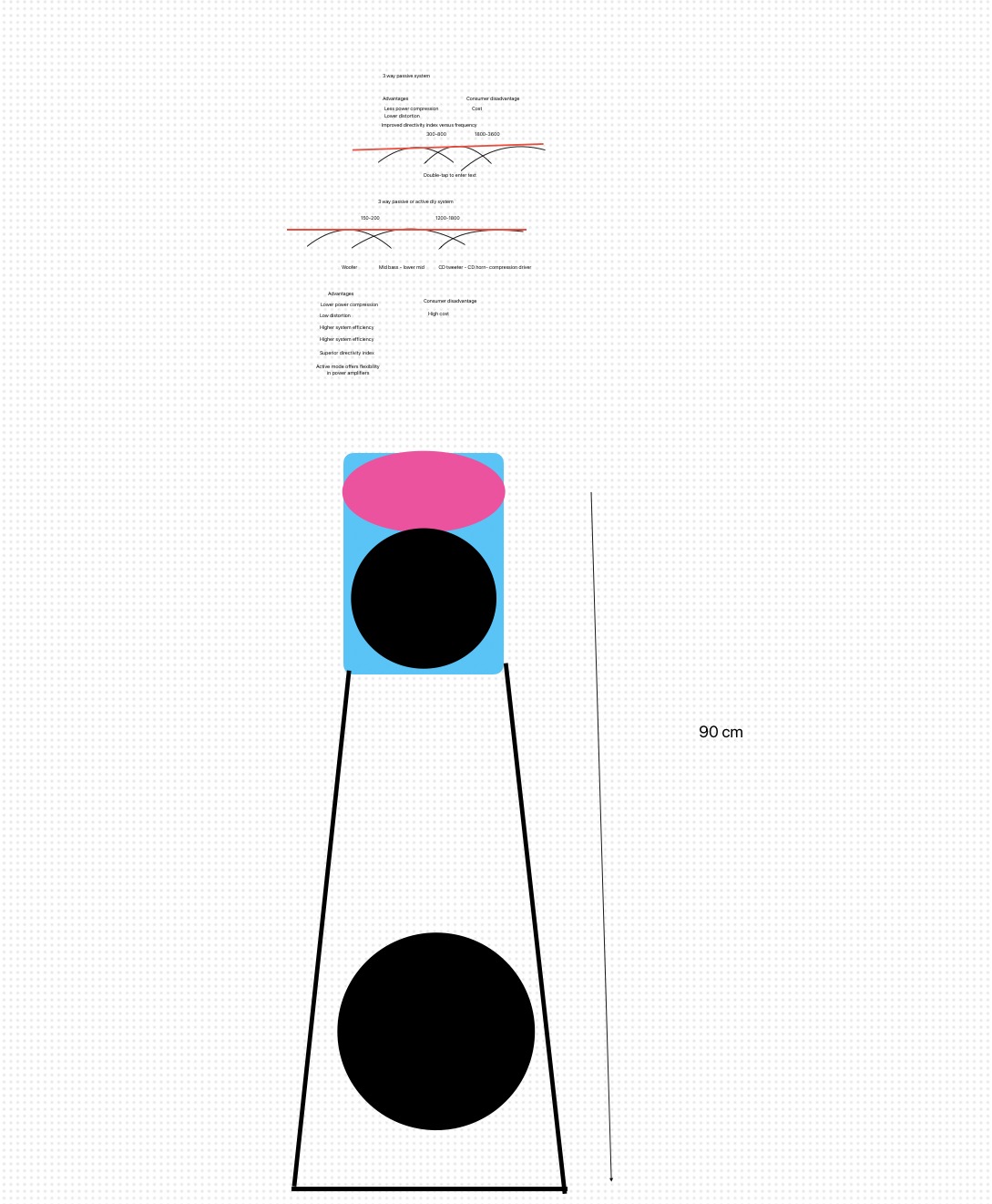

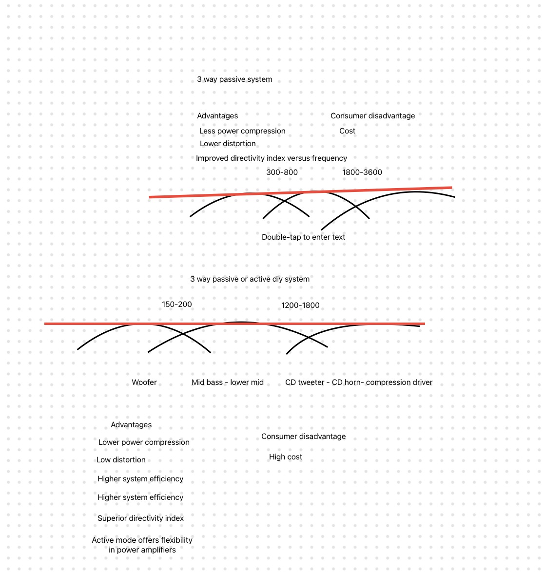

The challenge to my mind is coming up with diy focused design that is going to leverage a distinct advantage over a consumer system at a significantly lower cost.
If we look at the objective criteria let’s put together a simple but achievable concept to flesh out. :
Objective Criteria
Lower power compression
Lower distortion
Improved directivity index versus frequency (include diffraction)
Higher efficiency (improved dynamic contrast)
There are a number of ways to achieve this. To keep simple for a diy implement l have illustrated two scenarios in the graphic attached. I have chosen a two way design template because l feel there are too many constraints in a two way system with the commercial consumer market is saturated with.
The trick is to balance the trade offs do as not to not impact on the benefits.
The primary trade off is complexity and picking benign crossover points. This however can be dealt with using a simple but elegant design.
Key design features
Placement of the woofer crossover at 150-200 hertz allows a more focused execution of the woofer driver and enclosure loading.
This frequency placement ensures the whole mid bass - lower midrange is handled by a single driver optimised for this pass band.
The use of a wave guide with a tweeter at an optimal crossover frequency ensures a smooth directivity index. Alternatively a specifically designed wave guide and a compression driver where higher system efficiency is desired.
This design can be scaled from compact to large depending on space and the budget.
It’s particularly well suited to a diy implementation because it leverages the advantages of low compromise objective design choices that would be expensive in a consumer offering.
The nearest thing to the above is the JBL 708 (without a sub)
https://jblpro.com/en/products/708p
MRRP US$1,999 each

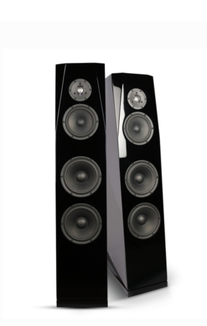

Hopefully he doesn't sue me, but the thing I noticed with "audiophile" brands like Tekton is that the speakers often seem to be little more than glorified DIY projects. From everything I can see, it's basically an MDF box with off-the-shelf drivers.
This would be perfectly fine if the performance was competitive with Kef / Infinity / JBL / Revel / etc.
But the measurements don't seem to indicate that, and I imagine that's part of the reason that the company went Scorched Earth on Erin.
"The Emperor has no clothes" and all that.
