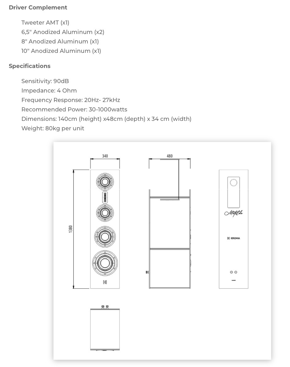

Real-Life Example: High-End Speakers with Off-the-Shelf Drivers
Comparison Model:
Kroma Atelier Mathilde
MSRP $67,500 USD per pair...
Lets break it down from a DIY perspective.
1. Driver Configuration:
- MTM Configuration with Purifi PTT6.5M04-NAA-07 ($500) X 2 + Purifi tweeter ($500)
- PTT8.0X04-NAB-02 ($750)
- PTT10.0X04-NAB-02 ($1,000)
Total for Pair: $7,000 USD
