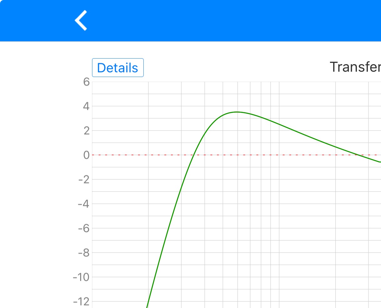

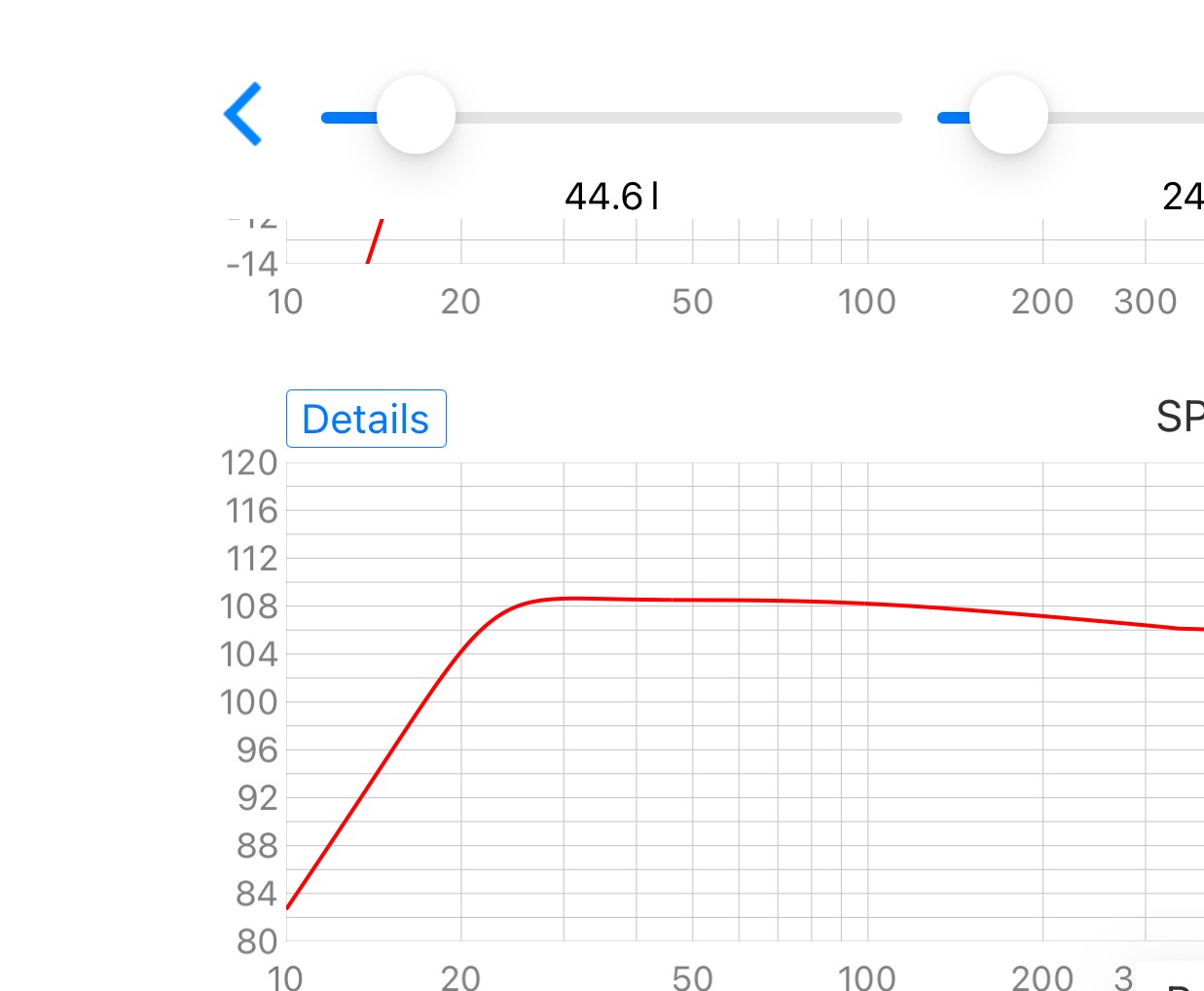

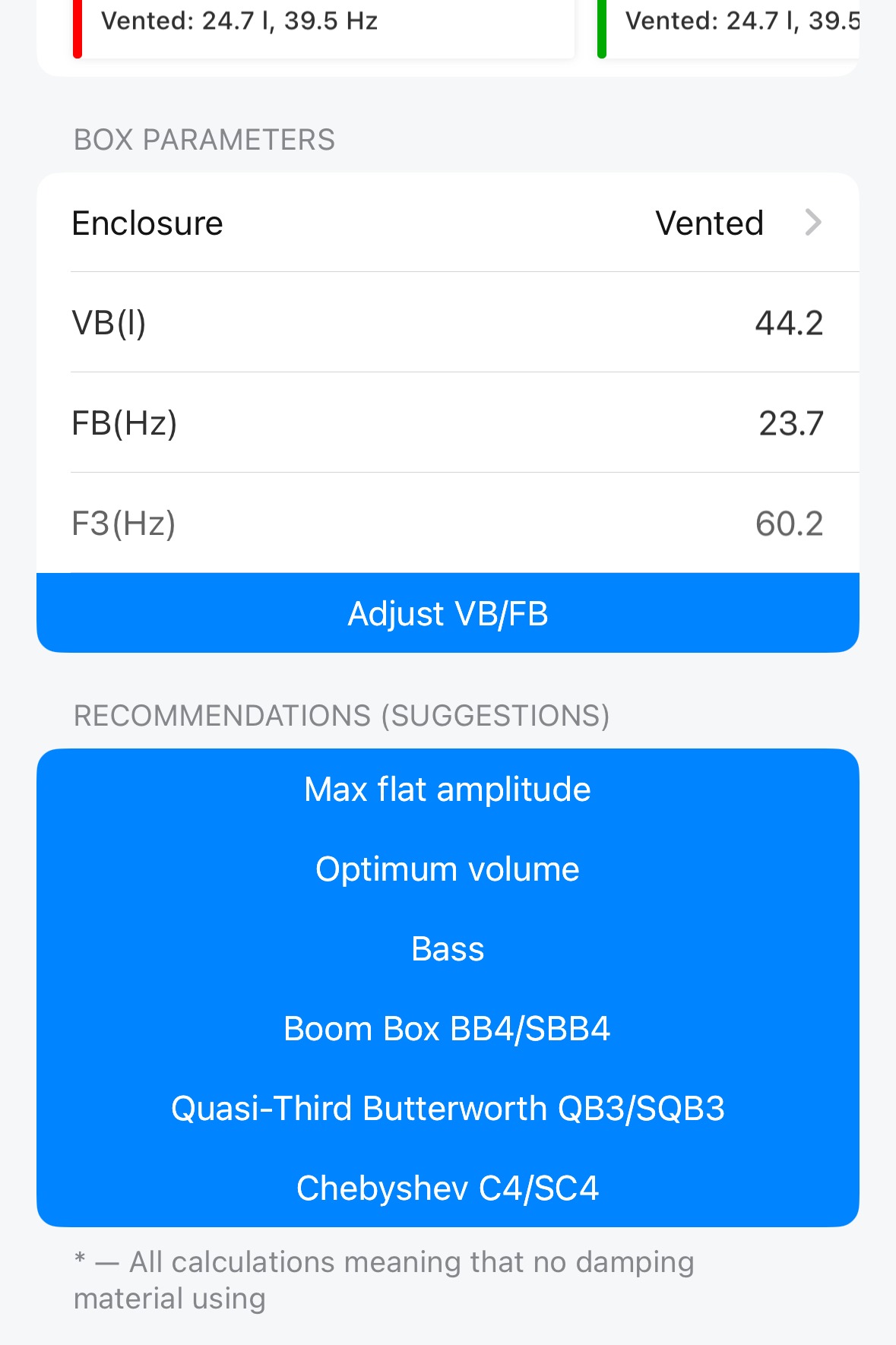

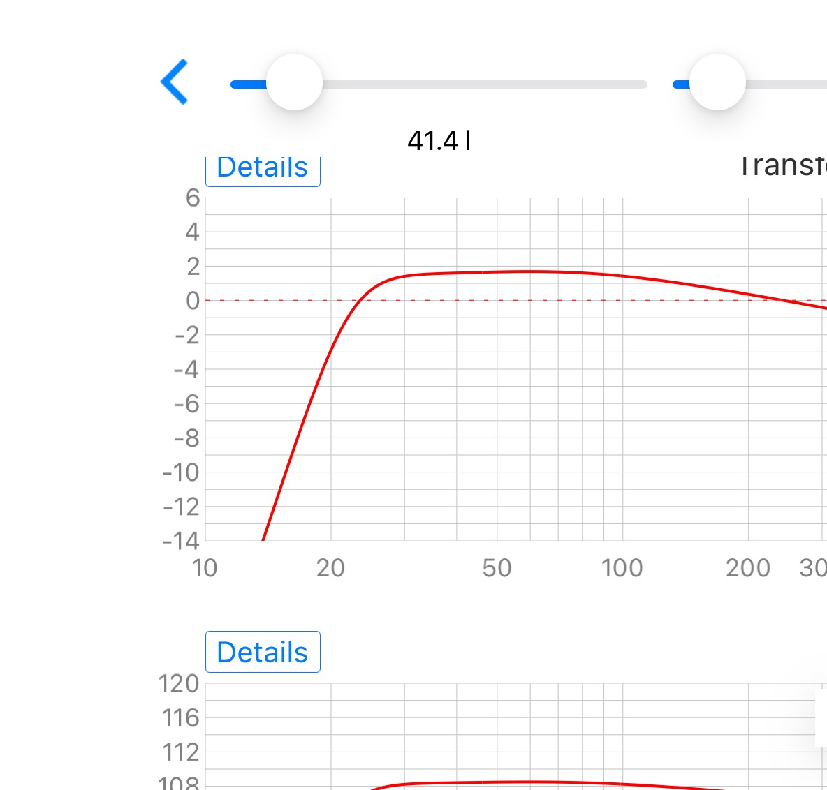

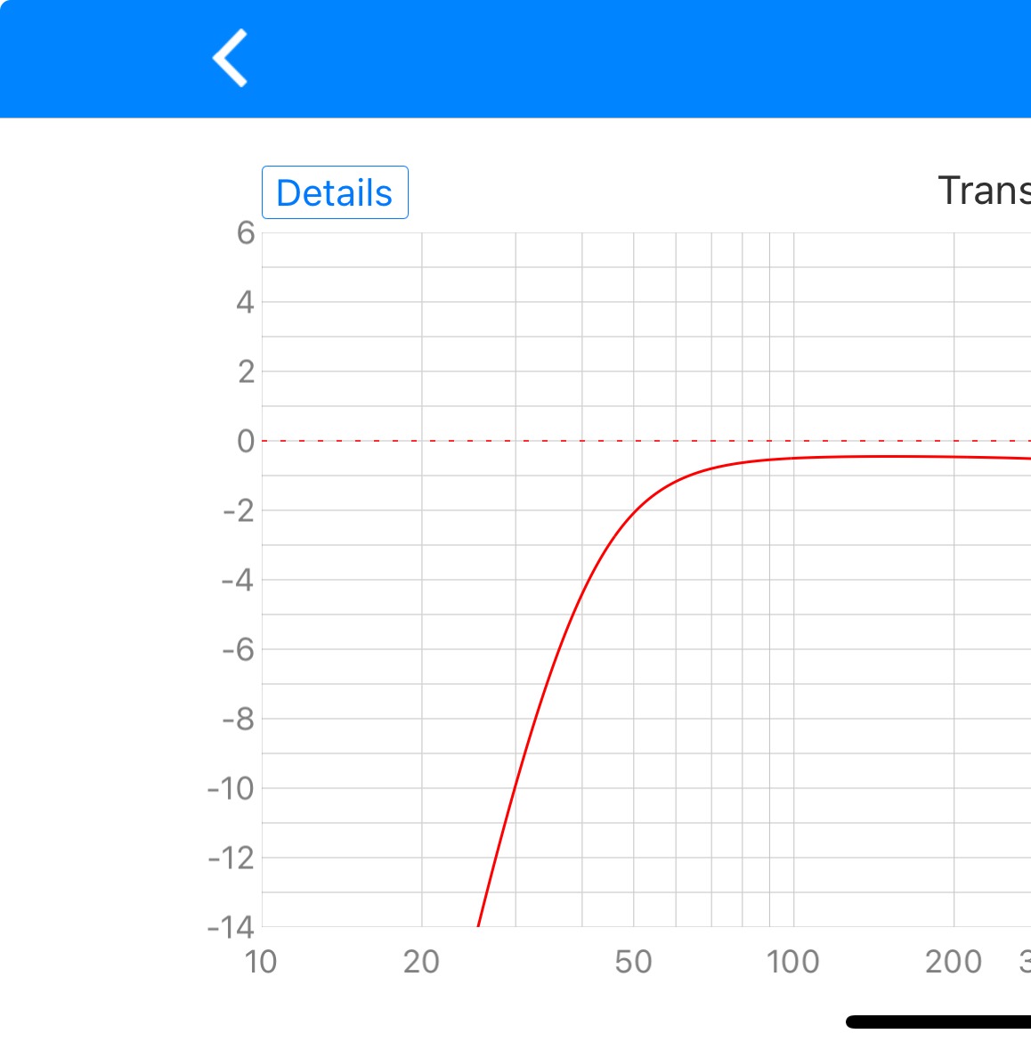

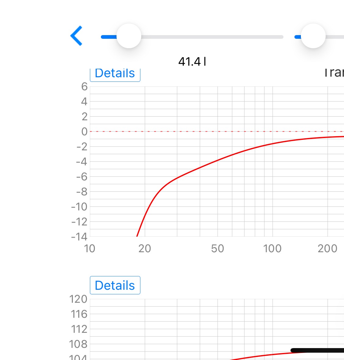

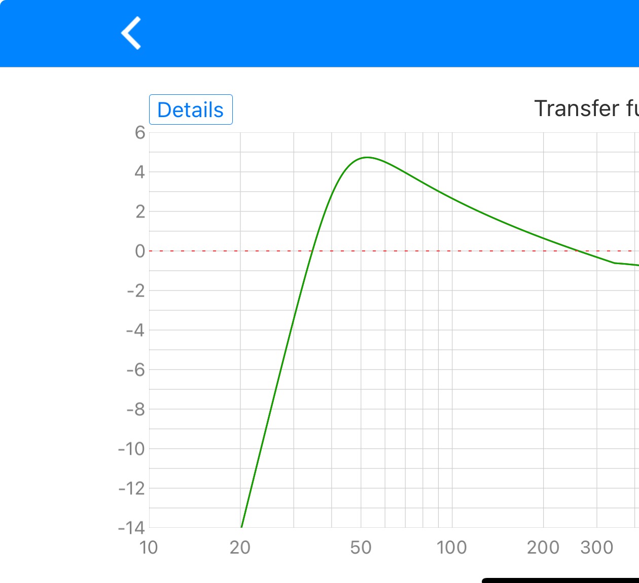

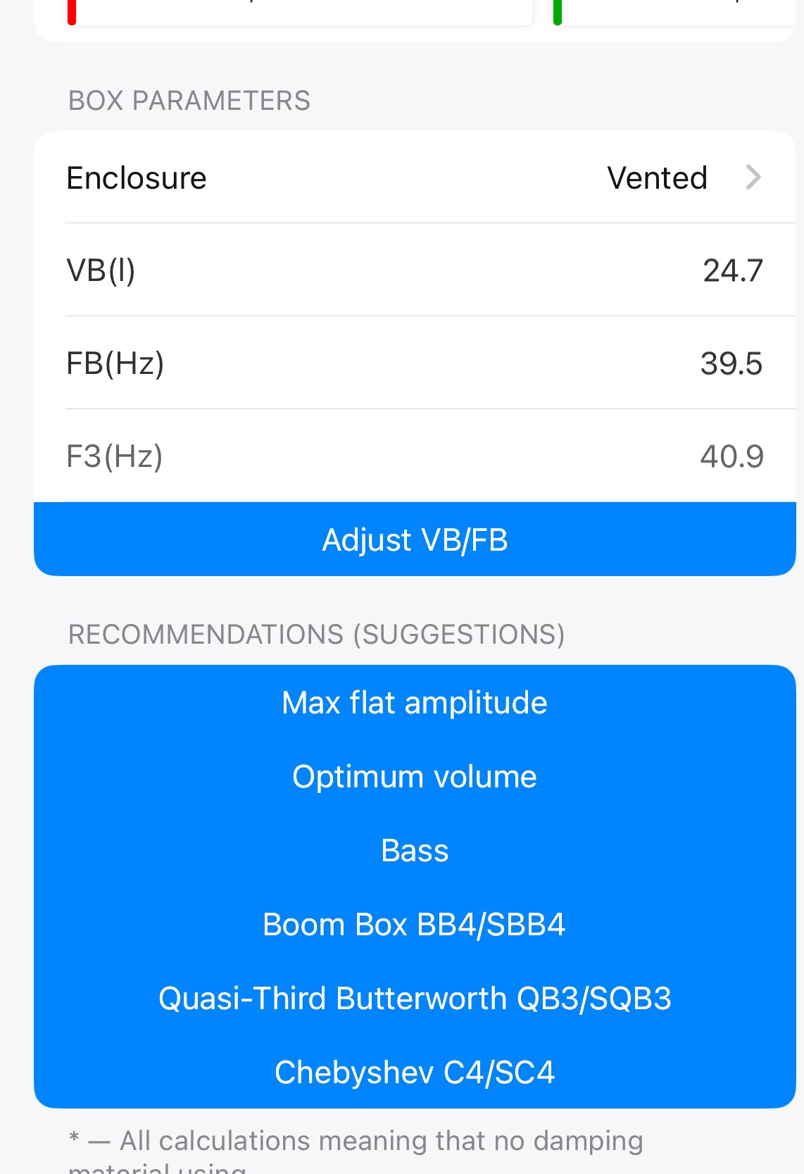

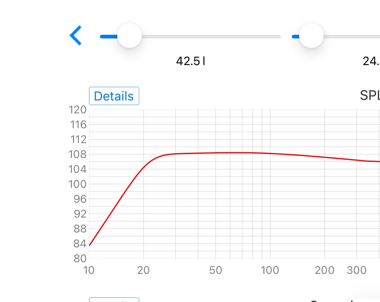

The other jewel in the diy tool box is REW which can tell you quite accurately how a loudspeaker woofer location will behave in a room.
These tools allow some baseline assumptions that can then be incorporated into modelling - simulation programs.
My point is often what you see on a simulation is not what you get in the room unless it’s accounted for.
I have attached a simple bass reflex simulation comparing a free space low frequency response with the effect of a room boundary using a 3 db low frequency shelf EQ 100 hertz.
By modifying the enclosure size and tuning frequency of the port a more acceptable low frequency response can be simulated.
This is the sort of experimentation that a diy builder need to invest in. Don’t let driver ego overshadow your success.
Unfortunately some diy builders then resort to a sealed enclosure on the basis that it must have tighter base without further investigation

Below l have re posted the two different bas reflex tuning scenarios
A Satori MW 19P-8
Free field versus in room boundary effects using a 3 db shelf filter at 100 hertz
From top to bottom attachments
Maximally flat alignment 21 L Fb 35 hertz
Effect of room boundary
Custom alignment over damped 44L Fb 24 hertz
Of course if the diy builder understands this he can always EQ the low frequency response. But this requires in room measurement with REW or room correction like Dirac.
I think it’s more appropriate to understand these phenomena and design around it to produce a a better end result. It’s important to still test all assumptions as all rooms and loudspeaker placements are different. That said the room simulator in REW is quite accurate in predicting the low frequency response at the listening position based on the specific location of the woofer x,y, z co ordinates.

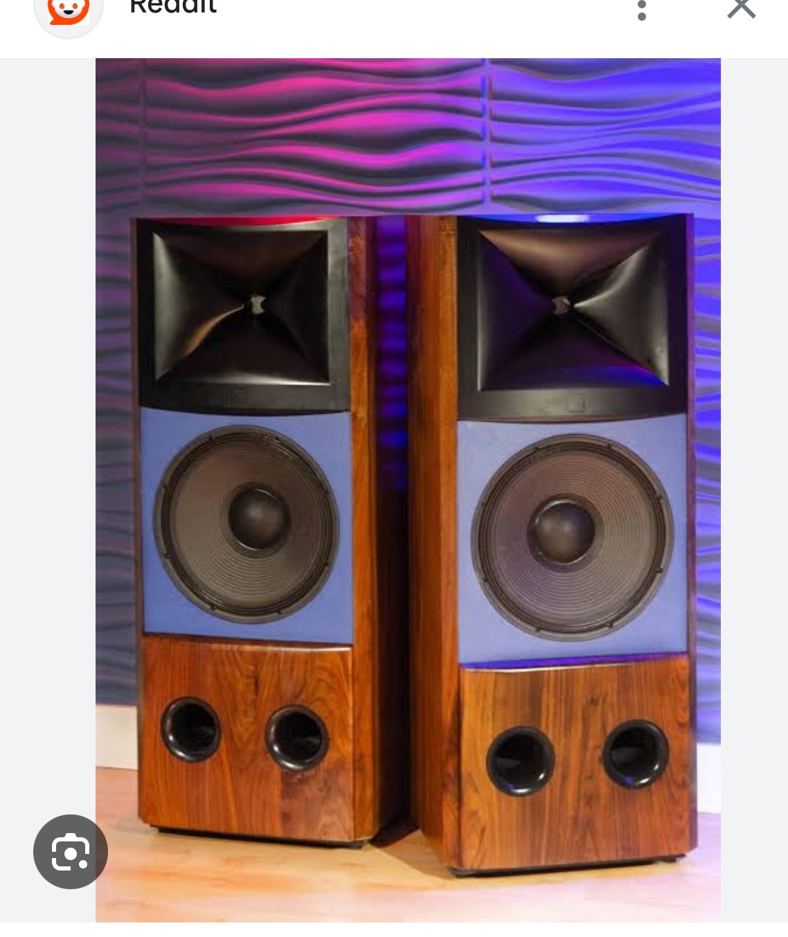

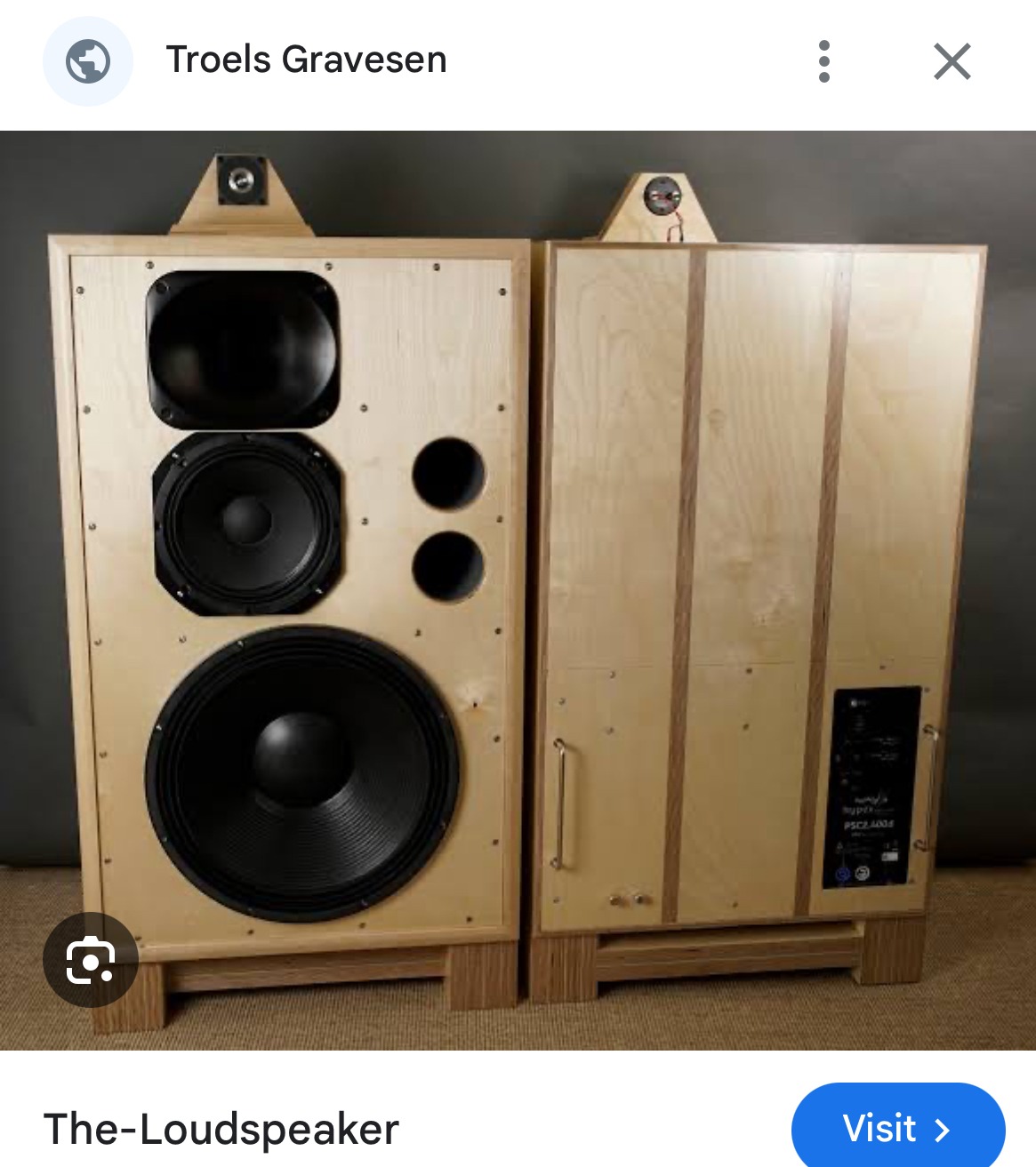

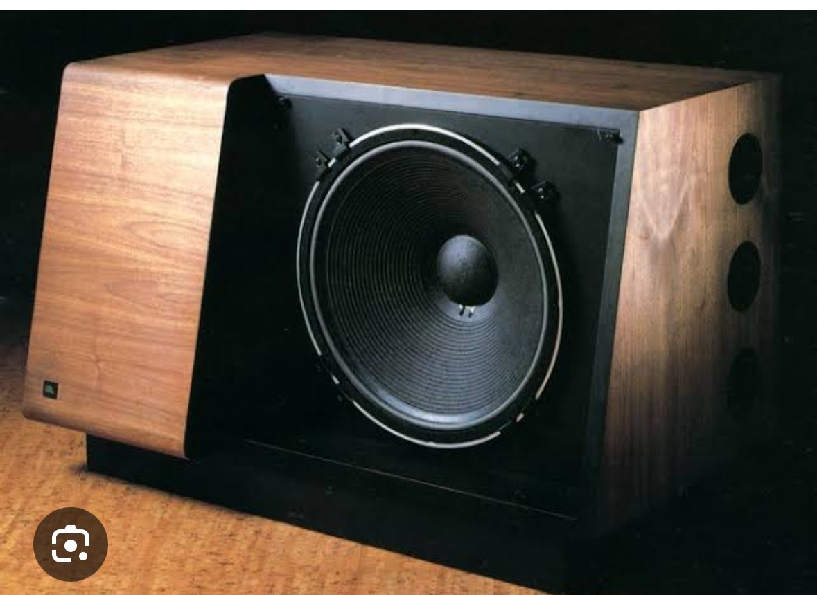

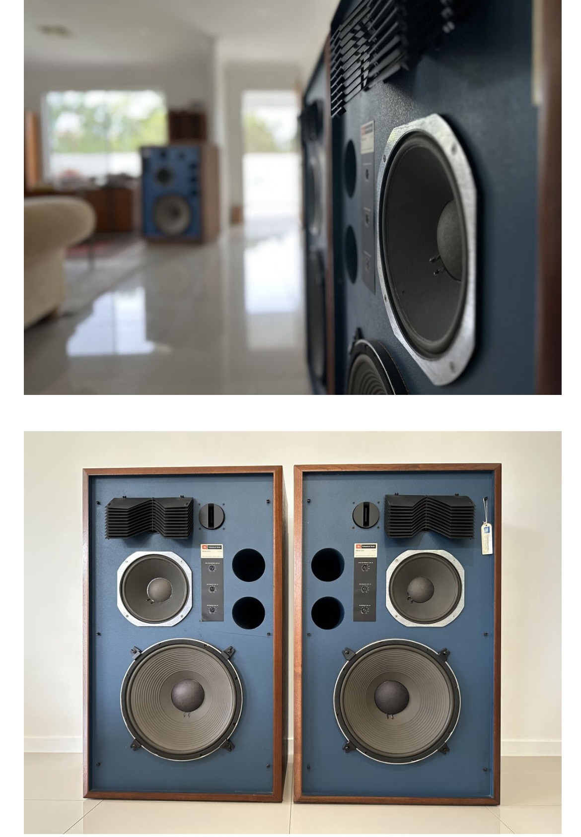

Hi prodigy,
I hear you.
You can clone these Jbl systems from parts available on the used market or from after sales replacement parts (M2 clone)
I have personally been involved in supporting the build of dozens of JBL 4344 clones all over from Croatia, Berlin, London, Sydney, India, Thailand, LA, Montreal. Not one dissatisfied diy builder. The Pass active crossover is used to bi amp these systems giving massive dynamic headroom. The M2 Clone commands even more headroom.
Troels was inspired by the 4344 so he designed a version using modern pro drivers. He said at the time it was his best project. He called it The Loudspeaker One.
They aren’t for everyone but once you experience them there is no going back.
Subjectively it’s being there, complete immersion.
This is a premium diy loudspeaker project.
The four way system is complex to implement but with some support builders make it through with a smile on their faces. I built the 18 inch woofer version. It uses the JBL2245H woofer. It was designed by Greg Timbers for the L250 subwoofer called the B460 back in the 1980’s. It’s in a league of its own for music playback.
http://www.troelsgravesen.dk/The-Loudspeaker.htm
Either of these systems will fulfill realistic recording levels.
To be honest nothing even comes close.
