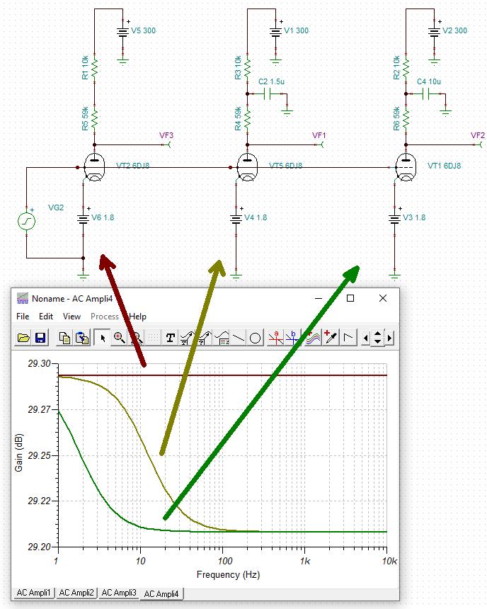

It would be very helpful to myself, FlaCharlie, and probably many others if you could please explain how the capacitor size affects frequency response. As noted by myself and FlaCharlie, there is no obvious audible change to frequency response when the size of the driver tube’s power supply node capacitor is drastically changed.
Have a look at a simple gain stage. I have deliberately drawn it so the PSU dropping resistors (R1 / R2 / R3) are 'vertical' to make it obvious that, from the point of view of the triode, they are really part of the anode load resistor.
In the first case there is no PSU bypass cap, so the triode sees a load of 56k+10k = 66k and acheives a flat gain.
In the second case a 1.5uF bypass cap is used. At very low frequencies the cap looks like an open circuit, so the gain is as before. But at high frequencies the cap looks like a short circuit (it 'bypasses'), so the triode sees a load of 56k, so the gain is less. In between is a transition -creating a sort of bass boost. Usually we want this boost to be outside the audible range, or at least small within the audible range.
Making the cap much larger, as in the third case, pushes the boost down lower, so the gain stays flat from 20Hz upwards.
The amount of boost may be small, which is why you may not be able to hear any difference. In this example I threw together it is not even 0.1dB! But hopefully you understand the mechanics. There will be other situations where the frequency response deviation could be larger, esp when coupling transformers get involved. And remember, the power supply is not really a battery as in this ideal example, but a whole series of other filters 'upstream'! You can also play tricks with the cathode bypass cap, to cancel out any boost, but this is just a forum post. It's why people write whole books on these subjects.
Thank you!

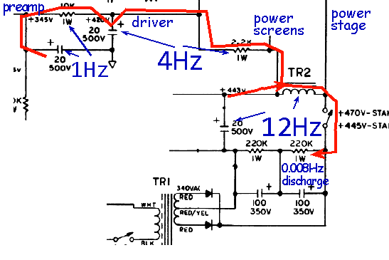

Well, let's see what an utterly practical man might do. This is a Fender amplifier. Leo was an accountant who fixed radios and built a few instrument amplifiers. Work-out the time constants for the several stages of power supply.
