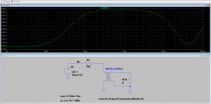

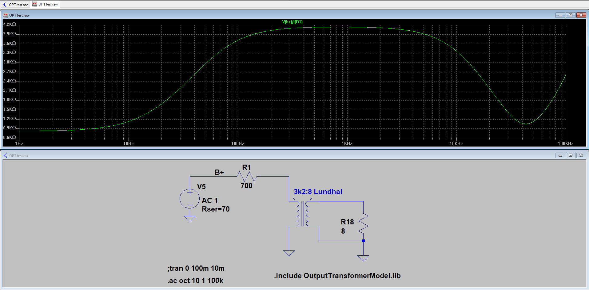

Very interesting. One of these days, I'll figure out spice. Thanks for modeling it. That's actually one of the RC filters in my power amp PSU. I'm actually surprised there's that much ripple but I have extra stages of filtering in mine and it's push pull so we have a good CMRR from the OPT. I should measure the ripple I actually have from ground to plate.

Hmmm... it's only true, if the 300B is working in "tube tester".
If it's a real amplifier, the reflected load act as anode load impedance, so it's part of examined equipment.
