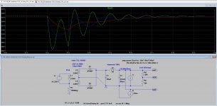

PRR: Fair enough. To recap, I am asking about sizing the capacitor that is in the power supply node feeding a power tube or driver tube. My requirements are for a frequency response of 20 to 20000 Hz -3DB. I already mentioned that ripple isn't what I'm asking about. Is that what you mean by "define your requirements"? If not, please let me know what you mean.

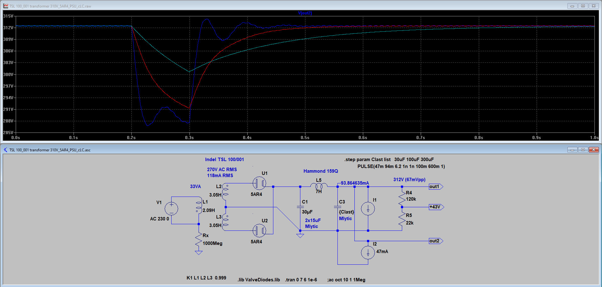

This sample shows the -almost- inadequate, the acceptable alternative and the -almost- exaggerated values of the (#45) SE amp's PSU last C value.
The load is 100msec pulse (0.2s-0.3s) of jump of current from steady value (47mA) to maximum value (94mA).
The acceptable recovery time response is return of B+ to 90% of steady value.
Seems "low" value (blue) producing swinging, the discharge is fast, the charging is begins during the "load", then at expiry begins some oscillation. The sag is significant.
The "acceptable" (red) shows balanced recharge/charge curve. The recovery time meets expectations, about 200msec. The sag is lower than previously, but not negligible.
The "exaggerated" (light blue) sag is better, but the recovery time is much larger.
You have to decide which alternative is better for given design, and better for you (listening).
No general "panacea".

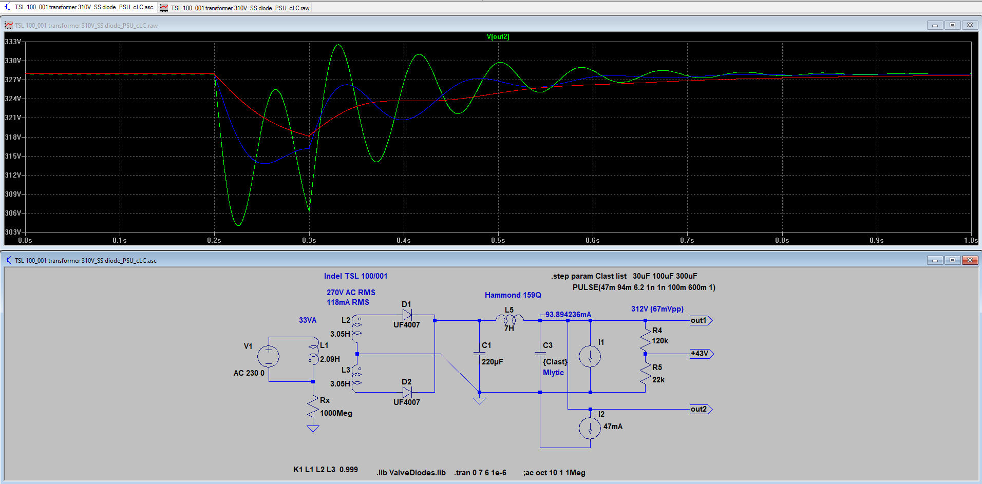

Feel like doing that sim with SS diodes instead? First cap 220uF?
With small (30uF, 100uF) last capacitor it seems horrible.
300uF and above would be better ... with -at least- double recovery time.
BTW SS diode rectification requires different values (mainly choke), than tube rectification.

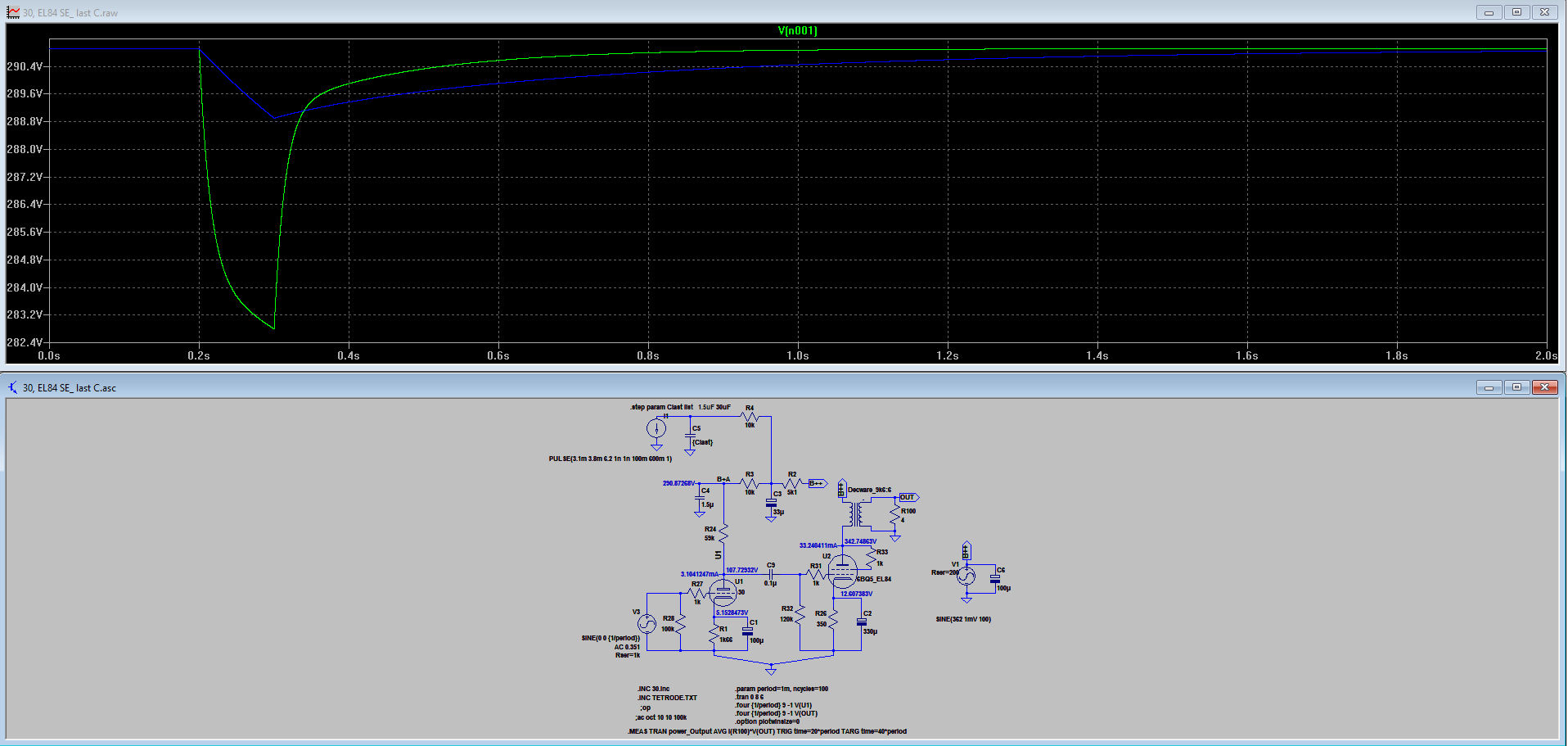

But you're not modelling the OP's actual circuit, so your images are misleading.With small (30uF, 100uF) last capacitor it seems horrible.
"But you're not modelling the OP's actual circuit, so your images are misleading. "
The original question was the last C value in #30 tube PSU chain.
The behaviour is the same.
I'm not sure, that (last C in #30 PSU chain, preceding 100uF-5k1-33uF-10k) 1.5uF or 30uF matters so much opposite the power tube's PSU chain quality.

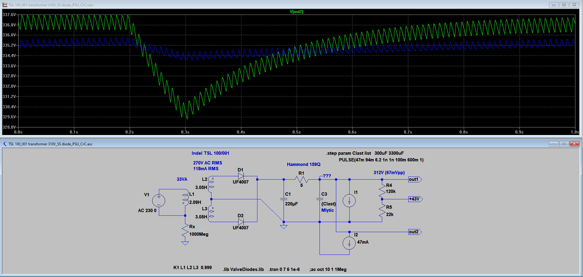

Wow! I wasn't expecting that. What if L5 was 5R resistor, and C3 was 3300u? I'm guessing the bouce would go away?
Do you want few hundred mA charging pulses on last capacitor? :-o

euro21: When I added a 33 uF cap to the 1.5 uF on the 30 tube power supply node, it didn’t make any audible difference to the sound. However, the speakers I use are La Scalas, and have a -3 DB point at around 57 Hz. I would imagine that the change would have been more obvious if my speakers went down to 20 Hz. The graphs really illustrate the impact of capacitor value changes on the recovery time/time constant and on the degree to which the cap is depleted on transients.
Please correct me if I’m wrong, but wouldn’t the sort of jump in current draw used in your sim never actually happen with a single ended amp?
"Please correct me if I’m wrong, but wouldn’t the sort of jump in current draw used in your sim never actually happen with a single ended amp? "
It's shows the PSU behaviour at worst case. If not swinging, the sag and the recovery not too much, would be good.
The correctly developed devices (sources, pre- and power amps) has LF bandwidth restrictions, so such stress does not usually occur.
But some electronic "music" may contains extreme sound effects, and -for example- footdrum punch also can cause surprises for SE amps.
