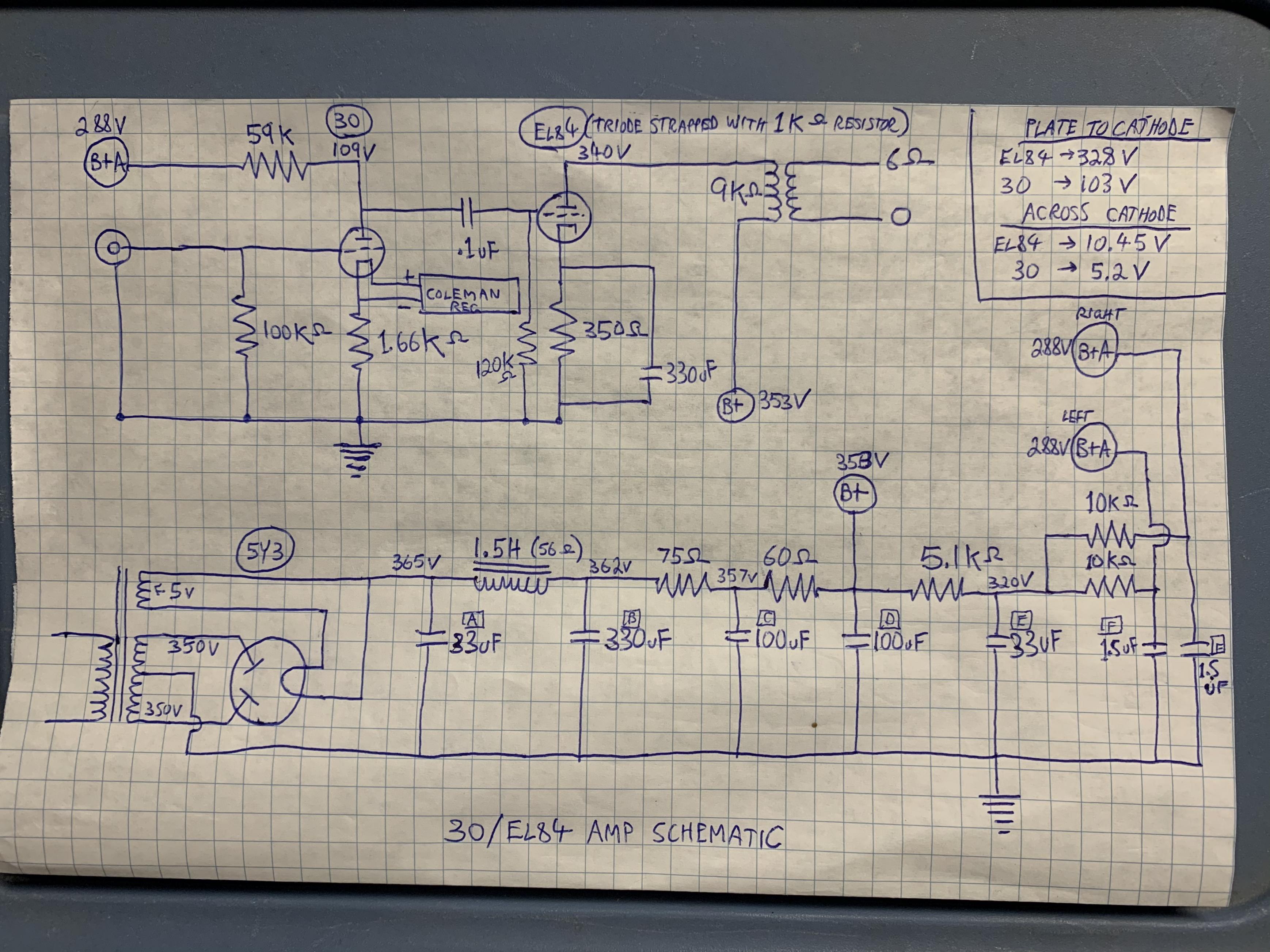

I am posting here to ask if anyone knows how to calculate what size a capacitor should be for a given B+ node.
Is there a method that can be used to figure out what value a capacitor should be to properly supply the B+ node for a power tube and the B+ node for a driver tube?

The capacitors ARE the filters (unless it's a regulated supply).
Of course, they usually also serve as AC ground returns for the signal.
If the audio circuit has a bandwidth of say 10Hz, the power supply bandwidth
should be more like 1Hz.

Yes; you can even write math on the complex plane to make the reverse loss exceed the forward gain. I have a reference in deep files somewhere. But I don't think that is the answer wanted here. The cave-man answer is: caps are so cheap we don't ask for a "proper size", but a general notion of a "minimum" size. If we maybe need 13.57uFd, but it takes an hour to confirm that, we may realize that a 40 or 47 uFd is surely ample and cheaper than an hour of brain-work. (The balance changes from DIY to mass production.)

If you are on AC supply, the filtering needed to kill buzz is "probably" ample to kill motorboating, at least for limited-bass audio systems such as guitar amplifiers.
RDH4 teaches that 2 stages on one node is always stable, so it is uneconomic to have per-stage decoupling. Looking back, many-stage amps tend to run one decoupling node for each two sequential stages.
RCA Tube Manual (RC-14 etc) says "The impedance of the condenser at the lowest frequency amplified should not be more than one-fifth of the impedance of the filter choke or resistor at that frequency" (1/10 better). But this is ambiguous and situational. The resistor may be picked for a voltage drop, not about how much it may couple. "lowest frequency amplified" might be the -3dB freq -or- the unity-gain freq.

I started this thread because I was told in another thread that the capacitor value I included in the power supply node for a driver tube was "too small". I said okay, how do you work out what it should be? One member linked this article by Loesch, which suggests a relatively simple method of picking the value of the capacitor for the power supply node of a power tube (for single ended amps)...
https://www.diyaudio.com/forums/att...-6v6-el34-singleended-valve-amplifiers-tl-pdf
The last part of the article is where Loesch discusses it. Not caveman, but doable for my caveman brain.
Concerning to me is the article's description of the relationship between an output tube's power supply node capacitance value, and the resistance of the entire supply up to that point. To me, it suggests that arbitrarily picking large capacitance values for power supply nodes may not be the best way to go.
Is using Loesch's method a good way to go?

Loesch has a lot of... unusual ideas. You're better getting your info from formal engineering sources than hi-fi-guru-manifestos-on-the-internet. So no. Just make the reactance of the cap at 1Hz a tiny fraction of the wanted impedance in series with the tube. Then use a bigger cap. 47uF covers nearly all situations.

kodabmx: “Just make the reactance of the cap at 1Hz a tiny fraction of the wanted impedance in series with the tube. Then use a bigger cap. 47uF covers nearly all situations.” What does that look like as a repeatable equation?
Also, isn’t this roughly what Loesch’s method does, as described in the above linked article?

Okay. Using the attached schematic, what is the minimum and ideal value for the capacitor in each node feeding each 30 tube, and what is the process used to derive it? The capacitor in question (F) is shown as a 1.5 uF.
