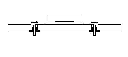

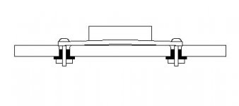

Listen to Gnomus! Even if you DON'T have to use an insulating washer because the active device is isolated on a single heatsink, you still should use the grease! The grease has nothing to do with electrical insulation-it is to help transfer heat.

Mica and Kapton
As far as I know Kapton is not better than mica.
The thermal resistance for mica is .75-1.0, Kapton .9-1.5.
Beryllim oxide (.25) is the best but I do not think it is made any more because it is toxic. They all have excellent electrical isolation.
Kapton can give extremely low thermal impedance (this has been discussed to death at least twice before) figures but usually requires both surfaces to be extremely flat, large, or able to cope with high mounting pressures or some combination of these... none of these is suitable for diy stuff as a stock heatsink is not flat enough and nor is the device heatspreader, transistor surface is small and can only take about 15lb/in^2 mounting pressure. Personally I feel mica is the way to go. Sure there are better things available but for availability, suitability and cost they are pretty much impossible to beat.

Whatever you use, use a torque wrench set to the correct torque for the transistors you are going to mount. Not enough and your contact is not good enough, to much and your transistor base gets deformed (even worse). This will probably make more difference than a specific type of grease or insulator.
PS if the thermal resistance of your insulator is that important, something is wrong. Use a larger heatsink or reduce dissipation.
