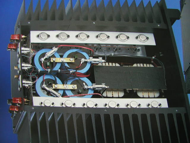

lordvader said:You insulate the transistors with grease, a washer, whatever, but then you screw them down. A screw is made of metal, and it makes contact with the transistor AND the heatsink. Wouldn't that defeat the purpose of insulating in the first place?
There's to ways (i'm aware of atleast) to overcome this. The first one is to use a special plastic "washer" that isolates the heatsink from the screw through it. You place it on the heatsink screw hole and it covers the top and the inside, so the screw floats at the voltage of the transistor but the sink is isolated from it. I use them all the time and never had a problem.
The other one is nylon nuts and screws. Yes, they do exist and are relatively cheap (not as much as the washer thing through), but i had my problems with them... if you, for whatever reason screw and unscrew them a couple of times the threading on the screw just ruins.

Due to the problem of using the right amount of grease (usually too much is used + the best types are too thick to work with), I recommend going greaseless. I ended up using Bergquist Silpad 2000 which guarantees very high performance.
For best electrical, capacitive and thermal performance, go with BeO types (you still have to contend with the grease problem which can reduce thermal performance significantly). BeO has another problem -- while harmless in it's fired state, ground up dust is toxic and leads to berylliosis if inhaled. This is similar to Astbestosis which is the effect of Astbestos. Strange how materials so dissimilar in thermal property have virtually identical effect on the body. BeO also has interesting radiological properties.
Some people like Aluminium Oxide washers (misnomer -- they are Aluminium which has oxide layer on both sides). These should also perform well IF you mount them properly, but do not have the same fantastic dielectric properties as BeO.
Save yourself the trouble and mess and go with Silpad.
As for mounting instructions and torque, the Aavid/Thermalloy site has a good white paper on this per package type -- incidentally they are also the only manufacturer of BeO type washers I have found to date.

Use insulating nylon washer made for use with metal transistors with TO3 and TO220 devices. A TO247 has an insulated body around the screw hole but needs the Mica thermal washer and grease between the transistor and the heatsink to provide good electrical isolation and good thermal conductivity. When tightening your screws, USE THE FORCE, but not to much force or you can damage the insulating washers and they will no longer be insulators.
