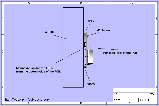

Fets under glass
I have seen Fets mounted between the PCB and the heatsink. Is this a good idea or will the glass insulate the Fets causing them to run hotter?

Hello,
I think that someone did not understand the right way of the mounting the FETs between the heatsinks and the PCB.
Actually, there is no PCB between the FETs and the heatsinks.
The FETs are soldered and mounted to the bottom side of the PCB, and then all together is mounted on the heatsink.
The metal tabs of the FETs are facing the heatsink, and the PCB is on the top of the FETs.

I stated the question wrong, Sorry. DUH
Will the PCB insulate the top of the FET, preventing heat escaping to the air and resulting in higher FET temperature than if the top was exposed?
Not a great deal because the die is located on the face of the fet that is mounted to the heatsink there is usually a small air gap or quite a thick piece of plastic between the die and the front cover of the fet so not much heat can get out that way regardless.

Thats right about heat escape plus the back that is attached to the heatsink is metal, so almost heat is transfered through there.

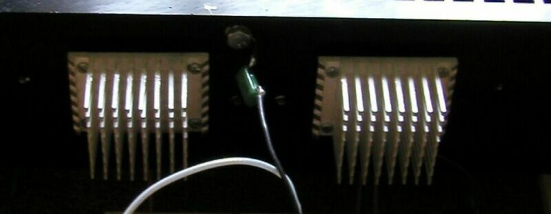

All this gained me a possibility to increase the heat dissioation on TO3P cases from about 27W to 37W.
The other good point is that SLOT1 radiators are although rare but very cheao if you'll find them. They also have holes for the screws already in right place 🙂
Ergo
