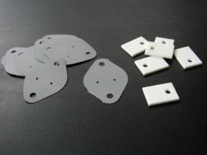

What type of cases? In my A75 amps which run now for almost 7 years without failure I used silicon rubber insulators (no grease). For my upcoming Aleph project I will use beryllium oxide insulators and I suppose I have to use grase on them.
I tap the holes in the heatsinks and use screws to hold the devices. I think Nelson Pass mentioned somwhere on the forum the torque value. Then I p2p wire the output stage.
Yes, I also would like to know what is the proper way of mounting plastic transistors (.... yes... for Aleph 2). Some of the questions are:
1. Insulator type. Always recommend vendors and give part numbers if possible...... this way, I can look it up on the web site ... and in the future .... I'll know where to go to look.
2. Grease type. Do you use just a little or a lot per transistor? Do you apply grease on both side of the insulator? Vendor and part number too .... please.
3. How do you actually mount it on the heatsink? Do you have to use machine screw and nut or just machine screw only. Doesn't the screw come loose after a while (if the nut were not used) because of the heat expansion when it's on and cooling contraction when it's off. I've asked this question before somewhere else .... I would like to hear more opinions. Is there any particular type of screw that is preferred?
4. Do you mount the transistors on the middle of the heatsink as opposed to one side of the heatsink? I think I know the answer but does it really make a difference since eventually the heat will be spread out to the whole heatsink.?
5. Is the hole on the plastic transistor pretty standard? What is a typical diameter for the hole?

OK here we go... i usually use mica and a TINY bit of thermal grease unless the sink is internal and can be left "floating" or the package is completely plastic. Common steel screws do the fixing, using these small plastic separators to keep the package from connecting to the heatsink through the screw... thats pretty much it.

I am planing in making an Aleph with external heatsinks. I am not so sure what to do with mounting the transistors. I haven´t tried making holes for M3 screws which is the best but hard to do. For this amp I dont want to drill holes through them and you also can´t do that because the heatsinks dont have any flat surfaces on the outside in the first place. One good idea I was thinking of doing is to use alu pieces and press the transistors down on the heatsink. In this way you can use M4 or M5 screws which are easier to use.
Hi Promitheus,
when you use external heatsinks for an Aleph they normally are at least 8-10mm thickn. It´s quite easy to drill a 2.5mm hole about 7mm deep an tap some M3 tread in it. This way you won´t see anything on the outside and you don´t have to fumble with M3 nuts. The other option with a thick aluminium bar is also possible although you should use a screw between every fet otherwise it´s not garanteed that all are pressed equally to the heat sink.
I use kapton isolators for the TO-247 and TO-3 cases cause they have a very low thermal resistance (0,07K/W) and you don´t need to use grease.
william

the plastic transistors we generally use in output devices are in TO-3P / TO-247 package i cant quite remember off the top of my head but i believe that the TO-247 has an insulated mounting hole and the TO-3P has a live mounting hole thus requiring a sleave for insulation. Then again, it may be the other way around.
You don't have to insulate screw in TO-247 because the metal doesn't touch the hole. For TO-3 you need plastic washers with sleeves to isolate the screw.
I don't recommend using bar to hold the transistors. It's just extra work and material because the amount of holes is almost the same. The alternative to using M3 screw (which for that purpose really sucks because of fine thread) is using SAE screws which I believe are available in Europe as well. The choice here would be #6-32 which is very easy to tap. The hole size is 7/64".
