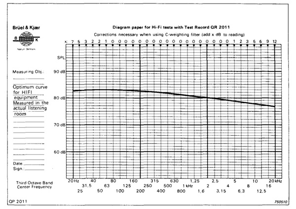

I think the real hole of his study is he did not publish the study of the mastering studio listening environment. I strongly believe he researched about it but kept it secret.
Mastering studio processes have been esoterically hidden from our consumers purposefully, and unlike RIAA curve, we don't know what is the correct (suggested) response of the speakers in the actual listening room, so some people try to blindly believe that flat response is the right response while the mastering studios’ room and speaker responses are far from flat in most cases.
And no one has come up with anyting solid yet.

There has been plenty of research on 'house curves' and with the advent of DSP, it's easy to experiment with. The B&K curve is a result of plenty of DBLTs, and one that I think sounds pretty good
