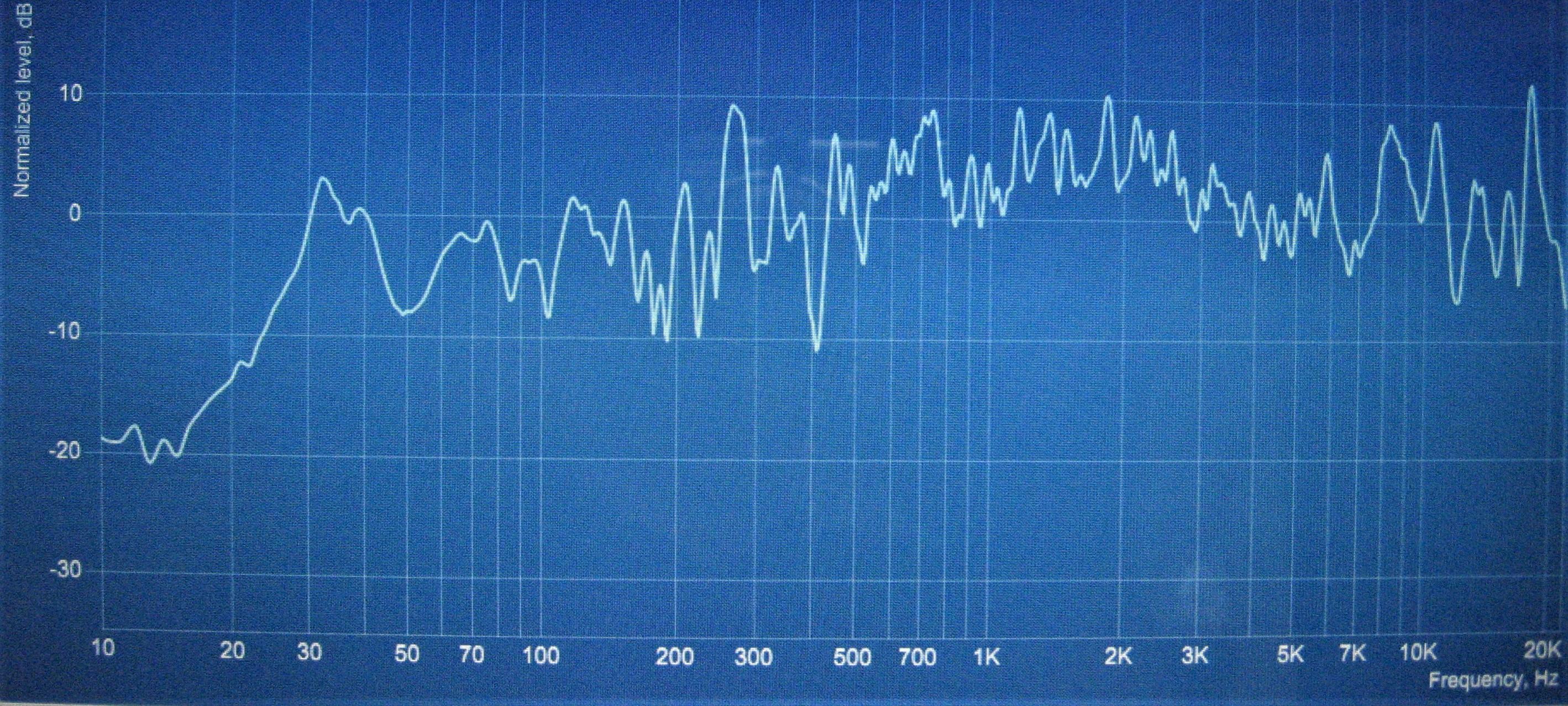

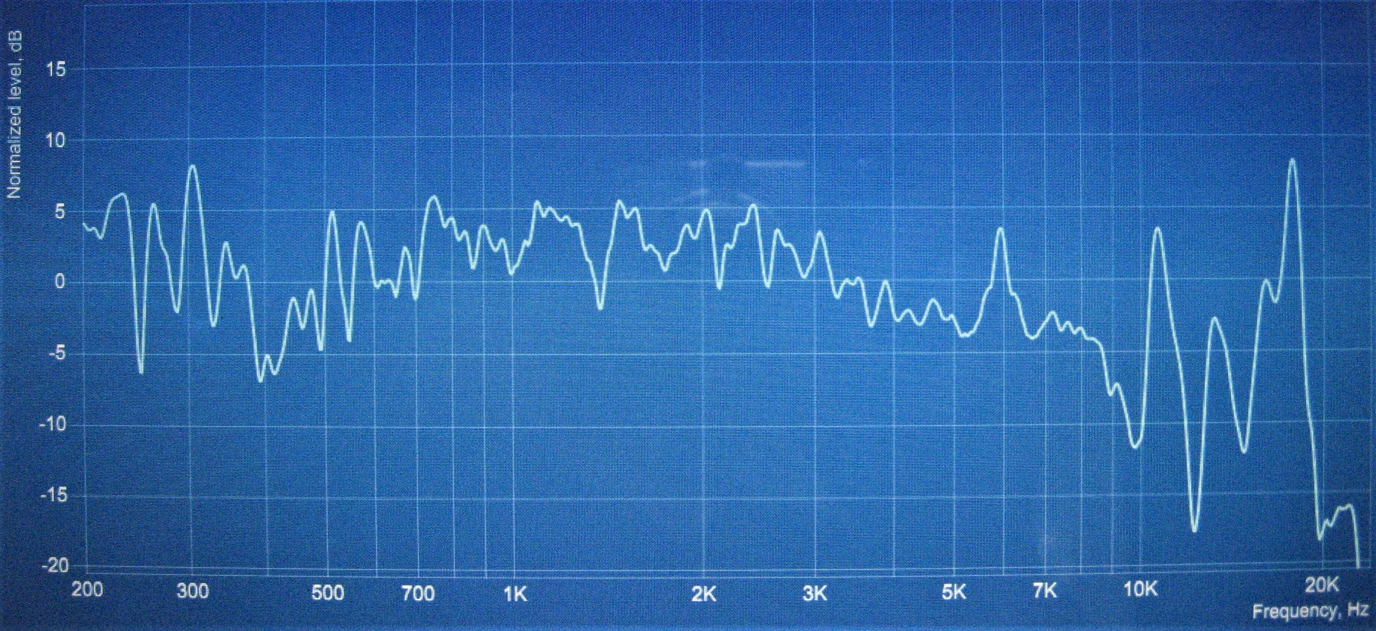

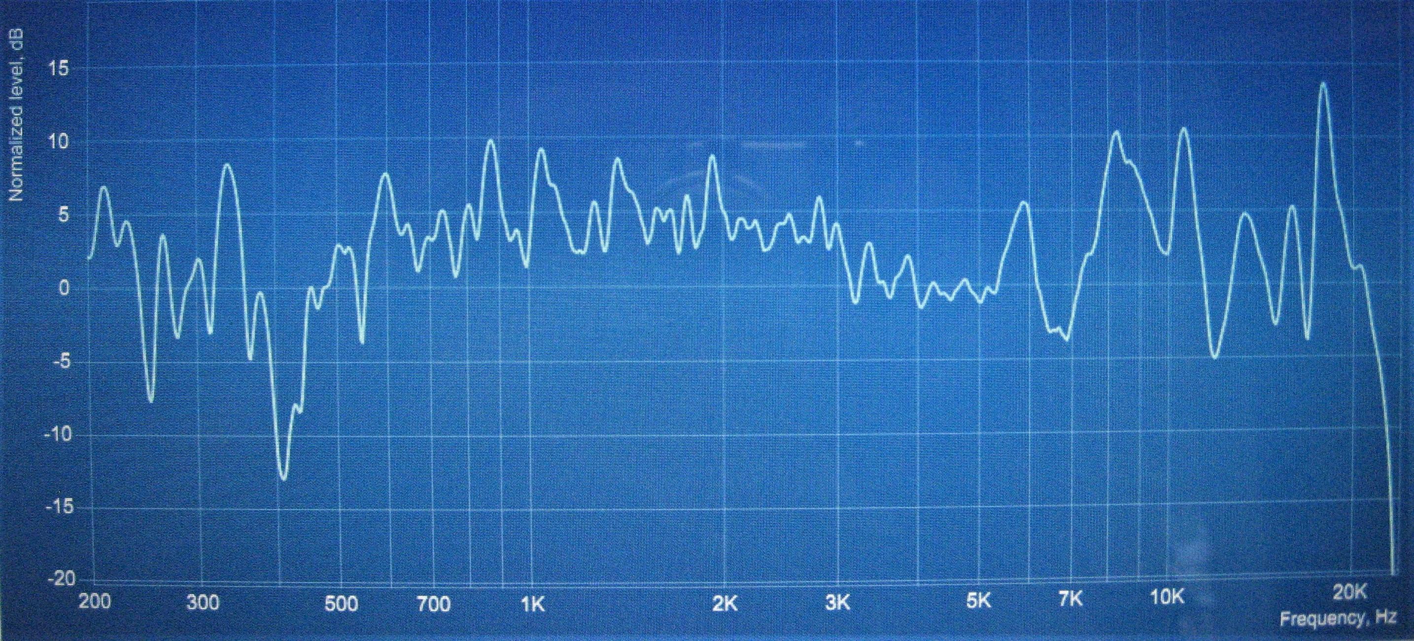

It's been a while, but there were some other problems to solve in meantime. I was one of organizers of Triode festival Croatia (10th meeting) so it took me some time but I managed to do some measurement of finished speakers (as they were presented in festival). Here are some pics from the festival, if someone is interested in: HiFi Media - HiFi Media added a new photo. | Facebook
anyway, measurements were done without my presence (the guy is kind a strange) but he is professional and measurement gear was Dirac so I thing this is done correctly.
The last graph is measurement at axis on listening position in room (attic - under the roof). I am satisfied, but will do another box, more height, less deep and semi cylindrical. Same volume and tuning of the box… we'll see...
