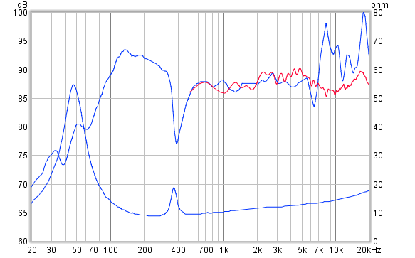

Below Maty's shared A-11MS datasheet graphs (blue) on a same vertical 60dB scale as KEF LS50 (red) on axis graph shared in post 71, had it been 01st of April one could have said are you joking about LS50 is better 😛
Understand for some out of box A-11MS can be a great project, what is not understandable is we told below blue traces that is real live visuals mean mostly nothing and we shall start use our ears because MA drivers have superior perfect reference low level details 30-60dB down and will run over that LS50 😕
Could be wrong about A-11MS but for many other MA transducers that resonance used to be the abrupt cone transition cause the rubber surround is underhung, in ergo's nice informative objective post 50 for A-7 transducer resonance for underhung surround go again but less huge as for A-11MS and remind me in the past MA CHN-70 showed same objective huge data tendency as A-11MS and based that experience then expect also HD will go little crazy there at that resonance.
±10-15 dB variation within the audio band. It makes me wonder if the MA driver is measured in a live room. At least that would explain the deep notch at 400ish Hz (although it's high for a room mode). It wouldn't explain the peaking in the HF end, though.

Also, the MA driver factory data are claimed to be measured in an anechoic chamber with a premium Earthworks microphone and LMS measurement system/software. This has been discussed at length in previous threads where user measurements vs factory measurements were presented.
If you look at the factory Alpair 11MS data, you will see the LMS logo at the bottom. The problem is the use of a 0dB to 100dB with 10dB major divisions. It smooths things out.
My measurement of a CHN-70 a while back using a nice trapezoid baffle yielded a similar dip behavior and overall rough response. A measurement in a large open baffle which should not have baffle edge effects gave a similar result. It is the suspension and driver mechanical design that causes this. But, small width dips like this are very hard to discern to the ear. Peaks are much more noticeable - our ears fill in the missing content psychoacoustically, but we cannot suppress peaks as well. Sort of like we do not notice blind spot in our retina's fovea, but we cannot ignore a bright flash of light no matter how faint upon a dark background. So I would not say that this driver doesn't sound good or play music in a way that is unappealing to many. It just cannot be used for a studio mastering or mixing monitor.

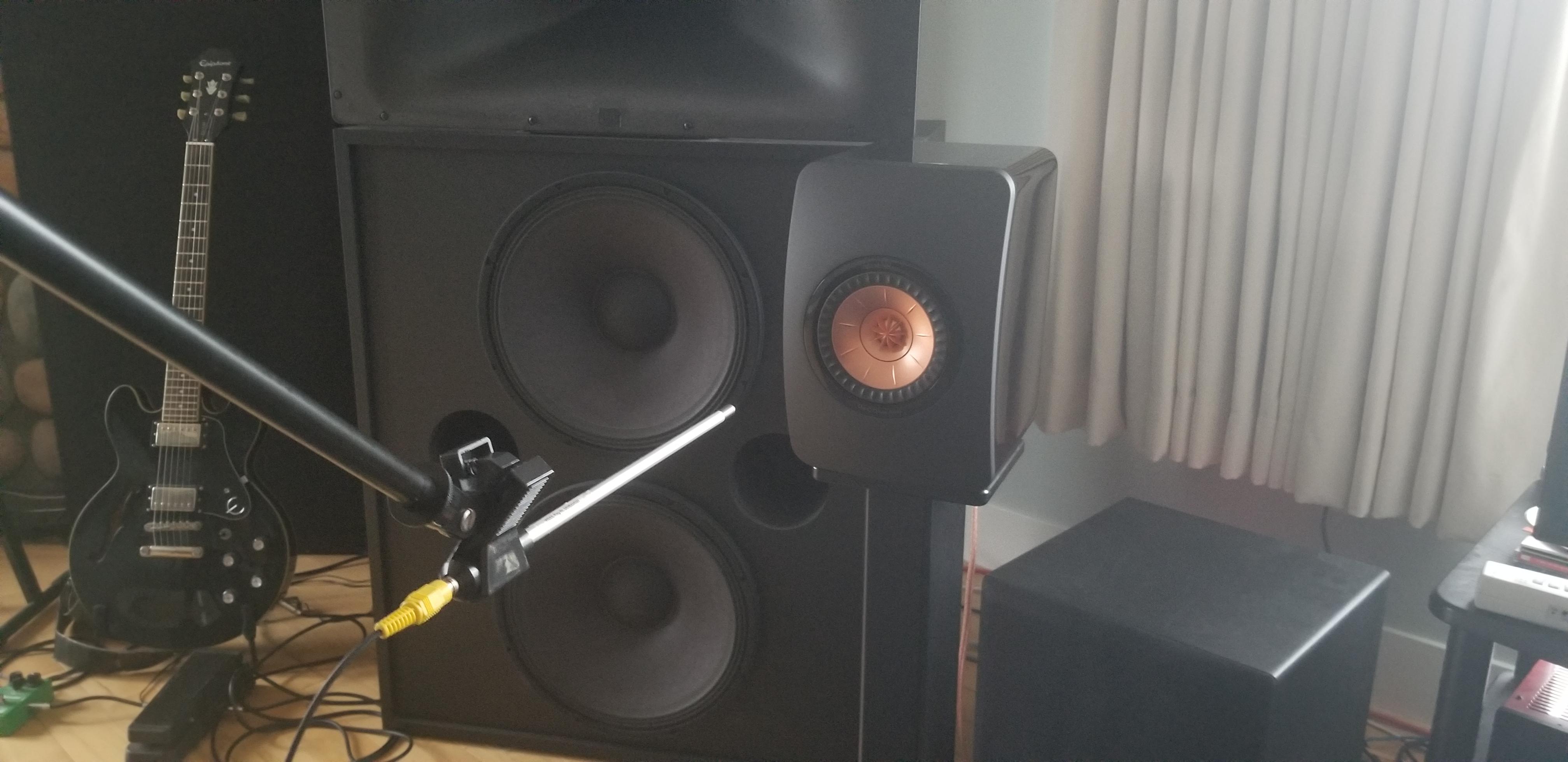

Speakers look good - well done. If you can use REW (freeware) to measure once you get a mic, then it will be easy to compare as REW has overlay capabilities where people can share and overlay their measurements. Do you have access to a PC or Mac?
Place the mic on axis about 30cm away like this:
attachment.php

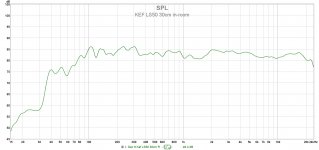

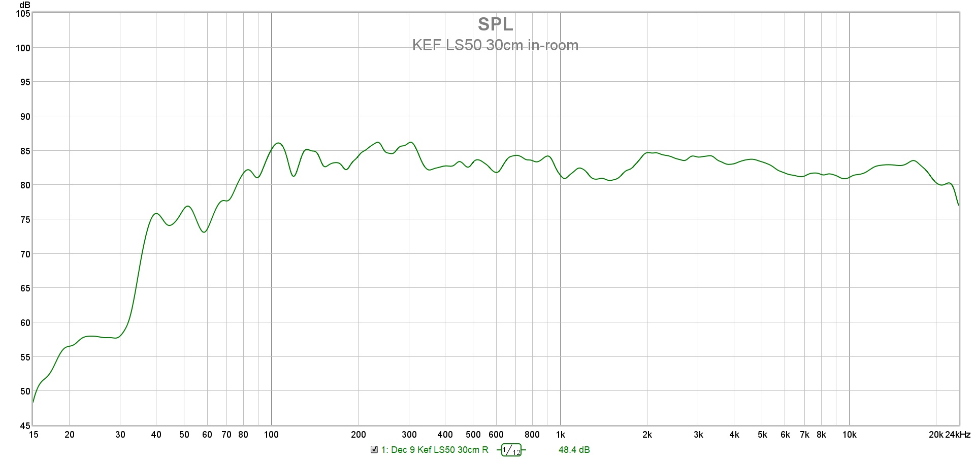

If you can follow the REW calibration procedure and use an SPL meter or your phone SLM to measure ~ 83 dB SPL at the measurement mic would be good. Why? It gives a good signal to the mic without activating too much of the room. Here is what I measured for the LS50 using 1/12 octave smoothing:

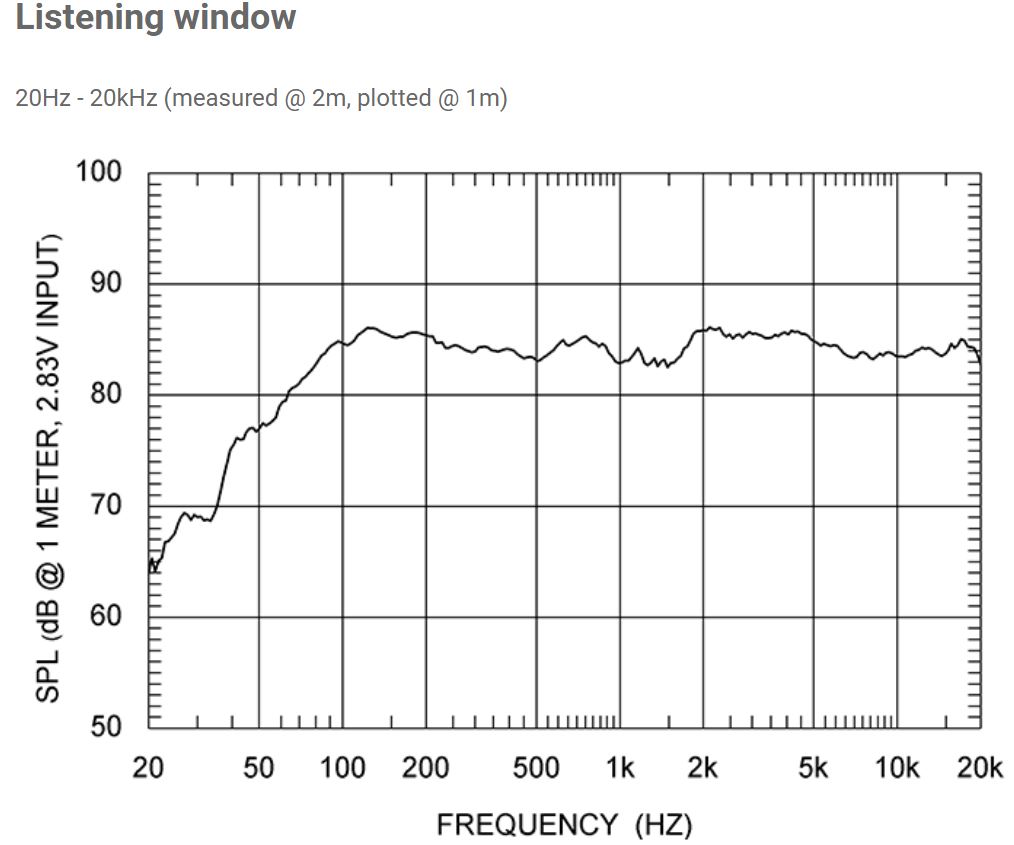

And here is the anechoic measurement at the Canada's NRC courtesy of Soundstage:
attachment.php
Even in my cluttered room and using a default window of 500ms, it is quite close to the anechoic response. Certainly good enough to characterise the frequency response of the system.

I'm curious what could be causing that huge resonance at 400Hz. That's got to sound bad. 😱
I discussed that with Mark. It is mostly a side effect of no spider. The A7ms shows a smaller one.
