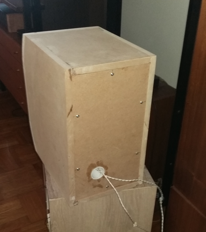

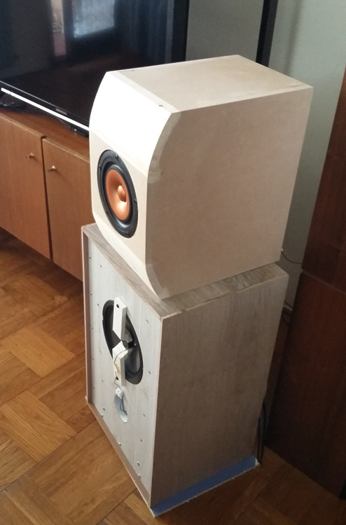

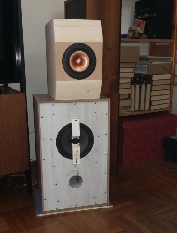

A11MS as LS50
Hi there,
This is my contribution to this discussion. Two months ago I've received A11MS and after some serious thinking process (well, it happens sometimes) and testing drivers in some inadequate Voigt pipes (just to give them some time to settle down) I decided to put them in a BR box sharing some principles as KEF LS50 does. I'm little bit tired of tall narrow boxes (Voigt, TLs, MLTLs, BLHs and alike) so stand-mount it is. I haven't herd LS50 but they intrigued me with their design, especially their front panel. It is basically segment of a ball and it has big influence in diffraction distortion and so on. As i don't have all needed tools to shape a ball segment (and some lack of skill, of course) I decided to shape front panel as segment of cylinder. Close enough. Box is 19 liters tuned to 42 Hz, bit larger than KEFs. Yesterday morning (well, more like noon) finished and playing since. Sound? GREAT! I am not afraid of direct comparison to KEFs in any kind, DBLT or so (I made them so they must be the best in the world, naturally!). Precise, defined sound, I recommend this this drivers in proper box, by all means.
And some pics:
