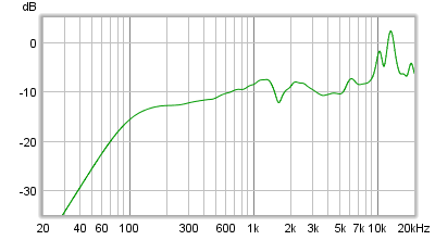

Nothing special?
I think the massive breakup at 1.5kHz, and the dip at 6.2kHz (cone shape?) are pretty special.
Add the fact that they drop like a brick at 12kHz, and that being on axis?
I thought I remembered seeing that FR response before, I wasn't sure where.
Good to know. Maybe why they are discontinued?
I was trying to be diplomatic. Biting my tongue.

I think you may also miss the point. The frequency response measured above is horrid to say the least. There could be many reasons for that, the driver just being one of them.

I just want to point out that regarding post #50, I think the FR is shown in the 1st image. I think a few comments were possibly made in response to the 2nd image which looks to me like a close mic measurement used for measuring HD. Please correct me if I'm wrong; just trying to help. Looks like some good work with the measurements, BTW.
Correct. The THD measurement is a near field measurement.
* mic was placed at 1m to set SPL, then moved close to the cone to allow reliable THD in normal room. Mic used is a lab grade one that handles that loud SPL with mic's own distortion being much lower than the speakers.
