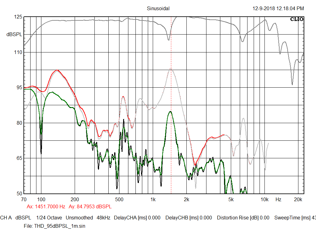

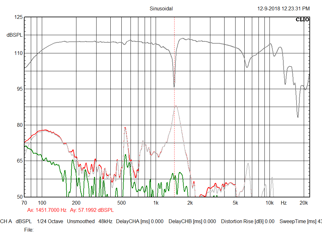

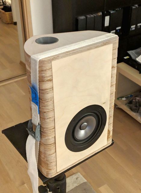

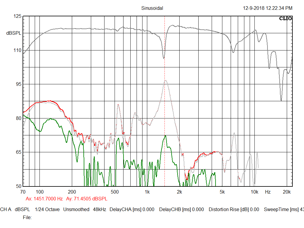

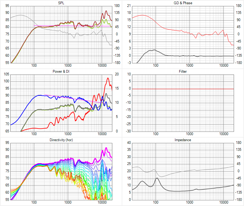

I would have to disagree on Alpair 7 part. I do not own LS50, but have heard them and the Alpairs really did not live up to hype around here and the measurements I've done agree. The box tested is a 7L inverter box.
VituixCAD plots for off axis measurements
THD 85 dBSPL @ 1m
THD 90 dBSPL @ 1m
THD 95 dBSPL @ 1m

Thanks for the measurements. I agree with you these drivers are nothing special.
Nothing special?
I think the massive breakup at 1.5kHz, and the dip at 6.2kHz (cone shape?) are pretty special.
Add the fact that they drop like a brick at 12kHz, and that being on axis?
I thought I remembered seeing that FR response before, I wasn't sure where.
Good to know. Maybe why they are discontinued?
742818d1552587229-markaudio-fare-kef-ls50-thd_db_85dbspl_1m-png

I would remind people that having seen many measures of these drivers and they all have differences. I would not put any weight on 1 particular measure — keep in mind that if you want something different looking move the mic 1". The one shown is one of th eleast representitive i have seen. I hold to what Floyd Tole says — any measurement taken outside an anechoic chamber is suspect (he used stronger words) and even those can be misleading.
The A7 has some peakiness off-axis. If you move off-axis it dissappears and if you are older you won’t hear it anyway. They have really good midrange with a high DDR and the seamlessness that comes with most FRs and is so often missing once an XO is put into the critical range.
