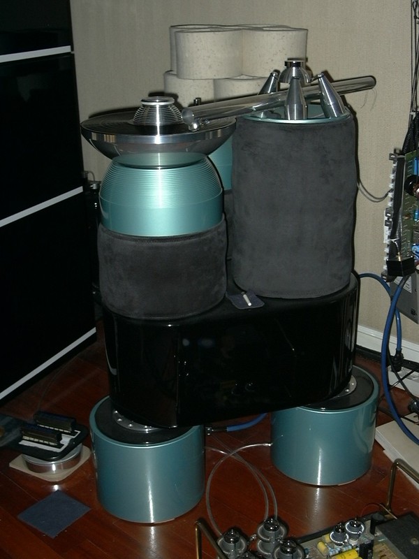

Yes! You need to have a dynamically very rigid system coupled to the external world and between the essential components at highly subsonic frequency, as low as possible. In that way not only you can reproduce 8 or 16 Hz but he entire spectrum will be vibration free, any internal resonance ERADICATED, anti-skating issue not known etc. etc.
In picture how far one can go but it is possible to improve MASSIVELY even with conventional and much, much cheaper stuff. All one needs to do is understand how it works and find the solution. It is not possible by trial and error....

The point about 8 and 16Hz tones is a good one and not as simple as it seems. Every turntable has a mechanical resonance between the compliance of the cartridge and the inertia of the tonearm. This gives it a 2nd order high pass characteristic. It probably cuts off somewhere between 8 and 16Hz.
Not every turntable. The one above in the picture sets the present limit. There is not resonance in that region between cartridge and arm simply because they form ONE body!
No. Go back and think carefully about how a turntable works.
The tonearm has to pivot freely at subsonic frequencies, otherwise the cartridge couldn't track warped and off-centre records. Or any records at all if you want to be pedantic: the inward motion of the spiral groove is just a subsonic signal with a very low frequency indeed, one cycle per record side.
But it has to behave as a rigid mass at audio frequencies, otherwise bass notes would just wiggle the tonearm instead of wiggling the stylus and generating audio output.
It follows that it can't be anything other than a second-order high pass filter, one that does a valuable job keeping subsonic signals out of your preamp.
Like any mass-spring system, it is indeed. Effective mass (of the cartridge and the tonearm, dominated by the cartridge and headshell mass) versus cartridge compliance.

No, I think you should read more carefully.
Indeed the arm is free, it is the cartridge-arm coupling (i.e. resonance) that is removed because they make ONE body. How this is done is not something I can tell you for free for obvious reasons...but you could understand it and do it by yourself as I did.....Then you are only left with the cartridge compliance which doesn't couple to anything.
The only resonances in the system are below 1Hz in that turntable and can be below 3-4 Hz in simpler systems! All "filters" are LOW pass. In the working (audio) band and actually quite below and above the system is resonance free which means zero ideally and at a level much below the signal (or if you like such that the ratio is better than the required dynamic range, just like in a good amplifier). More importantly there is no correlation between noise and signal and this is not true for digital sources where "you have to inject noise to cure the disease"....!😀
Who made it ?
MOSS in Italy. He is been making and improving turntables since the early '80s
