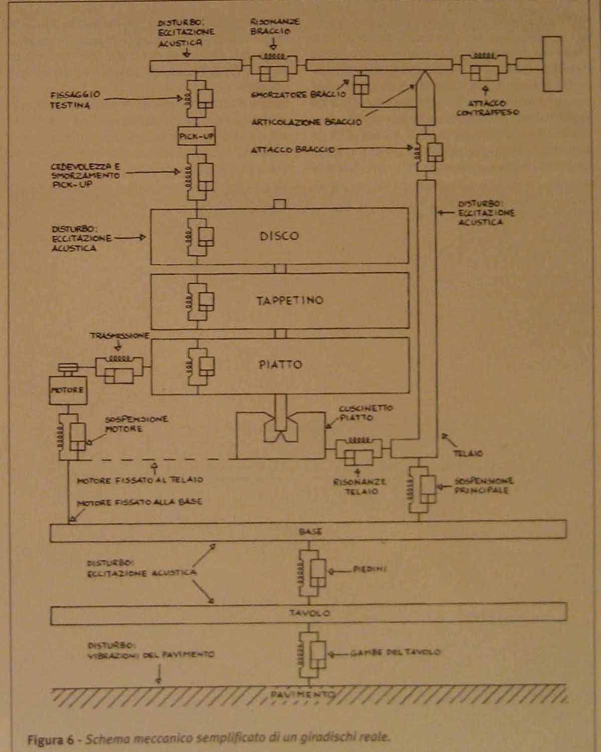

45, the stylus has compliance.

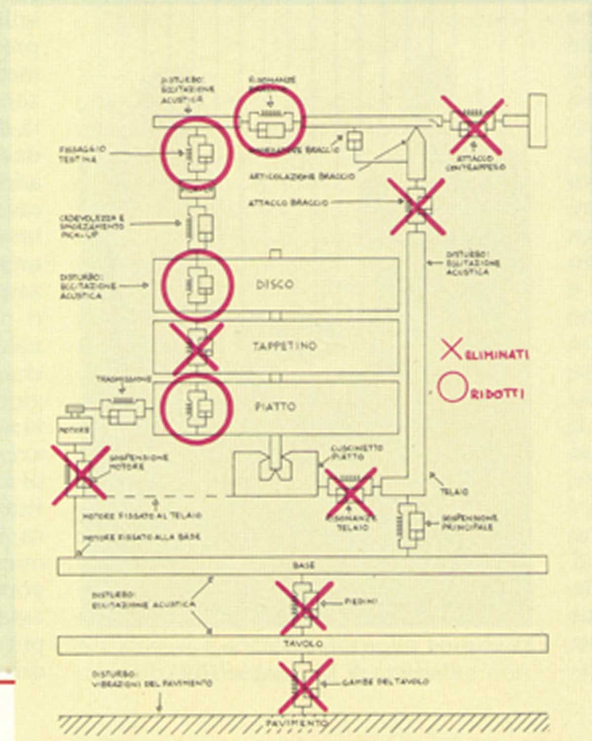

Yes, I know. And it is just that in my system. In a conventional arm one has a strong coupling to the arm. To be more clear here is a schematics of a conventional turntable with all its couplings and how the MOSS compares (the cross = removed and circle = vastly reduced). You can also see that the compliance of the cartridge is there while the arm resonance and the cartridge mount have been "cured enough" to avoid the typical subsonic issues. Sorry for the italian but it is quite clear to me anyway and one can use a translator....

I have never said it can reproduce DC and actually there is no reason to reproduce DC. No music there! The high pass filter is decoupled and undesired resonance free. It is just simple as that. It is as good as it can get.
The B&O is not a solution for me, it still gets all troubles because feedback cannot cure the troubles at the same precise instant they happen. The concept is rather different: you just don't make them happen.

Nonetheless, the resonance is greatly dominated by one of the terms, the effective mass of the cartridge and the stylus/cantilever compliance. No matter what you do elsewhere, that resonance is still there and it's still a second order filter.
And so? A violin has a resonance chamber, for example! That's the way the cartridge works. Don't forget the scheme is just modeling (i.e. an equivalent not the real thing).
The point was another one (i.e. the coupling between the arm and the cartridge). That is the "infamous" subsonic issue removed here. And usually such frequency falls (or it is made so that it falls) around 10Hz in most systems not 1Hz!
It's not removed. No matter what you do elsewhere, it's still there. All you can do is move the frequency around by changing the effective mass. You can't make a massless cartridge/headshell, so that sets an upper bound for resonance frequency.
Is not removed in your system or what you have seen until now. Also you have to think in terms of useful band and not infinite band from DC which is not practical and basically useless.
There is no headshell in my system. The cartridge is ONE body with the arm. Look at the picture and you will see there is no headshell, no counterweight, no antiskating, no conventional pieces that just create undesired resonances in the working band!

Indeed the arm is free, it is the cartridge-arm coupling (i.e. resonance) that is removed because they make ONE body. [snip]Then you are only left with the cartridge compliance which doesn't couple to anything.
How is that? The cart has compliance, and whatever it is connected to has an effective mass, no? The cart is coupled to something, it's not hanging in the air.
Any compliance-mass system has a resonance frequency with a Q. So how can it disappear here?
