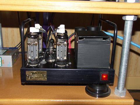

I already did not tube in the front en but tube in the endstage. Most think OPT is wrong I do not think so the OPT as transformers in audio are the blessing, and capacitors the curse.Hybrid is the way to go Imo, a pity very few attempt to do so ....
Mine PSE has no overall feed back and has low distorsion level on that of a good loudspeaker. Due its solidstate drive stage it is noise free also on maximum volume you have to put your ear near to the tweeter to hear noise and there is no hum.
On listening position it is absolute noise free.
The reason to do so was the digital audio is solid state, and the problem are the power transistors in the poweramplifier, end tubes are very fast they are not old and slow as some may think.

Hello , no global feedback , but you are still running feedback ..

Yes in the pre-stage and I run a KT66 as a triode then you get in fact cathode feedback and I also use a cathode resistor that gives some local feedback.
Local isn't overal. You can not get the same result SS this way because a triode tube is very nice amplifier.

A transformer is a nice bandpass filter doesn't have to effect sound negative it helps cut of ultrasonic passive. Roughly I would say 3X fmax so f3 at 60khz.
Because I do not want to see phase shift in the audible area.

Yes, thats what i meant , you had to be running some kind of local feedback, degeneration is feedback ...
