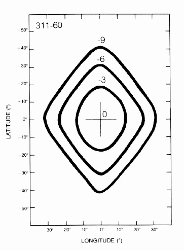

Hello Revintage,
You wrote,
That's a difficult problem.
Only modes 00, 0i, j0 exist with round horns but in horns having square or rectangular mouth other HOMs exist.
As an example see how the Altec 311-60 horn radiates (see attached graph from Altec data sheet).
What seems to happens is that the corners inside the horns have lower pressure than the near axial zones.
For a square horn eventually we could say that from the radiation point of view the horn emit nearly like if a round horn was inserted inside the square horn (that's a bad image but I hope you see what I mean)
Best regards from Paris, France
Jean-Michel Le Cléac'h
