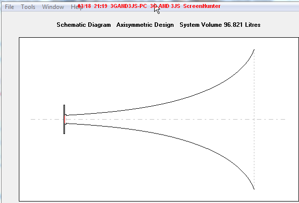

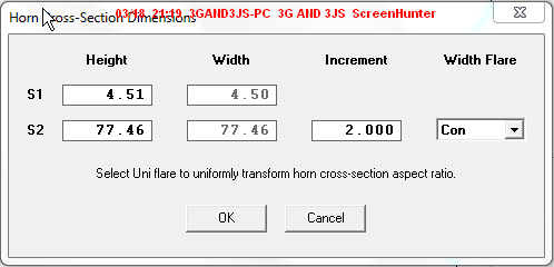

Hi David

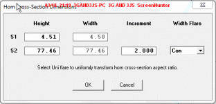

When exporting data to try and plot a Tractrix horn design what do I select in the following screen?
Note:I havent changed the data on the Export page.
Is it as simple as entering the S1 and S2 from the earlier design? What do I do about the con, exp or uni choice?
Thanks again for your help.
Gregg

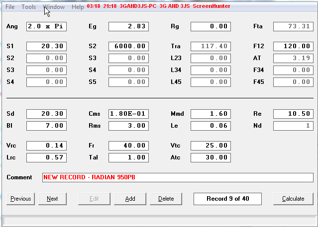

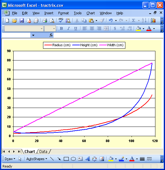

Hi Gregg,
The 'Horn Cross-Section Dimensions' input form allows you to specify the dimensions at each end of a horn segment, assuming that the cross-sectional areas are either rectangular or square at those points.
For the example you have given, S1 = 20.30 and S2 = 6000.00.
By default Hornresp assumes square cross-sectional areas for the exported data, so that:
At S1 the height = 4.51 (square root of 20.30) and the width = 4.50 (20.30 / 4.51)
Similarly, at S2 the height = 77.46 (square root of 6000.00) and the width = 77.46 (6000.00 / 77.46)
The S1 and S2 height values can be changed as required if the cross-sectional areas are not square. The width values will then be altered automatically to maintain the correct cross-sectional areas.
The Con, Exp or Uni 'Width Flare' option specifies how the width increases along the length of the horn segment - this then also influences how the height increases. The Uni option causes the horn segment to flare uniformly in both the width and height directions. This option is most likely the one that you will want to use, I expect.
The radius values for a circular cross-section horn segment are also automatically included in the exported data list.
The attached screenprint shows the plotted exported data for your example, using the default square cross-sectional area values and the Con option. The pink trace shows the width expanding "conically", the blue trace shows how the height changes because of the conical width flare, and the red trace shows the radius of an equivalent-area axisymmetric (or circular cross-section) horn segment.
If you choose the Uni flare instead for a square cross-section horn segment, then the pink and blue traces will be the same.

Thanks David
I will be building round plywwod horns, made of lots of rings of plywood turned up on a diy lathe.
I will try and process your response🙂
Big thanks again.
Big thanks again.
I will be building round plywood horns, made of lots of rings of plywood turned up on a diy lathe.
Hi Gregg,
The Height, Width and Width Flare parameters are not applicable to round horns. Simply set the 'Increment' value equal to the thickness of the plywood, and then use the exported length and radius results to construct the horn.
You have specified S1 = 20.30 and S2 = 6000.00 for your 120 hertz tractrix horn, giving a mouth Fta of 73.31 degrees.
Increasing S2 to 6539.49 would give a (fully formed) mouth Fta of 90 degrees.
Also, have you considered the possibility of perhaps using a Le Cléac'h flare, rather than a tractrix flare, for your 120 hertz horn?
Kind regards,
David
