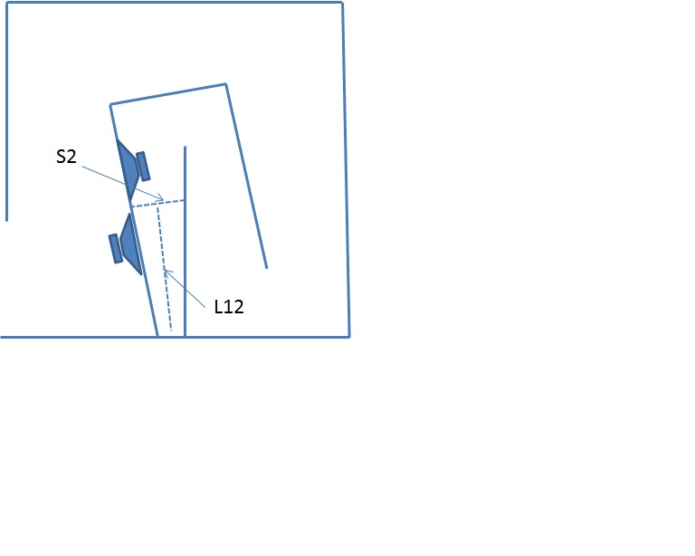

How do I simulate a TH using two drivers in parallel with HornResp?
I would like to simulate a Tapped Horn using two drivers mounted in parallel (see schematic below). However, I am a bit uncertain about how to do it. I have two questions:
1. Do I just insert the T/S-parameters for ONE driver, and then afterward press Tools => Driver Arrangements => 1 in series; 2 in parallel? Will that do the trick, or do I have to change some of the T/S-parameters in order to simulate two driver too?
2. I want to mount the drivers as in the schematic below. What are the most correct reference points for S2 and L12 (the length of the first conical section)? Is that as indicated in the drawing, or??
Thanks a lot!
Best regards
Peter
Hi Peter,
Yes - either the Thiele-Small or electro-mechanical parameters, whichever are known.
Note that it is not necessary to select Tools > Driver Arrangement. Simply double-click on the disabled TH text box in Edit mode to activate the tool.
Most correct as indicated in the drawing.
Hornresp simply assumes a single "composite driver" at the S2 point. Looking at the schematic diagram you will see that in this case the composite driver (two parallel drivers) has twice the area of a single driver.
It may be possible to build a more accurate model in AkAbak showing the two drivers as physically separated - not sure how different the results would be though.
Kind regards,
David

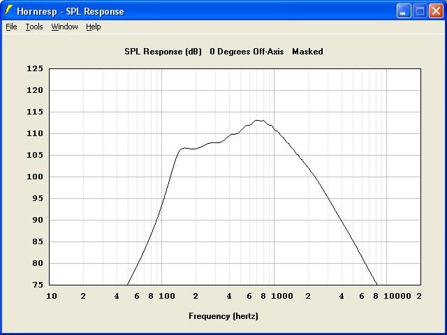

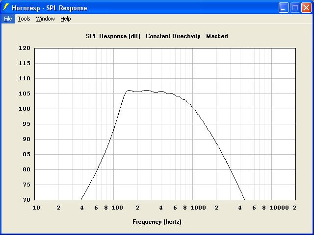

Directivity
Thanks for the reply earlier David.
From what you said, I understand that a listener sat in front of the ( exponential/hyperbolic) horn is going to be more interested in the axial pressure response for 0 degrees , not the default SPL graph which is a total power response ?
I attach two graphs , to illustrate the difference. It would seem that the design performance at present is the 'bad' one with about 7dB rise from 150 to 700Hz ? (!)
Thanks ...
MJ

Hi Mark,
From what you said, I understand that a listener sat in front of the (exponential/hyperbolic) horn is going to be more interested in the axial pressure response for 0 degrees, not the default SPL graph which is a total power response?
Correct.
I attach two graphs, to illustrate the difference. It would seem that the design performance at present is the 'bad' one with about 7dB rise from 150 to 700Hz?
The difference you are seeing is typical for a hyperbolic-exponential horn.
Anybody want a pair of nearly-new B&C 8PE21's ?
Don't be too hasty... 🙂.
Remember that Hornresp models the driver diaphragm as a rigid plane circular piston. The actual diaphragm will behave somewhat differently to this at higher frequencies.
Also, if a phasing plug is not included in the horn design then you may find that the high frequency sound output is attenuated, thus offsetting the directivity gain to some extent.
Kind regards,

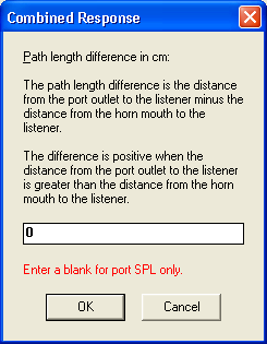

Hello David,
I am not sure if I have understood the instructions for combined/rear path length.
Check the attachement and tell me how the rear path length should be when moving the vent to the same plane as the horn mouth. Zero or -60cm?

I am not sure if I have understood the instructions for combined/rear path length. Check the attachment and tell me how the rear path length should be when moving the vent to the same plane as the horn mouth. Zero or -60cm?
Hi Lars,
In Hornresp, for the example you have given, the path length difference is defined as the distance from the port outlet to the listener minus the distance from the horn mouth to the listener.
1. If the acoustic path length from the port outlet to the listener is the same as the acoustic path length from the horn mouth to the listener, then the path length difference will be zero cm.
2. If the acoustic path length from the port outlet to the listener is 10 cm greater than the acoustic path length from the horn mouth to the listener, then the path length difference will be 10 cm.
3. If the acoustic path length from the port outlet to the listener is 10 cm less than the acoustic path length from the horn mouth to the listener, then the path length difference will be -10 cm.
Note that the path length difference relates to acoustic path lengths external to the speaker system, not to acoustic path lengths internal to the speaker system.
The attachment below refers.
EDIT - I just realised that you might still be confused after reading my explanation above 🙂. The direct answer to your question is zero cm for the example you have given. The fact that the horn mouth and port outlet are not aligned in the same plane in the schematic diagram does not matter - it all depends on how the system is actually physically configured in practice, in relation to the listener.
Kind regards,
David
