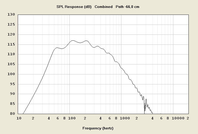

Hey Helmuth,
This is a sim of a midbass using a 150Hz Lowther Audiovector Auditorium horn together with a ported 12" Altec 414-8A:
Looks very nice flat Re-vintage. Only you shout reduce LRC to suppress the distortion at higher frequencies.
Just came to the knowledge I stll have my first visaton 10" midbas speaker and can use it for the la scala bashorn. 😎
Here the result 1PHI ported horn loading down to 75Hz.
