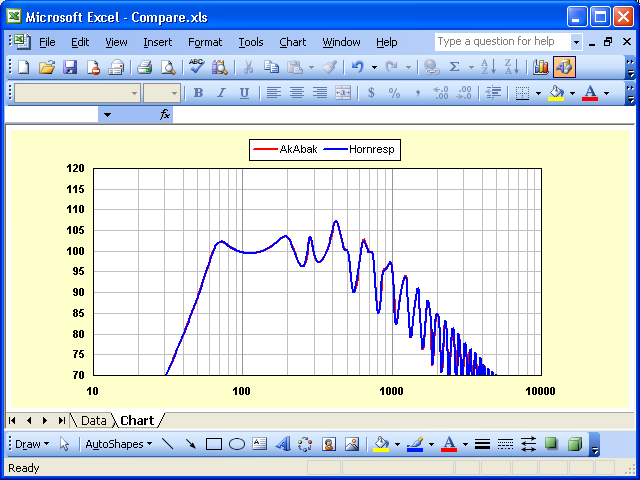

It could be an interesting exercise to build your suggested model in AkAbak and then compare the results with the Hornresp L12 = 0.10 approximation to see if the differences are of practical significance.
Hi Oliver,
I couldn't resist checking for myself 🙂.
The attached Excel chart compares the AkAbak result for a tapped horn having the first diaphragm side facing axially into the throat at S1, against the standard Hornresp result for the same tapped horn, but with L12 = 0.10 cm and S1 = S2.
As expected, the results are essentially identical.
Kind regards,
David

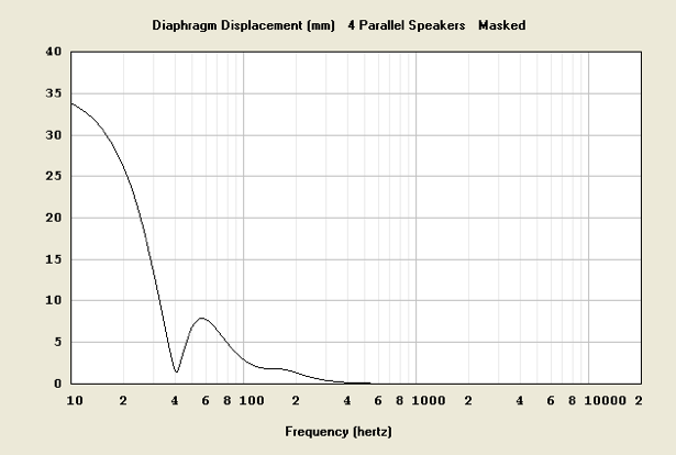

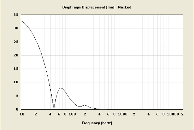

Multiple enclosure coupling applies to rear vented tuning, is this accurate?
Hi Dan,
As far as I know, the simulation model should be okay. I haven't seen any comparisons of predicted versus measured results for such systems, so I am not in a position to comment on accuracy.
Kind regards,
David
When simulating mulitples of a rear vented alignment, HR significantly lowers tuning of the total system.
Just throwing this out for discussion:
Is there a possibility that as in the case of multiple horns exhibiting different behavior due to mutual coupling there are multiple vents coupling?
In a single enclosure that can be the case when you have a multitude of vents. Rarely does the calculated length work when there are four vents on the same baffle plane. When there are multiple vents to achieve low vent velocity and the diameter is small due to baffle restrictions....
