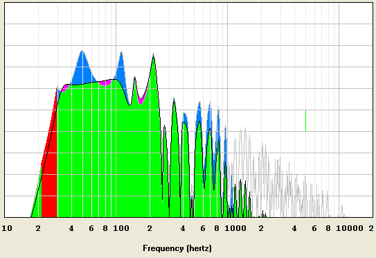

It's a combination of voltage (power) and excursion limitations that you input. So at different frequencies, different limits might apply creating an odd looking curve.
Think of it as two graphs in one. You set an Xmax limit, and a Voltage limit.
HR then adds Voltage at each frequency until one of the two limits is reached. If it runs out of Xmax first it is indicated by a Red line point. If it hits the Voltage limit first it is marked Black.

Hi NEO Dan,
Just to clarify, you actually set an Xmax limit and an input power limit. The voltage varies with frequency for a given constant input power because of the reactive nature of the impedance load.
See the Maximum SPL description on page 14 of the Help file for details.

Ahh thanks David,
Now I see what the tool is for, thermal vs displacement.
Which brings me back to my original point, which I didn't make very well.
Folks are using this tool for comparison of displacement limited power handling. But if I understand the way the tool works the simulation is that of a current source because it has no notion of nominal impedance and there for cannot "set" a voltage. In common usage speakers are driven by voltage source amps instead of current sources like industrial amps for MRI field coils, I've heard the behavior is quite different. If my understanding of the situation is not flawed the result we currently see is not representative of real world usage scenario's. For example when driver excursion and impedance are high at the same frequency; I belive the simulation would allow for much more voltage to be applied into the impedance peak to produce the desired "power" level this would potentially produce a false indication of over-excursion when in reality you'd have clipped the amp and run out of power.
As labeled the tool is valid, however I do think it is commonly misinterpreted and I think the option to toggle to a drive voltage mode of would be a more useful feature.

It is displacement limited power handling, only it is per frequency instead of per frequency response.
You can get a FR voltage limited graph using the rest of the HR program. It is really easy with the wizard. Just use the displacement graph, and add voltage until it hits the displacement limit, switch back over to Response, and there you go.
Run both, and you will find you get the same SPL:Voltage point using the lowest red frequency in the passband in the Maximum SPL graph, and following the voltage:displacement method.
The HR Maximim SPL method also gives you the EQ limits, the other version doesn't on its own.

Hi NEO Dan,
With Xmax set to a large value so that the Maximum SPL result is not displacement-limited at any frequency, the simulation will be that of a constant power source, not a constant current source. Try using the Sample tool with the Maximum SPL chart, to see how the voltage, power and displacement can vary at different frequencies.
The normal SPL response is generated using a constant voltage source Eg (assuming Rg = 0).

Neo Dan,
It isn't too hard. 😉
Here is an example:
You run a Maximum SPL on a DTS-10 with 1000w, and 15mm. Double click it, enter the frequency of the lowest red point in the passband, and you get 26.418v, at ~26 watts.
Then run through the wizard, and add voltage while looking at the displacement, and it will be the same. You can just enter the voltage into the box once you learn to trust it. 😉 If you Sample a couple different frequencies on this graph though, you will find you are still at ~26w at 19Hz still, but 305w at 35Hz.
These are the two graphs you get.
Does that make more sense?
To add to what McBean said, you would use a really high xmax to get a constant wattage source. Like 1000w and 99.9mm xmax (HR limit.)
It will look similar to the impedance curve if enough power and xmax is added.

So using it in a direct comparison to another Hornresp Maximum SPL graph at 1000w is somehow a problem?I fully understand how it works, and I don't like how you are using it:
See: http://www.avsforum.com/avs-vb/showthread.php?p=19983190#post19983190 and the discussion following it starting at: http://www.avsforum.com/avs-vb/showthread.php?p=19984458#post19984458 Specifically: http://www.avsforum.com/avs-vb/showthread.php?p=19986138#post19986138
I'm sorry you have issues with the tool, but that does not invalidate it. At no point do I see anyone stating that this is a straight FR graph, because it isn't.
An "unquailfied dump?" 😕 Are you sure you understand the graph?Way to take an unquailfied dump on the DTS-10 bro, are you proud? This is earth, we don't generally power speakers with constant wattage sources.

The Maximum SPL tool is not a good tool for comparison of SPL output.
How "big" would an amp have to be to supply 1000 watts into the DTS-10?
The coils of an actual DTS-10 are in series in this graph, but watts are watts right? So again, how "big" an amp would be requred to generate the displacement limited SPL indicated in your graph???
At best the Maximum SPL tool could be used to gage thermal cooling capacity if you could determine reliably the ammount of excursion required to effectivly dissipate a given thermal load. In that usage red is passing and black represents thermal failure.
