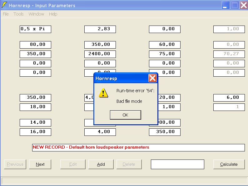

Hi David,
Horn response gives a error54 and the projects are gone.😕
Here the screen shot. What can I do about this problem? It is also not possible to make a new project.

@Helmuth
Could you supply some more information about the OS, the filesystems, etc.. on which you ran hornresp? Semms it´s having trouble saving it´s data. Is hornresp stored on the harddisk or are you running it from a USB-Drive?
I have osx with virtualbox and windows xp. HORNRESPONSE is on HD and it shout dynamically increase disk-size needed for virtual operating system.
hm... is your virtual drive NTFS or FAT?
Fresh Win XP Install?
Is your Installation in the default directory c:\hornresp ? Is it the most recent version?
Try re-installing it in the default directory

I am trying now I can not open david his download place.
FWIW, I had no problem initiating a download just now and have never had a problem putting HR into a different location, be it a drive an/or in a My Documents folder whether W95,98,XP. I'm curious though why your screen shot of HR shows no field definitions or Nd, TH, etc. hot link next to the number of drivers field.
Hi Helmuth,
I gather from the post below that you have now resolved your Hornresp problem. Is this correct?

Yes it works again. And thanks again for sharing this great program.
I have re-installed it. Only strange it crashed and lost projects.

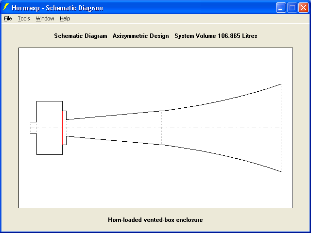

Would it be possible to make a feature to simulate a front loaded horn with BR-volume in hornresp.
Regards, Helmuth
Hi Helmuth,
Not sure that I understand - by BR do you mean bass-reflex?
If so, then Hornresp can already model a horn-loaded vented-box enclosure. Note 11 on page 20 of the Help file refers.

I could not understand the help file. I saw a plot of a br-tuned one then I did find the two fields to use.
Thanks for the info.
