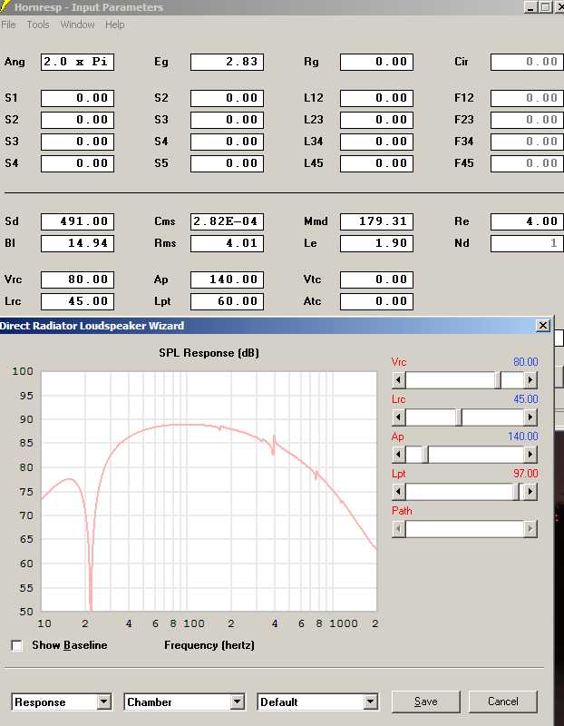

I tried comparing the results of my vent length equation (see The Subwoofer DIY Page - Port Calculations) against HornResp's predictions by simming a 80 litre volume that's being tuned to various frequencies with a 140cm^2 vent.
This first table shows the predicted lengths using my vent calculation:
20 Hz - 121.5 cm
30 Hz - 48.6 cm
40 Hz - 23.4 cm
50 Hz - 11.2 cm
60 Hz - 4.8 cm
70 Hz - 0.9 cm
This second table shows the lengths predicted by HornResp
20 Hz - 118.0 cm
30 Hz - 51.6 cm
40 Hz - 27.0 cm
50 Hz - 15.0 cm
60 Hz - 8.8 cm
70 Hz - 5.2 cm
It looks like HornResp is predicting longer vents are required to achieve the same Fb (except for 20 Hz). The difference between the lengths seems to vary from 4.3 cm down to 3.0 cm @ 30 Hz, suggesting that the end-correction factor that HornResp is not only slightly different, but also somewhat frequency-dependent.
Curiously enough, if my equation is predicting vent lengths that are longer than required (see vent tuning that suggests the calculated lengths might be just under 20% too long), that means that the vent lengths predicted by HornResp might even more inaccurate...
Hi Brian,
You obviously used a release of Hornresp older than Version 28.00 when doing your comparisons 🙂.
Kind regards,
David

Hi Brian,
Kind regards,
David

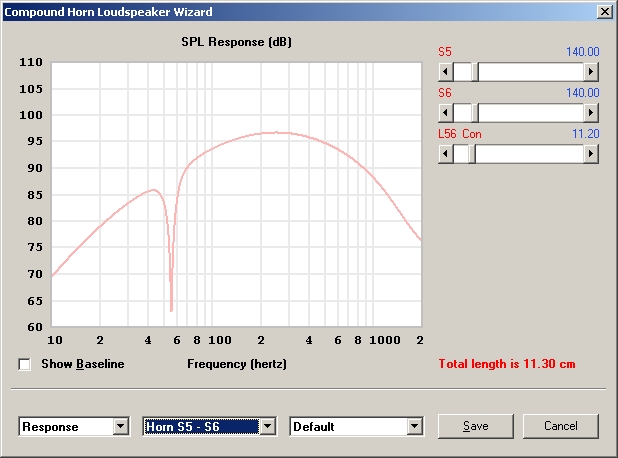

Actually I'm using version 28.00, but I was using a compound horn config and S5-S6 set to 140 cm^2 to simulate the "vent" (see images below). Shouldn't this produce the same results as using Apt and Lpt? The schematic is basically identical.

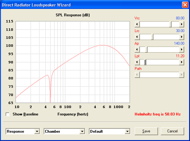

Hi David,
When trying to duplicate Brian's results from Post #1788 the nice little "Helmholtz freq is ...Hz" (your Post #1790) disappeared when going from Lpt 96.90 to Lpt 97.00. This is with the newest version of Hornresp (2830-110403). In an older version (2830-110124) this was the point where this display changed to "Ltc is 0.00cm".
Hadn't noticed that before.

I was using a compound horn config and S5-S6 set to 140 cm^2 to simulate the "vent" (see images below). Shouldn't this produce the same results as using Ap and Lpt?
Hi Brian,
Prior to Version 28.00, the results were the same. A tube specified by Ap and Lpt was assumed in all cases to act as a cylindrical horn, rather than possibly as a lumped air mass. Unfortunately this meant that predictions for conventional bass-reflex systems in particular, were not entirely accurate.
To address this shortcoming Hornresp now checks the Ap and Lpt dimensions and subject to certain conditions being met, assumes that the air in the tube is acting as a lumped mass. In such cases a Helmholtz frequency value will be given. Where the conditions are not met Hornresp assumes that the tube is acting as a cylindrical horn, as before.
When S5 and S6 are used, Hornresp assumes that the tube is always acting as a horn regardless of the S5, S6 and L56 dimensions.
As you have observed the results are different for the two cases.
With a bit of work I could probably make it so that the results for the two scenarios are consistent again, with the tube acting as a lumped mass rather than a cylindrical horn where appropriate - independent of how it is specified - but I am not sure that it is really worth the effort.
I guess I will have to think about it 🙂.
Kind regards,
David
Hi Oliver,
This is because the tube length relative to cross-sectional area is such that the tube now acts more as a cylindrical horn than as a lumped air mass - see my reply to Brian above.
I decided to remove the "Ltc is 0.00cm" message from this view because it is not really relevant and could be confusing to some users, since the throat chamber sliders are not present.
I'm impressed - you are very observant indeed 🙂.
Kind regards,
David

Hi Brian,
Kind regards,
David
