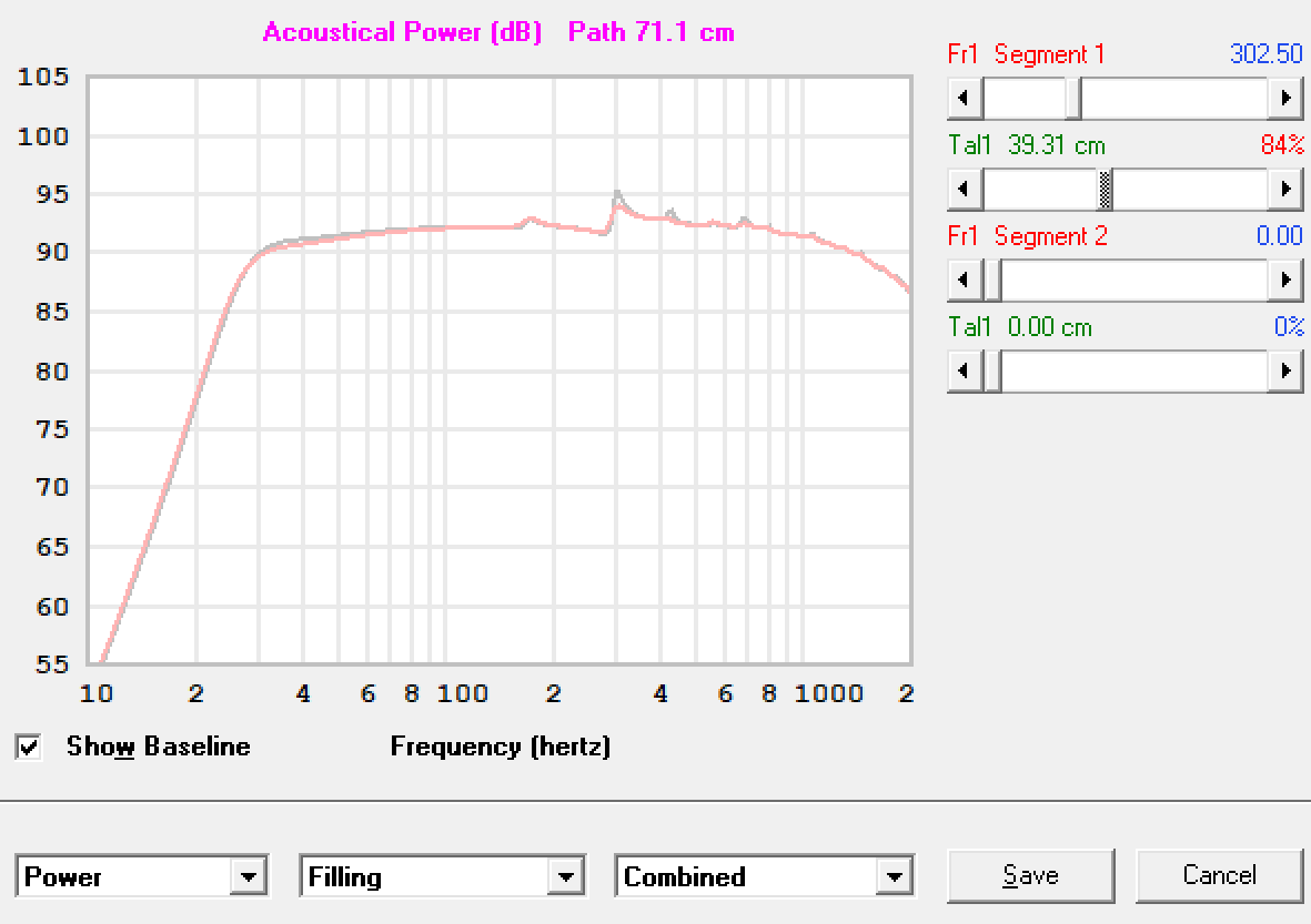

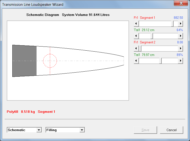

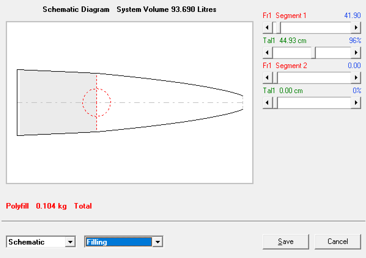

How to understand Fr1 Segment 1 and tal1 practically?
Let's say I have 20-30mm sheep wool. Only overall stuffing weight matters?
Tapered TL example.
Others might suggest too but as there is a little residual ripple, you could try incrementally adding fibre up to say 75% of the line length until you achieve an optimal response. you could build the enclosure using this amount and tweak to your listening taste or measurements. I found it needs a bit of iteration.
In the test example, 64% of the length of segment 1 (starting from the closed end) is filled with absorbent material having an airflow resistivity of 882.50 mks rayls/m.
METHOD 1 - Given absorbent filling material airflow resistivity and density data
A quick Google search reveals that the airflow resistivity of sheep wool varies greatly, depending upon the packing density:
Wool with a density of 10 kg/m^3 has a resistivity of 500 mks rayls/m.
Wool with a density of 100 kg/m^3 has a resistivity of 15000 mks rayls/m.
As a starting point, assume that the relationship between the wool density and airflow resistivity is linear so that for a resistivity value of 882.50 mks rayls/m the density is:
10 + (882.5 - 500) * (100 - 10) / (15000 - 500) = 12.37 kg/m^3.
The absorbent filling material in segment 1 has a volume of 32.148 litres [*] which means that the material weighs 0.40 kg if the density is 12.37 kg/m^3. The weight of 0.40 kg is a little less than the 0.518 kg shown for an equivalent volume of Polyfill, which means that the wool weight is probably about right given that it is likely to be less dense than Polyfill.
The simulation will show how the response is affected by adding filling material, but in practice the accurate flow resistivity value of the material being used is unlikely to be known. Most users just progressively add or remove filling material until the desired response as simulated is obtained.
[*] While the value is calculated and used internally, the volume of absorbent filling material in each segment is not currently displayed as an output. If it is not too much work to add, it will shown as an output in the next update.
METHOD 2 - Given Polyfill weight data only
Use the Polyfill weight as a starting point regardless of the actual absorbent material being used, and progressively add or remove filling until the desired response as simulated is obtained.
METHOD 3 - Given no absorbent filling material data
Progressively add or remove filling material until the desired response as simulated is obtained.

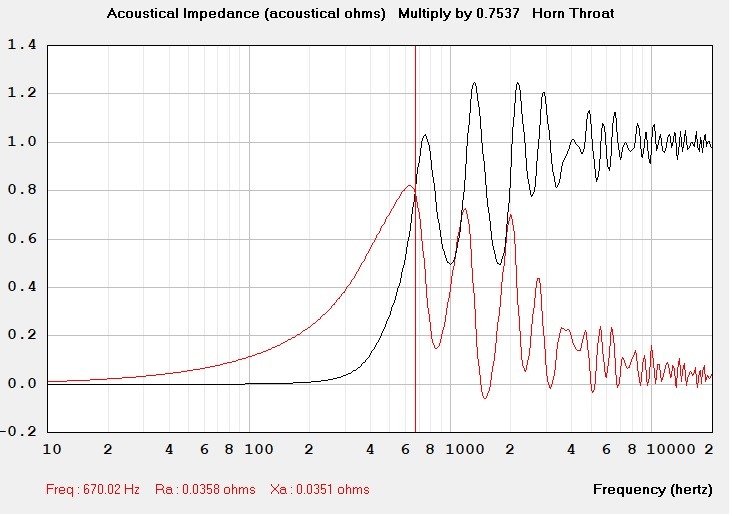

Hi deanznz,
Thanks for the feedback. The Ra and Xa values should be as you say, so something is definitely wrong somewhere. The interesting thing is that the values for the test designs I checked are all correct. Could you please export the record you are using and post the data file here, so that I can replicate your results and hopefully track down the problem.
Kind regards,
David
No need to post the record thanks, I am pretty sure that I have found the problem - it will be fixed in the next update.
Just to be sure though, could you please confirm that your record uses stepped segments and/or is a CH2, CH3, OD2 or paraflex horn type configuration.
