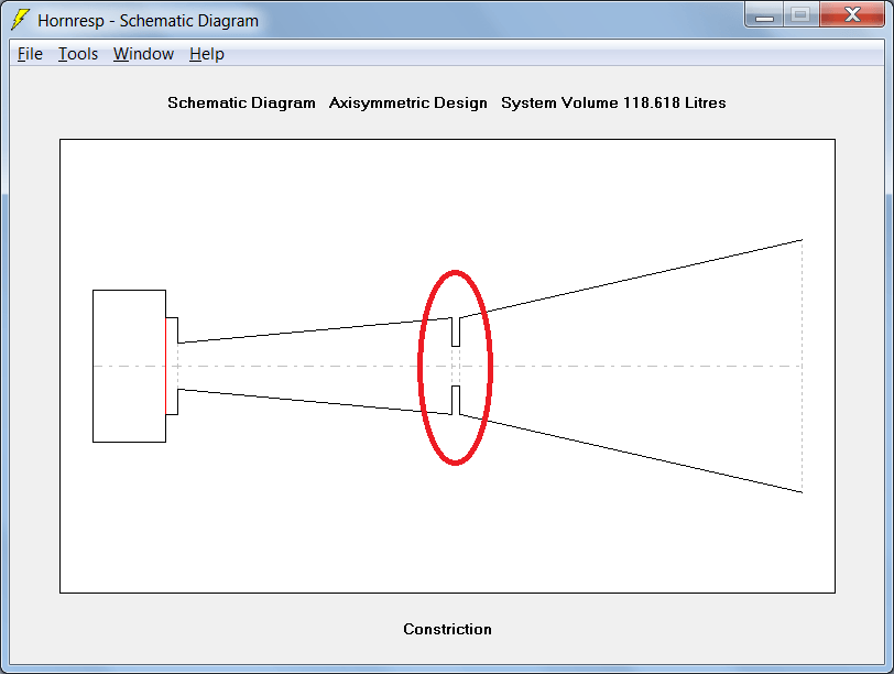

If you just want to model the bass component of the MEH system, independent of the output from the higher frequency drivers, then the general design you show is probably as close as you are going to get.
It shouldn't make a material difference but stepped segments could perhaps be used instead, to give something like the attached (not to scale).
An advantage of using stepped segments is that an additional segment becomes available to more accurately specify the overall horn profile, if so desired.

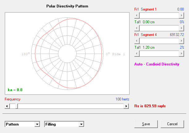

Given, the thickness is already calculated by the auto cardioid function.
And I missed this! Damn, double damn. Auto Cardioid. I am about to work on one of these!

For a given rayls value calculated by Hornresp, is there an algorithm/rule of thumb to convert it into a perforated board of given number of uniformly distributed holes and hole size?
Using iterative techniques it should be possible to come up with a solution at a single frequency, but it would be of little practical use.
For example, given:
Rs = 554.35 mks rayls
S1 = 500 cm^2
Tal1 = 0.8 cm
Hole diameter = 1 cm
Then the solution at 1000 Hz would be:
Hole centre to centre separation = 2 cm

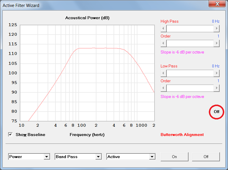

The Filter Wizard window opens, but none of the parameters on the right side can be adjusted.
Hi Seth 001,
Double-click the Off label to switch on the Active Filter.
Kind regards,
David

OMG!!! That was easy. Thank you so much David, for everything!Hi Seth 001,

CORRECTION - Post #13,604
Rs (resistance) = 7.19 mks rayls.
My thanks to bolserst for making me aware of the error.
Zs (impedance) = 554.35 mks rayls.
