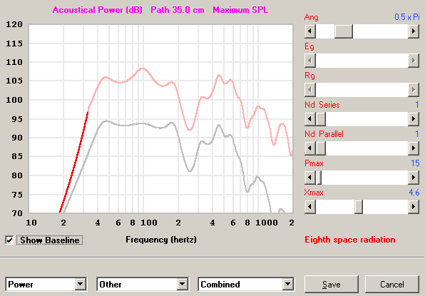

1. How to ensure that the excursions are within Xmax?
2. What is the safe air velocity at the terminus of the TL?
3. What are the final check points to be enured before committing the design on wood?
Also, please suggest if there are any better alignments possible for this driver.
Use of the loudspeaker wizard in to Tools menu would help with Q 1 and 2. Inputting the path distance (between speaker and terminus) and some filling will make a smoother response versus some bass roll off and gives an idea of the amount of filling to experiment with. Q2 Sorry I do not know for certain the absolute levels but there are opinions out there. You could simulate a range of enclosure types using the HornResp Input Wizard, considering use as a subwoofer and check which response looks best compared to size etc. Or if you go with a TL, are you happy with the enclosure dimensions and where folds will end up.

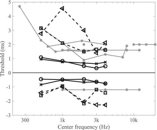

Taking this a step further I wonder if it is really necessary to time align a tweeter crossed at 5Khz or if a simple 2nd or 3rd order passive filter will do. The mid-high horn delay is about 1ms on the tweeter so audibility is questionable/boarderline.
Well, 1 ms = ~1.13 ft, so based on this interactive hearing chart and IME back in the late '60s - mid '80s using my then youthful female's acute hearing it is, though not me and my already damaged hearing from a wide range of high SPL sources, i.e. YMMV, etc..
@GM, I am discussing sensitivity to group delay.
Comparison of the previously reported group-delay thresholds (gray lines) and the results of the latest study (black curves).
The results indicate that the audibility thresholds for local group-delay variation are less than ±1 ms for the most critical signals, and approximately 1.5 ms to 4.5 ms for a local positive group-delay peak and between −1.0 ms and −2.3 ms for a local negative group-delay peak for real-life signals.
There is no report for frequency below 500Hz in the more recent study, however based on previous studies the threshold at 200Hz is probably above 5ms.
The study can be downloaded at this link
Based on this study I am questioning the actual requirement to address Group delay by means of DSP or allpass filters in the described scenario with the following GD figures, which are either below or on the edge of the threshold.

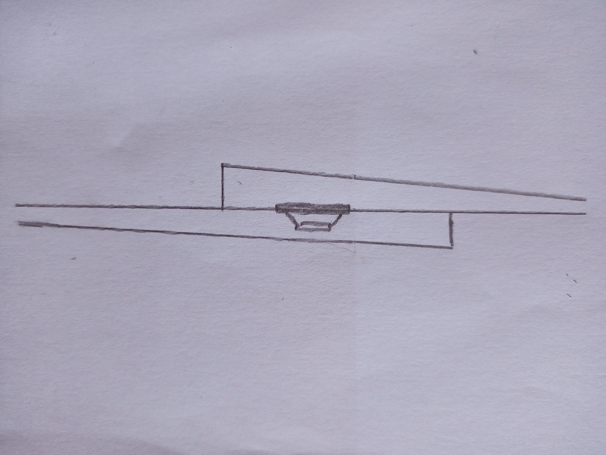

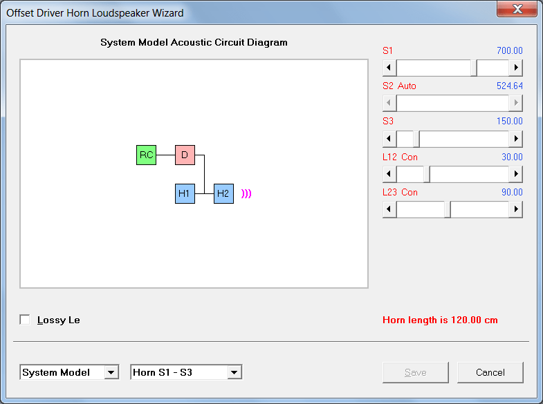

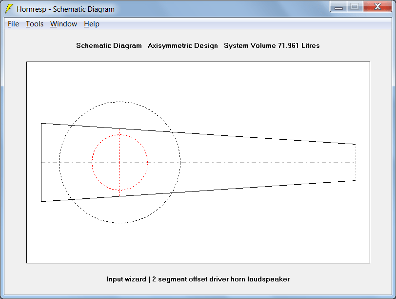

I'm not sure what you mean by hybrid bandpass-transmissionline, and I definitely don't understand what the "like this" example is showing
Looking at my post, i don't understand it either ;-) I tried to sketch it with ascii, but the code-block somehow made a linebreak it seems.

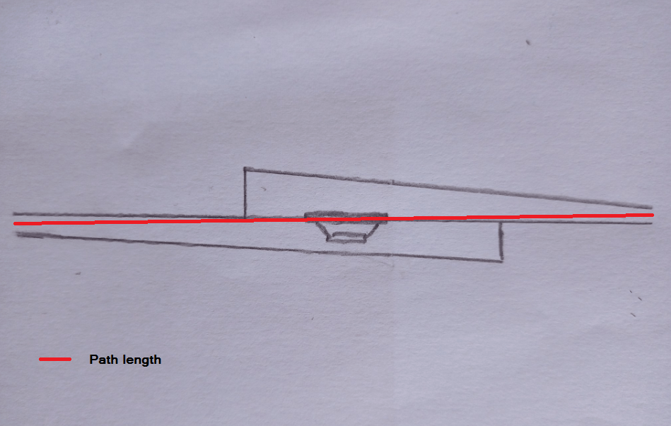

I meant something like the sketch below, a 6th-order bandpass with transmissionlines as vented enclosures.
A 4th-order bandpass with a transmissonline might also be interesting.

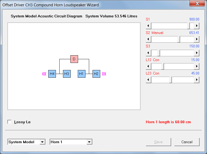

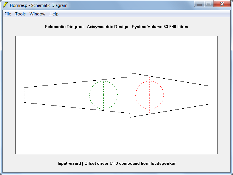

Maybe ‘Ch3‘ mode with ‘path’ set at the distance between vent exits?
As Booger weldz has suggested, use the CH3 configuration shown in Attachments 1 and 2, with the path length being the distance between the two outputs as shown by the long red line in Attachment 3.
Use the OD configuration with rear chamber, as shown in Attachments 4 and 5.
Thanks very much for this info.
