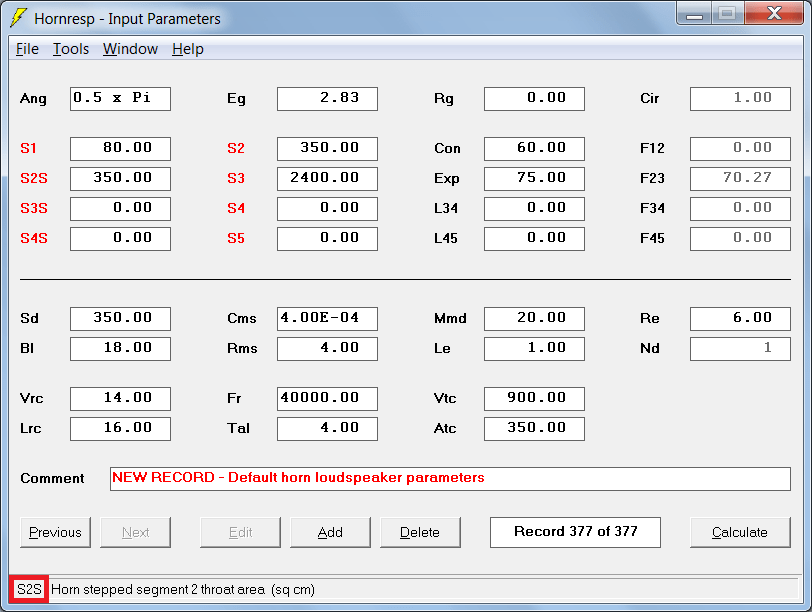

Thank you David, and what value should be entered in the Vel box ?If driver parameter values are not available then use the constant diaphragm velocity (Vel) option.
(Double-click the Eg label in Edit mode to select the Vel option).
After switching from Eg to Vel it defaults at 0,10 (with an Eg value of 2.83). The lower half of the window (TS parameters) must all be set to zero ?

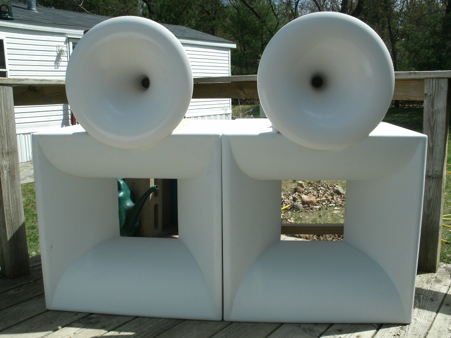

With regards to horns with a curved mouth profile, such as the TAD horn attached above, I assume one should consider the round surface as the actual mouth surface and what would be the benefit of that profile on a mid-bass horn ?
That round profile is commonly found on mid-range horns with a 600hz lower cutoff, so I think it should make sense also on a mid-bass horns which extends to such frequencies (or higher).

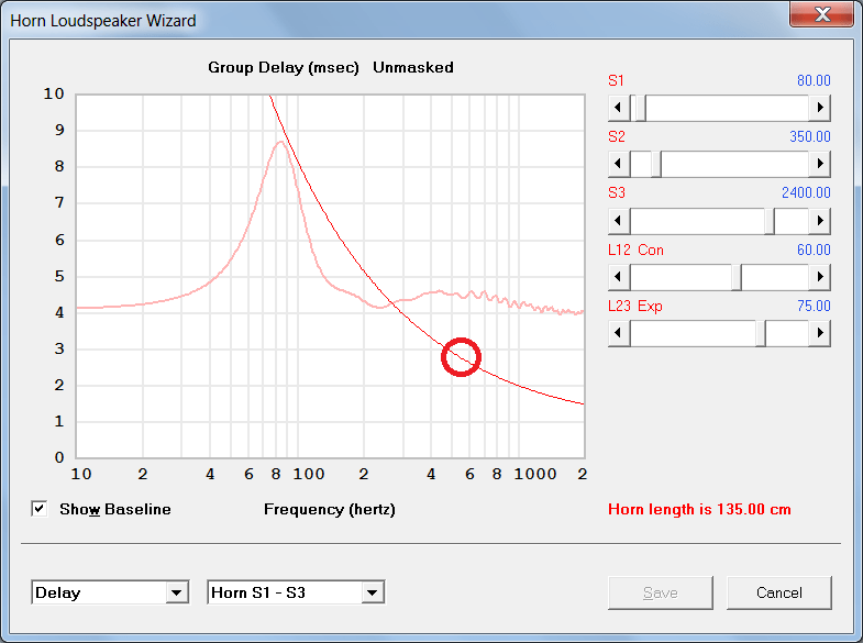

And is there anything else that would require further optimization before I purchase the drivers and start the woodworking ? What about delay and phase ?
Check the delay curve against the Futtrup curve, and make sure displacement stays acceptable.

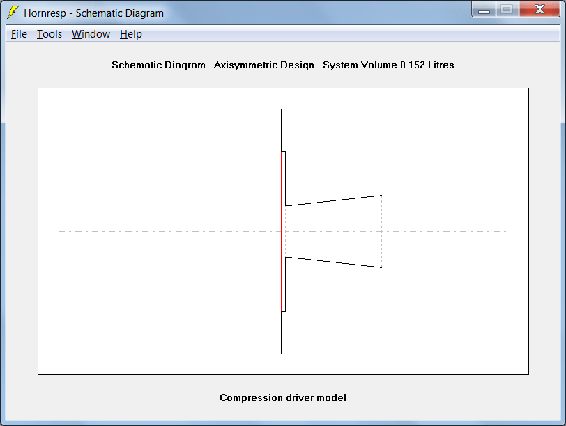

More in general but still with regards to TS parameters....how is one supposed to go about modeling a Mid or High frequency horn based on a compression driver, since for those no TS parameters are available ? Nor they can be measured with REW or DATS since it impossible to add a weight to the cone as it is done with cone speakers.
As mentioned before, it takes some specialized measurements to get it right. There are some papers about compression drivers that give values, but usually you can't get them.
Of course you can, how else do you think they are designed? 🙂I don't believe you can model compression drivers.
At Celestion we used FEA for that, mainly. But I also did work on lumped parameter modelling, and measuring the driver transfer matrix (voltage and current in, pressure and volume velocity out, this can be pretty accurate, and I have gotten within 1dB with a good horn model. This method is used for the frequency response calculations in the Celestion Horn Wizard, although the horn model there is fairly simple to optimise speed).
As for lumped parameter modelling, I measured the mechanical parameters in a vacuum chamber using a Polytec velocity laser, then added the acoustical model on top of that using the in-house modelling software we had. The results were quite accurate below the diaphragm breakup frequency. Unfortunately this is methods out of reach for most hobbyists. My point is that it is possible and can get pretty close.
Yeah, I meant by folk like me using Hornresp, not having access to published T&S data for any driver we chose to want to model.
The default value of 0.10 metres per second is usually sufficient for most purposes.
Using a different value will simply change the power response and diaphragm displacement levels.
When the Vel option is selected the driver parameters are disregarded. The existing values do not have to be adjusted in any way.
As far as Hornresp simulations are concerned, the plane rectangular surface just before the upper and lower curves commence should be considered as the horn mouth (this also defines the horn length).
Not sure that there would be much practical benefit at those frequencies, but perhaps try Googling 'radial horn' to see if you can find a definitive answer.

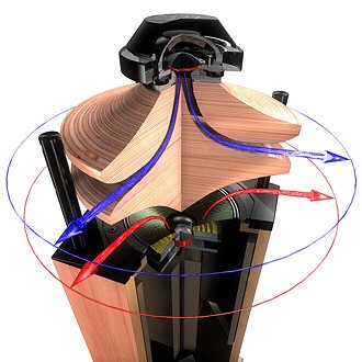

If one considers an omnidirectional horn such as the one attached below, it is obvious that the horn lenght is dictated by the horn radius and that the surface of the throat is necessarily the surface of the cilinder that spans from the upper to the lower "lip" of the mouth.
This same approach can be applied to multicellular and sectoral radial horns, which are basically a number of small horns arranged in an array aimed at improving dispersion and increasing the overall mouth surface to reproduce lower frequencies. So, the lenght in multicellular/sectoral horns is actually dictated by the radius while the surface is the sum of the "small horns" surfaces. A radial horn is not much different from a multicellular/sectoral horn at least with regard to lenght (=radius) and surface of the mouth.
I wonder if these considerations can be taken into account (and how) in order to model a radial horn in hornresp, or even an omnidirectional, which I have been thinking about since a while.

But when modelling a horn for a compression driver, the driver parameters aren't that helpful, since you can't adjust the compression ratio or compression cavity volume. The rear chamber volume can be adjusted, but it usually doesn't matter much, since you wouldn't use the horn close to cutoff anyway.
The most important parameter would be the input area and length of the internal flare, from the phase plug slits to the driver exit, to make sure you don't create too strong standing waves in the driver-horn combination.

By mid bass I thought that you had in mind something like the square cross-section horn design shown below, but with the top and bottom panels extended to form curved "lips". In other words, a relatively short horn with a relatively large throat, having a cone type driver.
Even though it could be argued that the above horn design has the general profile of a radial horn, at the frequencies involved it would not really act like one. That is why I said that I was not sure that the curved lip extensions would be of much practical benefit given the intended frequency range.
A mid range or high frequency radial horn design on the other hand, particularly if using a compression driver, would normally be analysed with the curved surface being taken as the mouth area, as you assumed. The same principle would apply to a mid range / high frequency multi-cellular or sectoral radial horn.

In Hornresp, this can be specified to a reasonable degree using the throat chamber and throat adaptor, as shown below.The most important parameter would be the input area and length of the internal flare, from the phase plug slits to the driver exit

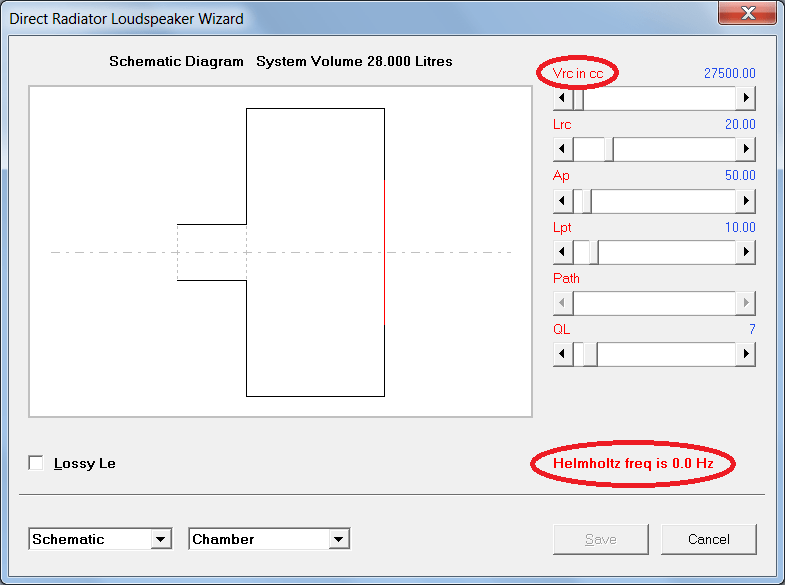

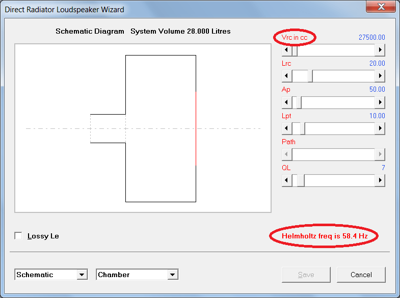

Hornresp Update 5460-230508
Hi Everyone,
CHANGE
A minor change has been made to the message displayed in the status bar panel at the bottom of the Input Parameters window when the mouse pointer is moved over the throat area of a stepped segment. As an example, when the mouse pointer is moved over the throat area of stepped segment 2 the message now starts with S2S as shown below, rather than with just S2 as was the case previously.
BUG FIX
When Vrc was specified in cubic centimetres the Helmholtz resonance frequency shown in the Loudspeaker Wizard was not correct:
This bug has now been fixed:
Kind regards,
David

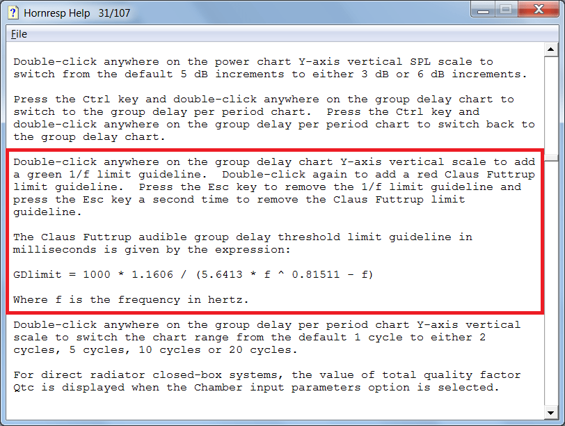

@ Kolbrek, not sure what you mean with this.Check the delay curve against the Futtrup curve, and make sure displacement stays acceptable.
I googled Futtrup curve and the only relevant result is some papers published by Futtrup which require AES membership to be accessed.
If you want any AES papers I can get them.
Mark
See http://cfuttrup.com/blogspot/Book_05_Futtrup.pdf, Futtrup describes it as "This chapter is somewhat like a "layman's" version of the AES paper I wrote in 2011, targeting a nontechnical audience, (almost) without the math. It adds historical background and some idea about how to ensure a nice impulse response by using Group Delay." So this is where the group delay curve comes from, it was not in the original AES paper.@ Kolbrek, not sure what you mean with this.
