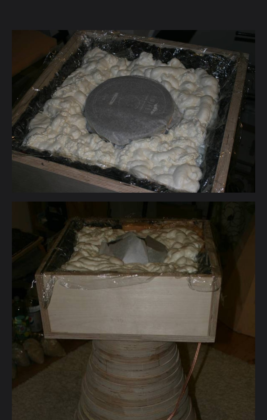

I found driver box volume tuning useful.
I used expanding foam (have to be very careful with it), safely contained by baking parchment and Clingfilm, can really cut volume down.
I'd used sand bags before - very heavy.
The foam was then trimmed to give the volume reduction required.
I in-room measured my way forward.
Here it is before it fully expanded.

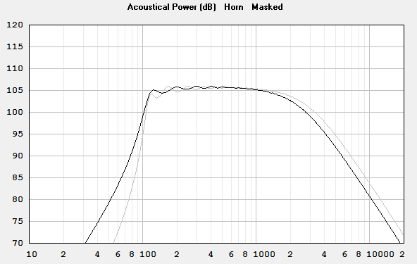

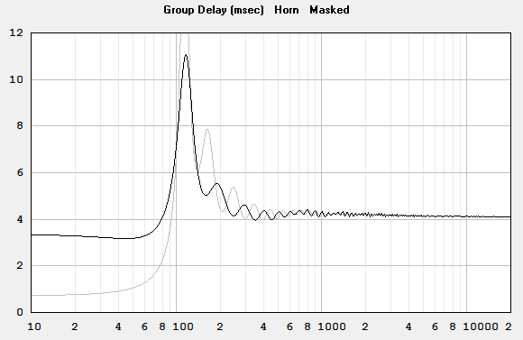

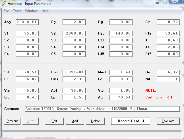

I remodeled the horn based on the "tweaks" that Kobrek suggested.
I doubled the throat and adjusted Vrc to realign the low upper cutoff corner and smoothen the ripples. The power response is as good or better than the previous simulation with the smaller throat.
However, adjusting the lenght did not result in relevant variations, at least with regard to the power response.
Making the horn shorter resulted in a higher, 150ish cutoff (bad ?) and a higher Cir (good). Making it longer caused bigger ripples (which could probably be fixed by a larger Vrc), and an even smaller Cir (0.6x) which appears to be too low.
Since the response is good enough with the previous lenght of 140cm i kept this value, also to keep Cir within 0,7 as suggested by Kolbrek. I can of course make the horn shorter if this is necessary for impedance matching and if the higher cutoff doesn't influence too much the phase shift at crossover point.
@ Kobrek I am not sure what you mean by "impedance matching". Matching the impedance curve of the driver to the horn (acoustical or electrical ?) impedance ?

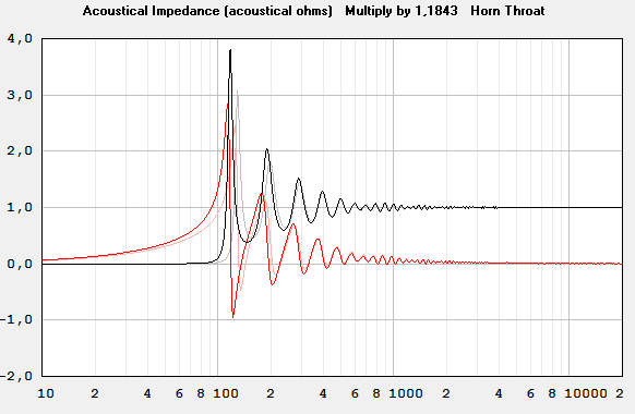

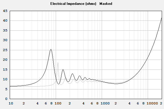

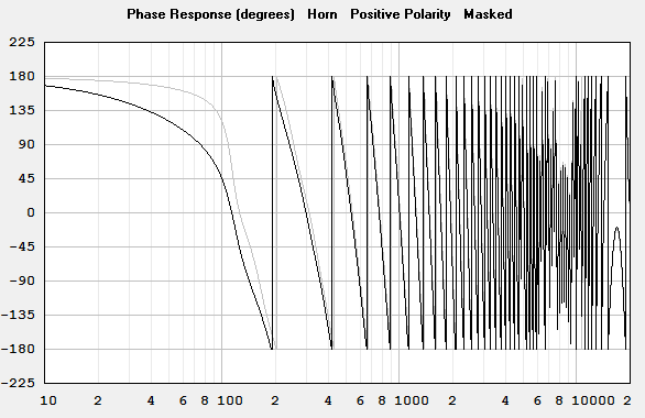

Attached below the whole set of diagrams for the "140/2800 - big throat" compared to the previous "140/2800" I also attach the impedance curve of the driver.

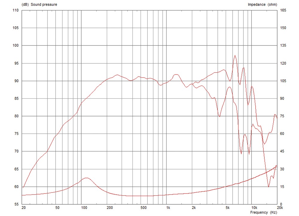

With regard to the driver, as I think I mentioned in a previous post, the only reason why I used this driver (Celestion TF0510) is because it results in a much smoother and extended power response than all the others I tried in hornresp, that is the whole B&C, Faital Pro, Beyma and Celestion product range (5-6" midrange). If you believe there are more drivers that would be worth trying and that may offer a better result, I will run more simulations.
In the attached diagrams the bold pattern is the new "big throat" horn. Mouth size is the same (2800) as I would not exceed the 70x40cm dimension.
With regards to group delay, I am trying to keep it at/below 5ms at 200Hz, since that seems to be the threshold of audibility of the human hearing at 300hz, according to the more recent studies published on the www.

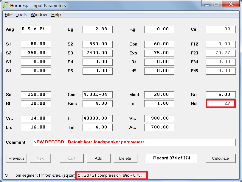

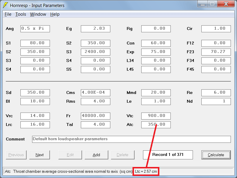

Another question popped up in regard to Atc
Hornresp models the throat chamber as a cylinder of length Ltc, cross-sectional area Atc and volume Vtc (Atc x Ltc) The typically used setting for Atc is Sd x number of drivers.
For a given Vtc, the value of Atc is sometimes adjusted to make the value of Ltc better match the actual physical design of the system. It is really a judgement call on the part of the user to decide what values to specify for the throat chamber to best reflect the design.
Moving the mouse pointer over the Atc input box shows the value of Ltc for a given Vtc and Atc in the status bar panel at the bottom of the Input Parameters window.
If the 'chamber resonances masked' option is selected then the throat chamber is treated as a pure acoustic compliance and the results will be dependent on the value of Vtc only - it doesn't matter what value is used for Atc (or Ltc).

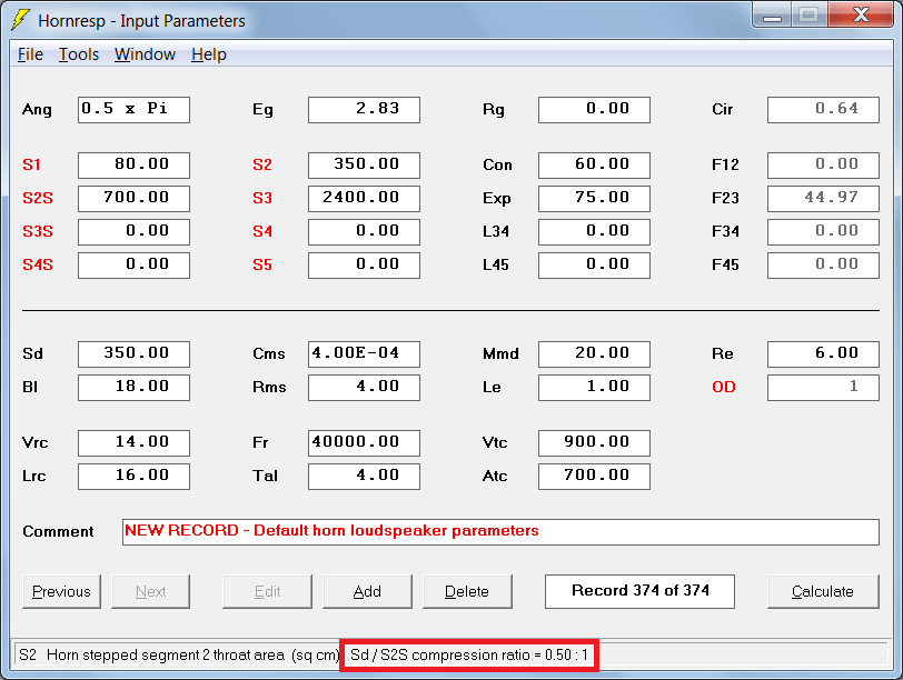

I understand this concept can be a bit confusing and unfamiliar, since usually when we talk about impedance in connection with loudspeakers, we mean electrical impedance. But there is also mechanical impedance and electrical impedance, and it is possible to draw an equivalent schematic that combines electrical, mechanical and acoustical parts as simple components. The first paper I linked to shows this schematic.Then you can use the Thévenin theorem to simplify a circuit into a source with an internal impedance Zs that drives a load impedance ZL.
It can be shown that the condition that results in maximum power in ZL is Zs = ZL. Also, if ZL varies, the variation is the least around Zs = ZL.
For a horn loudspeaker, ZL is the acoustic throat impedance of the horn. Zs is made up from the mechanical and electrical impedances of the driver. While there is a connection between Zs, ZL and the electrical impedance at the driver terminals, the connection is not straightforward, and you can't use the electrical impedance to check impedance matching. Also, since the horn throat impedance varies quite a lot, the best we can do is to match the driver to the average of the throat impedance over a given frequency range. This is done by adjusting the Sd/St ratio in relation to BL and Re. The easiest is actually to use the equations for impedance matching from my blog. There's also a book 🙂
Just to clarify - I am pretty sure that Bjørn meant to say: "But there is also mechanical impedance and acoustical impedance," 🙂.

I agree that is not an equation 😀 and I did not realize that in suggesting to double the size of the throat you had already considered that calculation based on the driver's parameters.
So I assume that is supposed to be the "starting point" for any horn model, while the rest of the data (horn mouth. lenght, VRC etc. can more or less be adjusted in order to obtain a flat response in the power response window.
In this case, can electrical and acoustical impedance diagrams be disregarded as the matter has already been taken care of in a different, more specific manner ?
And is there anything else that would require further optimization before I purchase the drivers and start the woodworking ? What about delay and phase ?

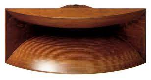

I really love old Altec muticellulars and TAD style "exponentials" (probably not "really" exponentials) for mid highs 1 to 5k-ish, , as well as the JBL "butt cheecks" biradials both for midhighs and highs. I'm not a fan of bullet tweeters, possibly due to the directivity vs biradials.
It would be interesting to understand more about the curved mouth profile of those horns, how it impacts on the response and if it can be considered as a way to improve the mouth surface 10-15% without making the horn actually larger.
I believe the dispersion figures must be at the base of the beatiful broad soundstage and pinpoint imaging of those horns, which I find somewhat missing in other profiles. Especially in rooms which are not heavily treated, so I guess it MUST have to do with dispersion.

Hornresp Update 5460-230501
CHANGE 1
The functionality of the compression ratio calculation feature has been refined to more correctly take into account stepped segment designs. Previously with offset drivers the mouth area of segment 1 was used in the calculations, now the throat area of segment 2 is used instead.
CHANGE 2
The compression ratio message now includes the number of drivers. The message for a front loaded horn system with 2 drivers for example, now shows 2 x Sd / S1 rather than just Sd / S1. The calculated compression ratio value itself has not changed.
CHANGE 3
Minor amendments have been made to the Input Parameters Window section of the Help File to take into account recent update changes.
Kind regards,
David
