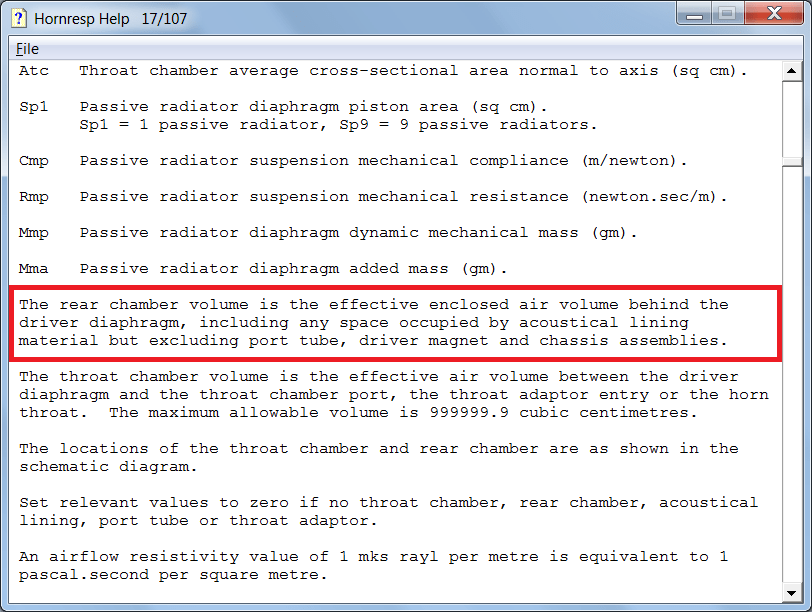

I also wonder if Vrc is the volume of the chamber + the volume of driver (cone + magnet).
Vrc is the effective enclosed air volume. See attachment.
