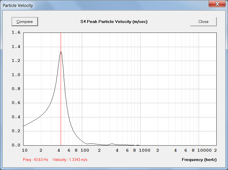

Hello David,
I had a small free time today and I played a little with the new CH2 model, While I still wasn't able to implement this variant using FreeCAD, I think I can confirm the benefit of having it for what concern the possibility to reduce noise from the port.
See attached feedback inside PDF file.
Thanks again to make this model possible.
Hi Marcelo,
An excellent analysis!
Your expectation that the particle velocity will be increased at the S4 constriction in the CH2 model is correct. The value is also close to that for the CH1 Horn 2 throat, as you assumed - see attachment.
Many thanks for the feedback, I will certainly see what can be done about the things you have identified, and will try to also include the S4 velocity and pressure values for CH2 in the next update (not today's).
In the PDF file, the heading for the second system model should read CH2 not CH1... 🙂.

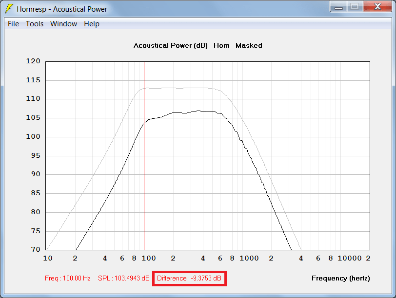

Hornresp Update 5460-230329

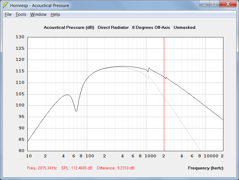

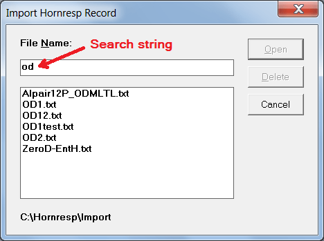

Hi Everyone,
CHANGE 1
When two sets of acoustical power or acoustical pressure results are being compared and the chart is clicked, the difference in decibels between the two traces is now included in the sample information, as shown in Attachment 1.
CHANGE 2
The functionality of the File Import / Export form has been enhanced to include an integrated file search and "shortlisting" feature, as shown in Attachment 2. This makes it easier for example, to find the required file to import if the Import folder contains a significant number of files.

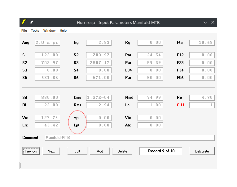

Hi Marcelo,
Do you happen to know the sequence of events that leads to CH1 being shown with Ap and Lpt instead of the correct labels Ap1 and Lp?
I have been trying to replicate your screenprint attached, but keep on getting Ap1 and Lp.
Thanks,
David
Hello David,
Probably it was a mistake from my side, in general I modify existing macros files to generate new one, so eventually it doesn't match properly Hornresp model, witch is this case.
AP and Lpt is generate from in the FreeCAD macro while creating the *.txt file, so while importing from Hornresp it abuses Hornresp exploit 🙂 Some errors Hornresp can detect and don't import data so it warn me to looking for incorrect data.
That explains it then.
I checked the code and the only way that it can possibly happen is if the data in the file record itself is manually changed by the user, which in effect is what you have done.

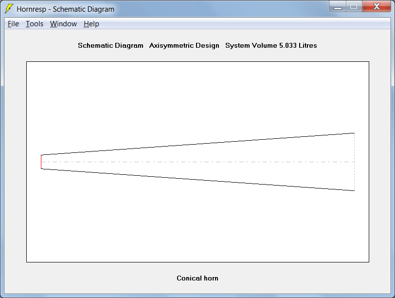

Hello!

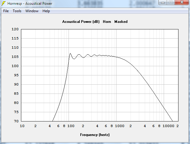

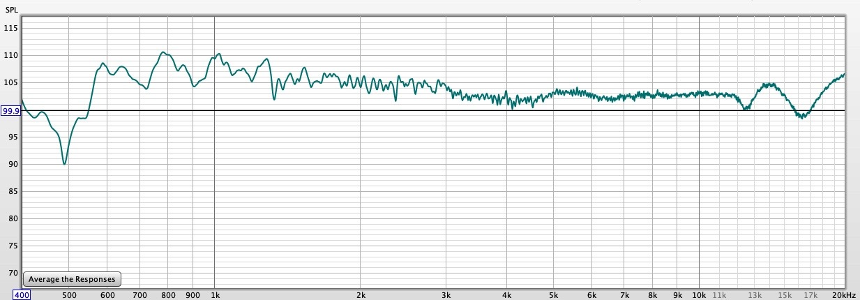

I just downloaded Hornresp in order to simulate a midrange front loaded horn.
I thought I'd start off with modelling a horn that I've already made to get going with the program.
Now, this is a horn with a dome tweeter, which I understand can be a little tricky. The flare is very simple though -it's just a one section 11 degrees conical horn about 76cm long. In reality it has a kind of a lip section at the end which does smooth out the response a bit below 3kHz. I can take a measurement without the "lip", but I want to try to get in the ballpark with the simulation first.
I was wondering if you could help me get closer to the real world results. Perhaps some parameters are way off, or I need to change some settings?
I changed the front (adapter?) volume or whatever it's called to 0. I don't know the specs of the rear chamber inside the tweeter of course, so I just put in some small numbers there.
The real world measurements (1st pic) are made with REW. It has no smoothing and it has the maxiumum (500ms) window, because my room is so highly damped (and the horn so directional) that windowing only makes the resolution worse.
The absolute SPL is not calibrated. The level is probably much lower in reality.

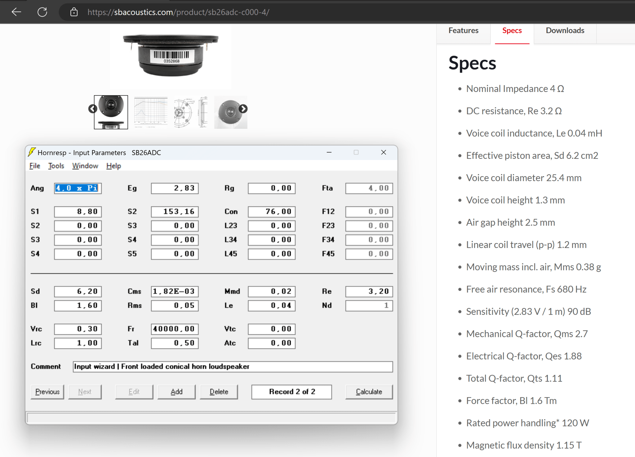

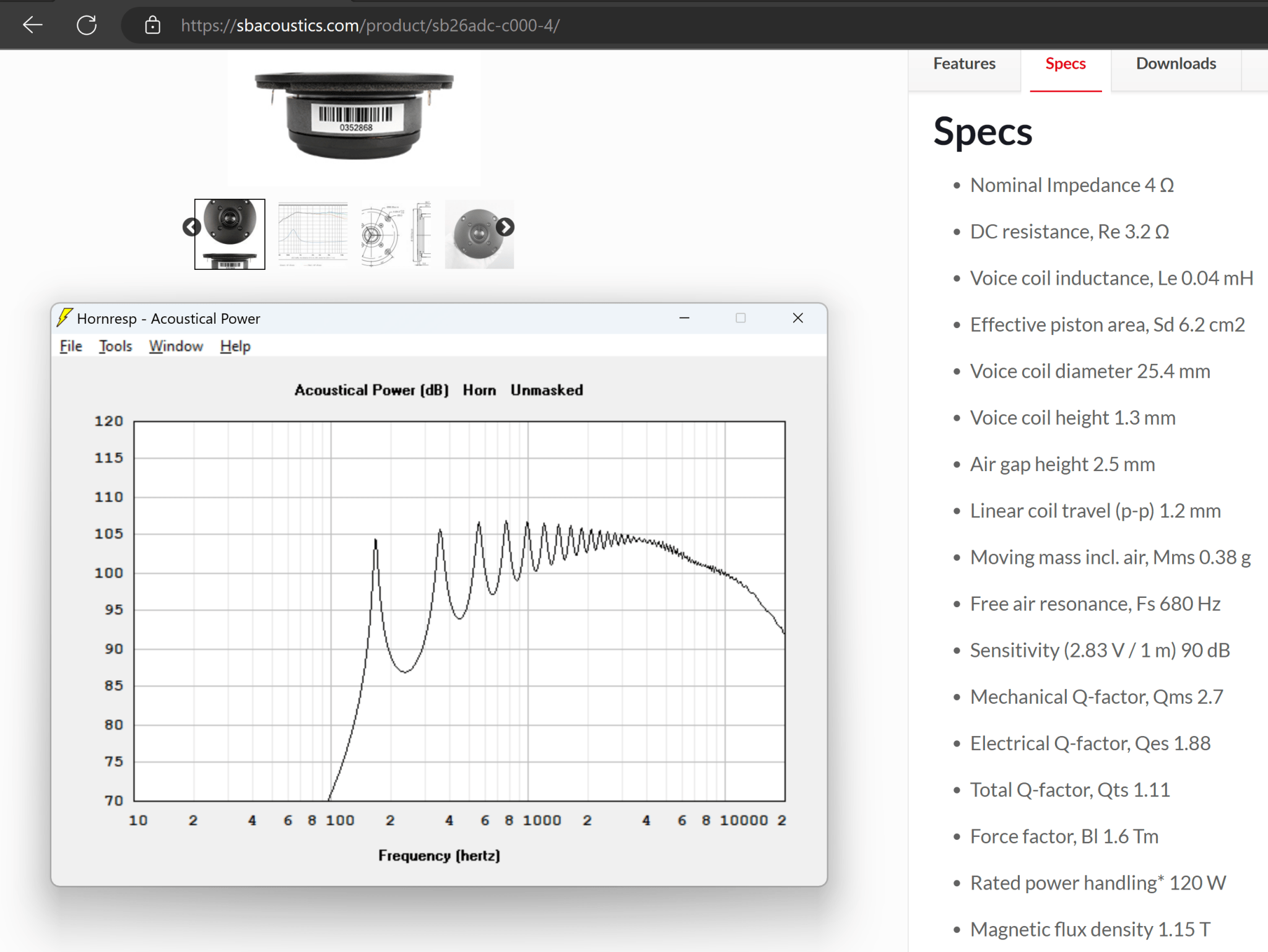

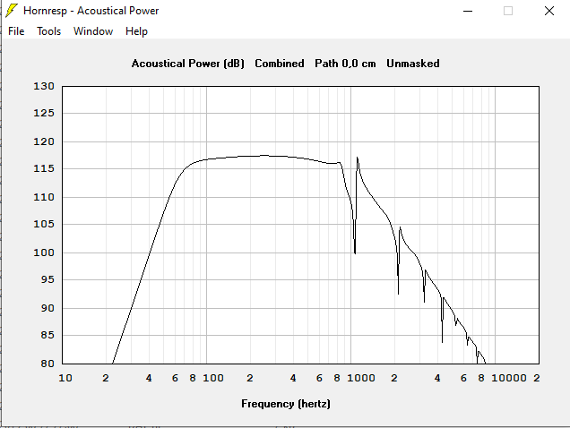

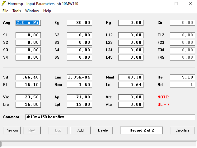

Hello guys, trying to simulate a bass reflex cab around this driver: https://www.sbaudience.com/index.php/products/woofers/bianco-10mw150/
The driver specs claim 65-5000 hz but I cant even get it up to 1000 hz without dropping off badly. Am I doing something wrong in my simulations? Included picture and wanted to include hornresp file if someone can check it out for me but it did not want to upload. The store that sell the driver claim it will reach 2000 hz with a good wide pattern (about where I want it to be to cross to a tweeter). Thanks for any help.
It's because the power response is being calculated, not the pressure response.
The pressure response of the driver can be calculated by selecting the Tools > Output > Direct Radiator menu commands from the Acoustical Power window and then selecting Tools > Directivity > Response. This will give you an idea of how the system will perform when driver directivity is taken into account.
To export a record, select File > Export > Hornresp Record from the main Input Parameters window.

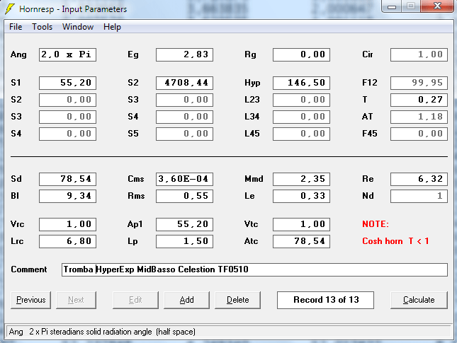

I am designing a front loaded exponential mid bass with a celestion TF0510 (cone) 5" driver.
Desired range is 200 to 900 Hz.
This is what I managed to obtain with the "Tools --> System design --> With driver" utility from the input parameters window.
Seems good enough but I have two questions:
1. According to David Mc Bean suggestion a few post above, I tried to check the pressure response of the driver by selecting the Tools > Output > Direct Radiator menu command from the Acoustical Power window, but the command "Output" is greyed out and cant be selected. How do I check pressure response and is it needed ?
2. I have managed to import the horn data into skecthup after making it rectangular. Now, this horn should be "bent" at 90° at some point due to space constraints, so the driver stays behind the woofer cabinet as it points up.
I can easily "bend" the horn by progressively rotating the width segments of the side profile, handling them by their center. Let's say for the sake of argument that I rotate 10 segments by 9° each to obtain a 90° bend. In this fashion the inner part of the profile gets shorter, the outer gets longer, and the "centerline" of the horn remains equal to the original data. Is this procedure correct ?
That's because your design has only one output, whereas Osse's bass reflex design had two.
Select Tools > Directivity > Response. Whether it is needed or not is for you to decide 🙂.
It seems reasonable to me.

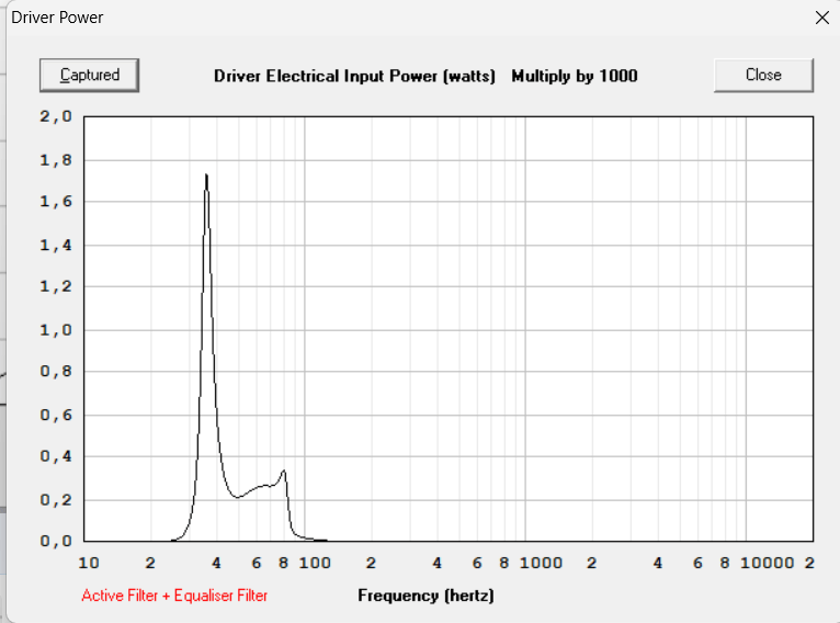

Hey David, all folks,

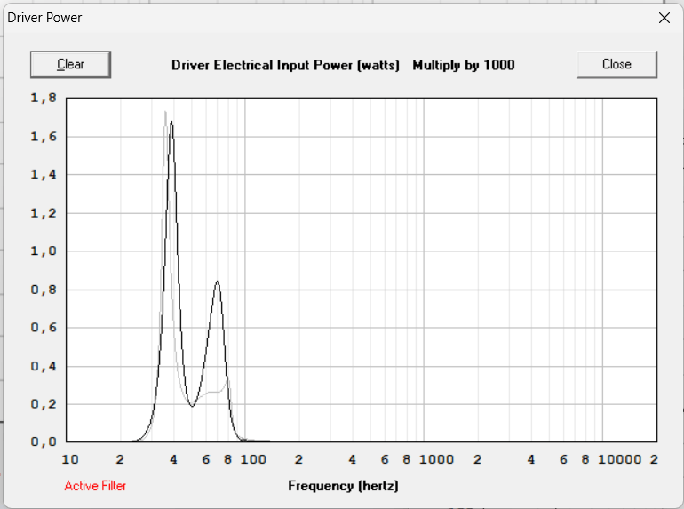

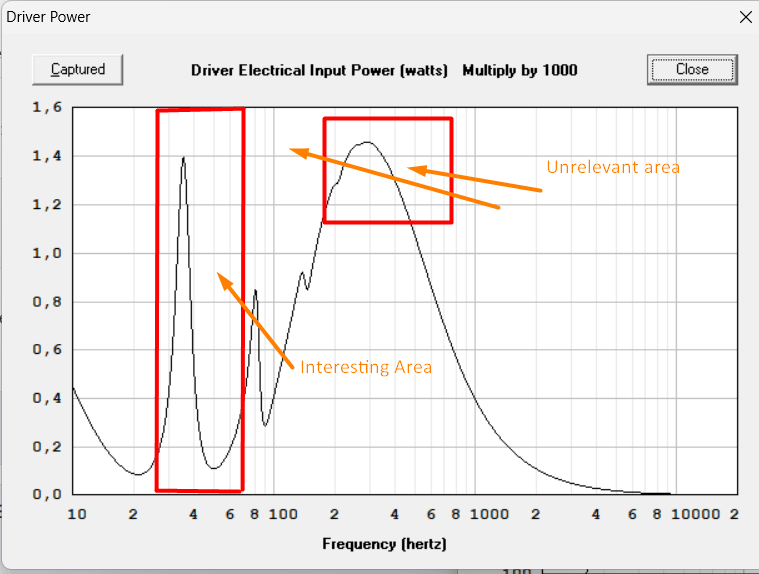

i have a question about the "Power compression" feature in HR. Of course, it depends largely on the voice coil size/material/cooling ability of each individual driver, but it is very useful to compare different designs with identical driver IMO.
My question is:
After input and simulation, i guess HR takes the driver power of the entire frequency range to calculate a mean value of maximum input in volts for an input of say 200° of voice coil temperature.
Is that correct ?
My idea is, that the excessive power input at well above 100Hz ( shown in pic 1 ), is out of interest with a subwoofer setup 30Hz-70Hz, therefore it would be great if there could be a selection not only of the temperature, but the frequency range for maximum temperature.
Ideally, the power compression function would also possible to apply AFTER the filter+EQ setup, therefore one would be able to compare power compression of different cabinets including setups with identical driver.

Thanks for your reply David.
