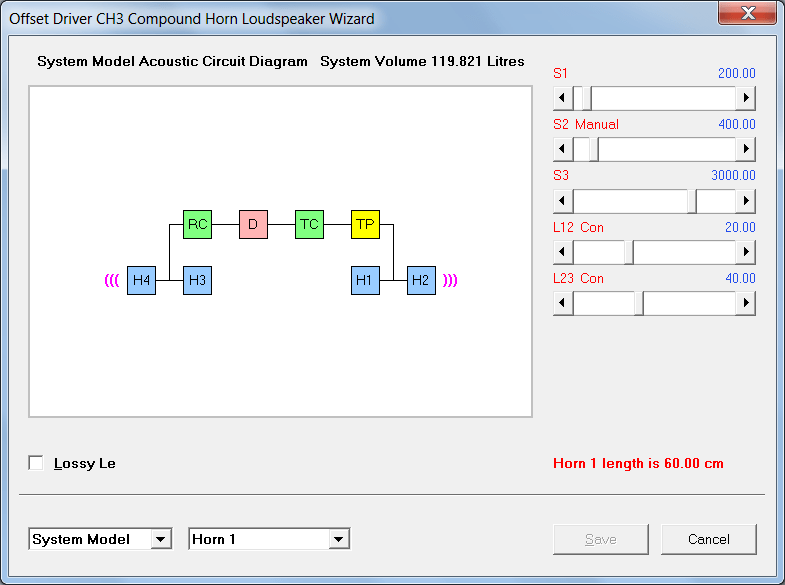

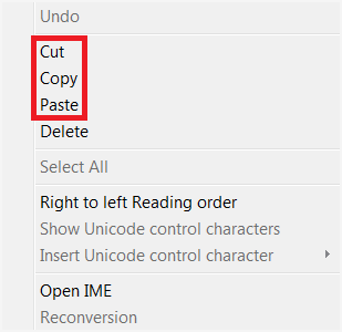

Hi Everyone,

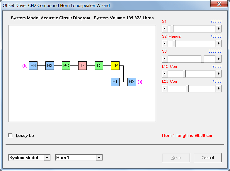

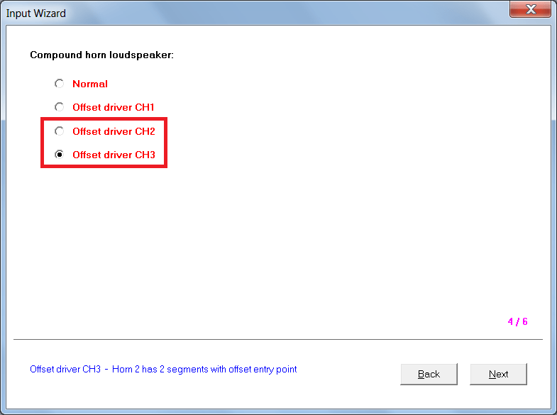

CHANGE
The CHX and CHY configuration options suggested by LORDSANSUI in Posts #13,327 and #13,338 have now been added as CH2 and CH3. Attachments 1 to 3 refer.
Significant changes have been made to existing code and a considerable amount of new code has been added, with bugs possibly being introduced as a result. Could you please report any problems experienced when using the new CH2 and CH3 options.

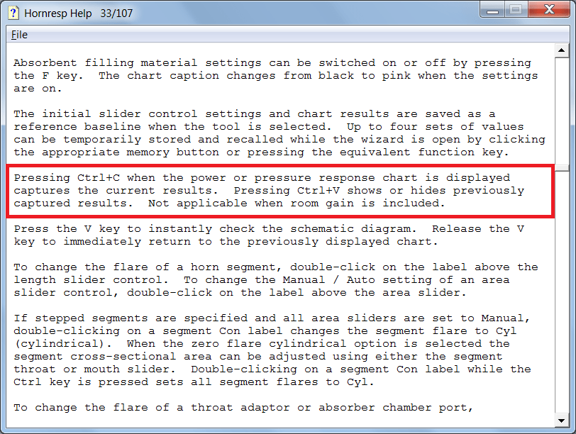

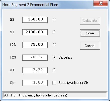

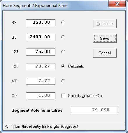

BUG FIX 3
The segment / system volume information displayed in the Horn Segment Wizard was inadvertently hidden when the status bar panel was added to the bottom of the form in Version 54.30. This has now been fixed. Attachments 4 and 5 refer.
Hello David,
Thank you so much for this implementation and spending time to always improve Hornresp and push it's capability limit.
I'm going to implement new Manifold options using those new configurations.

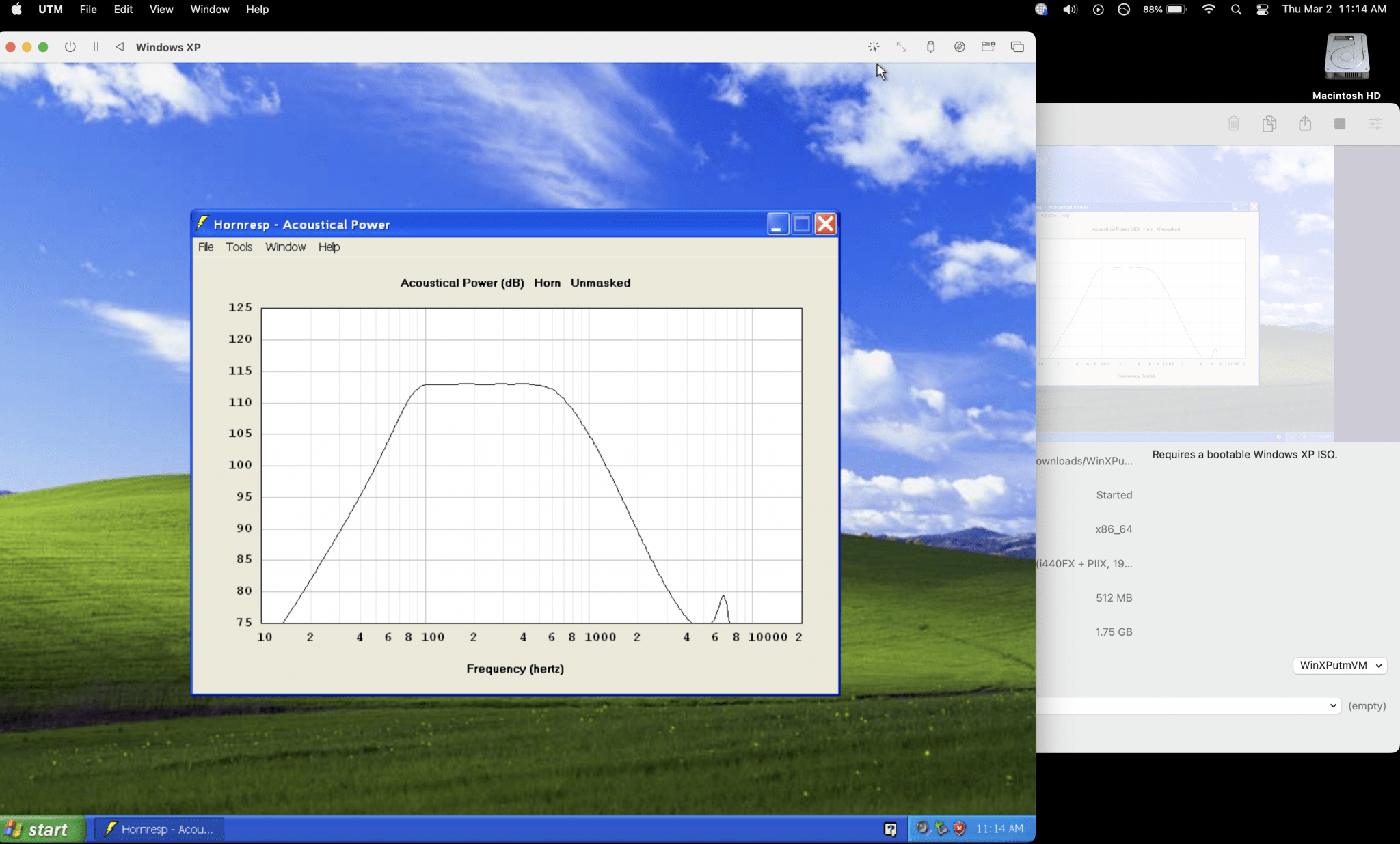

For the Mac crowd, I just got Hornresp running on my M1 MacBook using UTM (free) to run Windows XP (old school). I haven't played around with it too much yet but I did drop in a Hornresp.dat file from a previous Windows machine, and it loads it and runs a simulation. For anyone interested, I followed these directions: https://mac.getutm.app/gallery/windows-xp
and here:
The other helpful tidbit is directory sharing doesn't seem to work between the virtual machine and Mac in UTM using WinXP, but if you plug in a thumb drive the VM can see that.
and here:

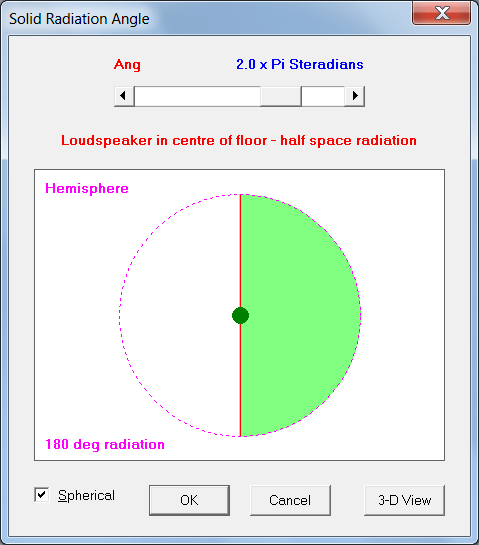

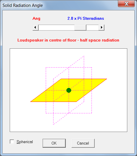

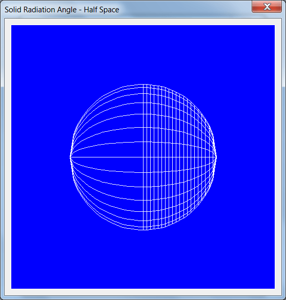

I have a question - about how Hornresp is showing the output from the terminus opening - it would be into what kind of space? A full sphere, or a half sphere? If the terminus opening on my cabinet is right on the floor, will the output from it be "lifted" by a specific quantity?
In other words, if Hornresp is showing what the speaker with have into a space with no floor in it, then can I calculate a specific increase in the output from the terminus opening?
Also John, on your M1, "Play on Mac" and other Wine-type programs can be used to host HornResp. Not really sure how it works but it sets up windows-like directories. Updates from David are handled in much the same way.
I used wine bottler in the past until 2019 when Apple broke running 32bit apps. I've had zero luck trying to use wine directly on any software I've wanted to use.
