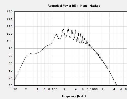

There will be internal resonances in any enclosure that has parallel walls. Perhaps do a little math and find out if your dip is related to a full, quarter or half wavelength of your enclosure. Frequency divided by the speed of sound. 450/340= 1.323 metres 52 inches, 26 inches. Your stuffing is not 100% absorbent. And Hornresp is one of the few simulation programs that will simulate internal reflections.
Mark
If a segment is not a cylinder, hornresp can't know with what dimensions(narrow/wide box) S is achieved in a real box, so how does Hornresp calculate these internal reflections?

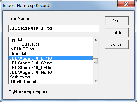

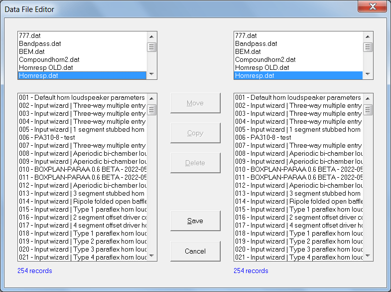

probably wine-related, so just for information and low priority, when cklicking
"File" -> "Editor...", it crashes with this message:
Also, whem importing a Hornresp-sim by "Import" -> "Hornresp Record", this only works
by typing the full name.txt, as the import-window is always empty, no matter what *.txt-files are in there.
Both functions still good here on my (now old) distro build of wine 5.0, FWIW.
Thanks for the feedback. It seems that the problems must indeed be Wine-related, as everything works just fine for me using Windows 7.

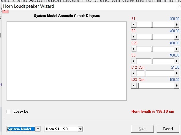

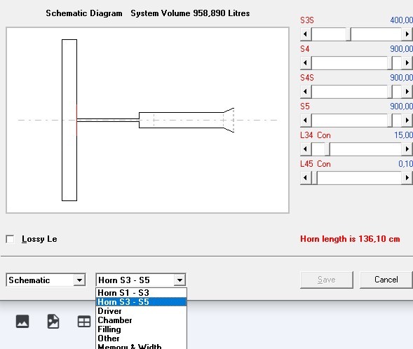

Hello David,
I have good news🥳🥳🥳🥳🥳🥳
Besides you were not be able to install FreeCAD in your PC to test the models and considering I have seen some people with difficult to use the models, this situation push me to create 12 videos to serve as tutorial. I would appreciate a lot if you could spent little part of your time to watch at least the Basic 1 and the automation levels.
thanks in advanced and best regards,
Marcelo
https://freeloudspeakerplan.rf.gd/pages/tutorial.htm
Hi Marcelo,
Your videos are amazing. I have watched Basic 1, Basic 2 and Automation Levels 1 to 5, and will view the remaining How2use 1 to 3 and Extras 1 and 2 just as soon as I can. It is obvious from the videos that you have developed an incredibly powerful tool - one which effectively takes the guesswork out of designing and optimising a folded-horn loudspeaker cabinet.
I also have some good news - your CHX (CH2) and CHY (CH3) compound horn options will definitely be included in the next update 🙂.
Kind regards,
David

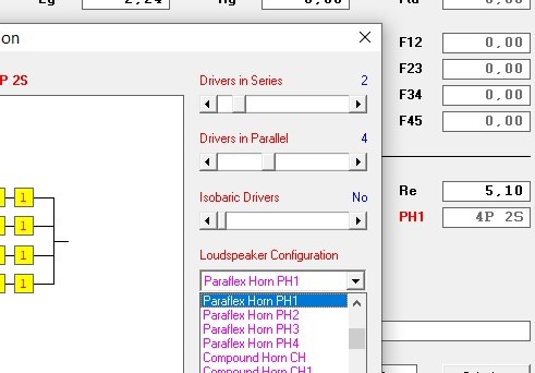

I investigated some more and now i can replicate it. If you are in PH1 mode, and mess around with the speaker configuration. For example changing series and parallel config it and calculate it goes into the fubar mode noted above. it then is stuck in a OD type horn situation. Once i switch from for example from PH1 to PH2 and back (using the dropdown) it resets itself and calculate correct response again.
Hi USRFobiwan,
Many thanks for the feedback, and for going to the trouble of identifying the specific sequence of events that causes the problem. Bugs that do not generate a run-time error message are normally more of a challenge to track down, and being able to reproduce the problem at will makes it just that much easier to resolve such issues.
The bug has been found and will be fixed in the next update.
Kind regards,
David
