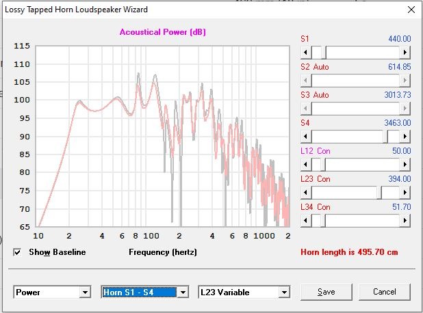

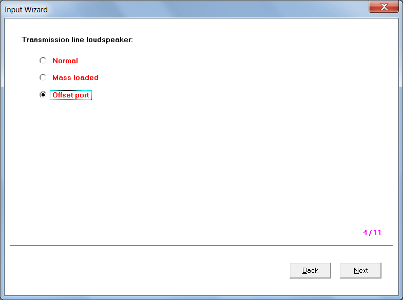

is it possible to design a transmission line, with the location of the port in any place?
Hi SImulacra,
Welcome to diyAudio!
Yes, it is possible. Use the Input Wizard to specify the required configuration and then modify the parameter values to suit your specific design. The Input Wizard is accessed from the Help menu on the main Input Parameters window.
Kind regards,
David

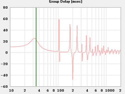

I want to use my speaker to build a subwoofer with a transmission line. Have I calculated everything correctly, or is it possible to change something?
You could keep going with the simulation and try gradually adding amounts of fill material to the first 2 chambers to smooth the dips and peaks and optionally the third. The loudspeaker wizard routine can be used to good effect. Not sure if design is final, but if not you could experiment with tapering the line to quell some resonances.
Reactions: Kravchenko_Audio
Thank you for advice
Could you please post the export file for your design.
Added an export file.

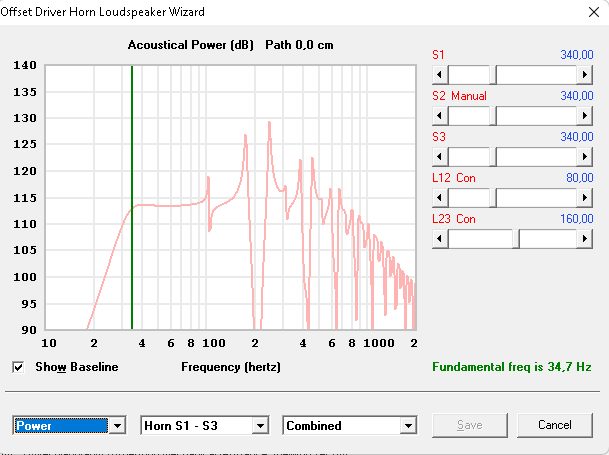

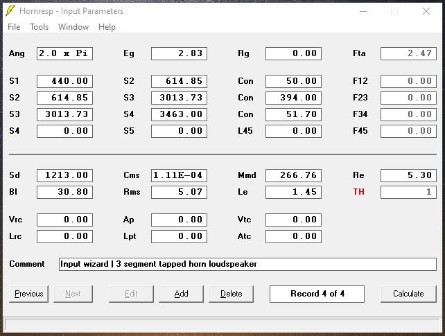

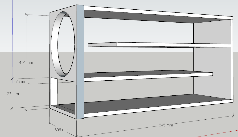

Looking for help getting through my first attempt at designing a 25hz tapped horn. can anyone help me learn what mistakes I might be making?
