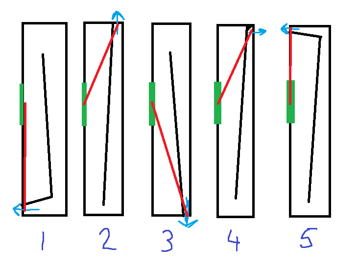

See attached sketch of five TL deisgns, bottom of sketch = floor, right side = towards wall, left side = towards listening room, top = towards ceiling.
1. Re. TL design: does exit location and direction (blue arrow) matter? If so, what is generally considered "optimal" and/or how would the 5 sketches differ in in-room response?
2. Hornresp usage: is the length of "path length" accurately shown by a) the red lines in the sketch? Or does this b) need to be calculated along the loudspeaker sides (i.e. 1 and 5 are correct, but 2,3,4 require red lines that follow along the edges of the loudspeaker) [EDIT: for my question #2, answer seems to be given here: To calculate the combined power output, the pressures, phases and physical separation of the two sources need to be known. For the purpose of the exercise, the loudspeaker enclosure itself can be considered to be "invisible". We are only interested in the straight-line distance between the two sound output point sources. If I interpret correctly, the red lines in my sketch accurately show path length).
As far as the power response is concerned, if the loudspeaker is suspended in free space (Ang = 4 x Pi steradians) then it doesn't matter where the exit port is located. If the loudspeaker is close to walls however, it will make a difference, depending upon the radiation impedance conditions applying at the port.
As far as the pressure response is concerned, the location of the exit port will affect the results in all cases, except in free space at very low frequencies, where the sound radiation is essentially non-directional.
The best position for the port is most likely to be as shown in your #1 option.
Yes.

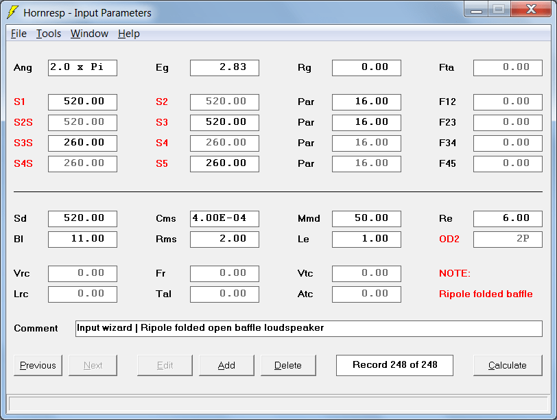

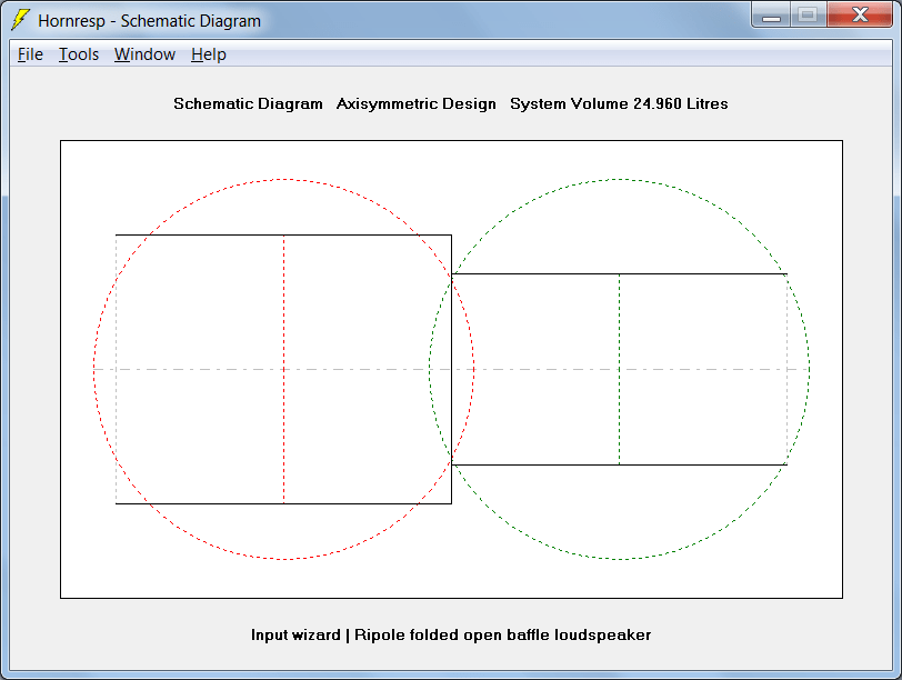

I have 2 woofers in a slot, that is 20" deep....The rear of the woofers fire into rear side of the "ripole" baffle, and it extends 32"....
I'm not exactly sure from your description how your system is configured, but Attachment 1 shows how to specify a Ripole loudspeaker in Hornresp.

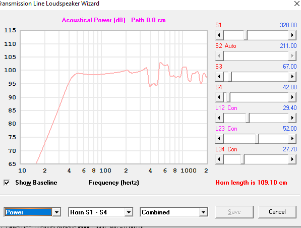

Hi folks - I am working on a TL for a SB Satori mid-woofer, and I've got nice flat extension in the bass, but a nasty
dip at 400-500Hz. I can't seem to get rid of this. Is it a sim artifact, or will my build have a big problem?
HR export attached.
BTW, thanks so much David McBean!

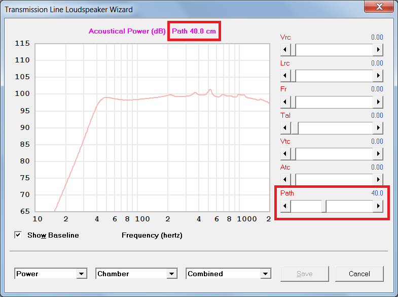

Setting the “path” dimension I found in some cases helps with the apparent ripple.
Reactions: joetekubi
HR export attached.
There will be internal resonances in any enclosure that has parallel walls. Perhaps do a little math and find out if your dip is related to a full, quarter or half wavelength of your enclosure. Frequency divided by the speed of sound. 450/340= 1.323 metres 52 inches, 26 inches. Your stuffing is not 100% absorbent. And Hornresp is one of the few simulation programs that will simulate internal reflections.
