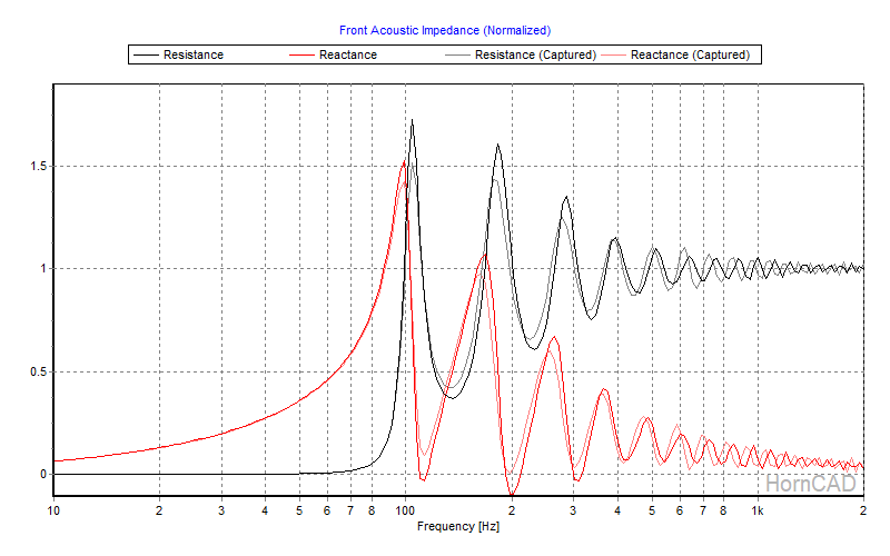

Getting back on topic, Hornresp can simulate group delay, and can also overlay a curve developed by Klaus Futtrup on the limit for audible group delay.

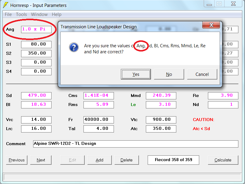

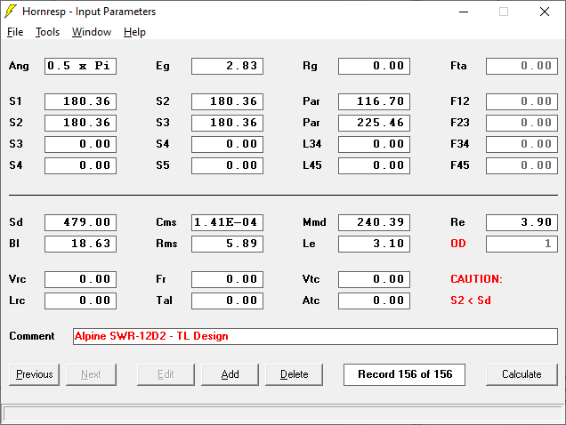

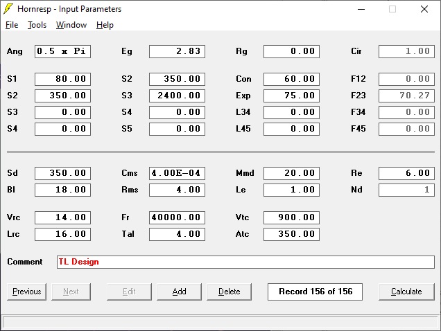

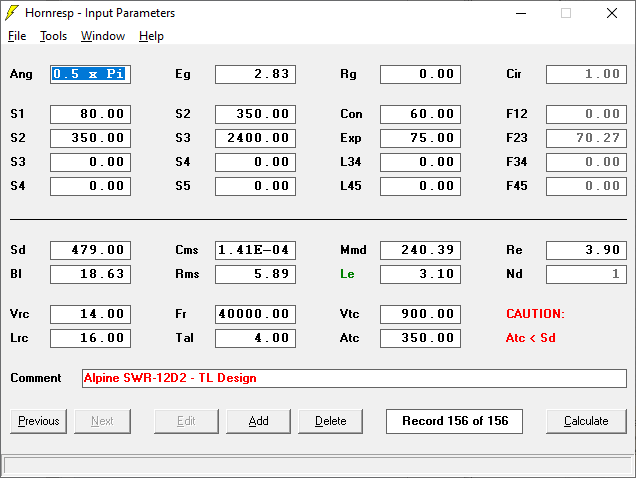

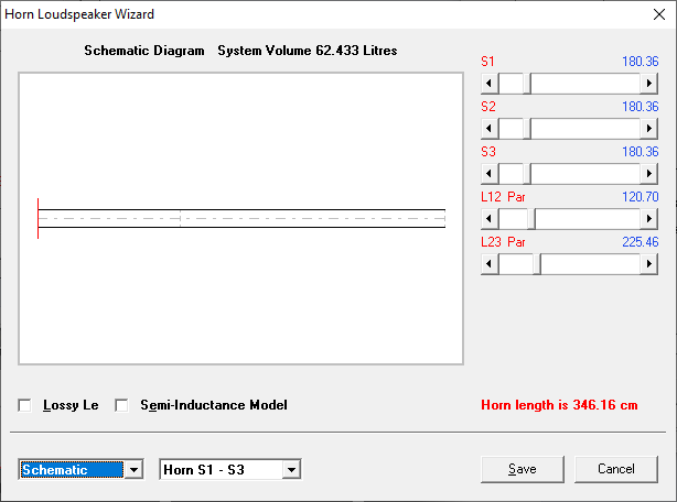

David, I'm running into some "strange" errors in Hornresp, that I'd like to bring to your attention.
Let's start by using the "TL design" feature.
First I create a new record and call it "TL Design"
Then I select the "Paste Driver from Database" option to select one of my sample drivers, in this case an Alpine Type R...
Then I select the "TL Design option... " and the "BS 2002' method and then select "Save"
The first thing that sticks out at me is that "Ang" hasn't changed. It should be changed to 2.0xPI. The methods provided by Martin King and myself assume 2xPI loading (well, for my method yes. I'm fairly certain it's assumed for MK's methods as well).

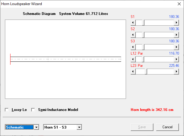

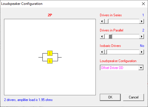

Issues also arise when the number of drivers is changed (e.g. from 1 to 2) ...
Now, when I go into the "Schematic" view, it's no longer showing an OD alignment (note the position given for the driver). And L23 is no longer automatically adjusted when L12 is changed....
I've seen other sporadic errors turn up in the model as well, and they all seem to originate with changing the number of drivers.

Hi Brian,
Many thanks for the feedback.
Because the dimensions calculated by the TL Design tool models are independent of the specified Ang value I had assumed that there was no need to set it to a particular value. As a result of your comments however, in the next update Ang will be set to 2 x Pi when the TL Design tool is used.
I have found the bug and it will be fixed in the next update.
If you happen to identify any more of the sporadic errors, could you please let me know. One thing to be aware of is that advanced driver parameter values are not taken into account in the TL Design tool and are switched off when results are saved back to the main input parameters window.
Thanks again for the valuable feedback!
Kind regards,
David

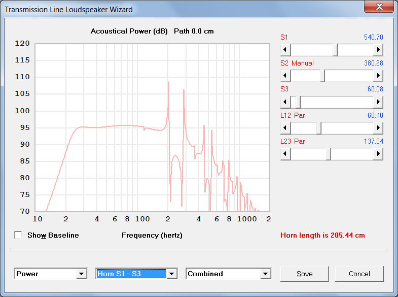

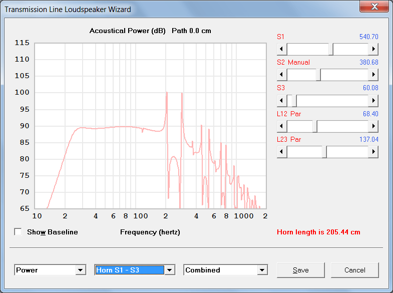

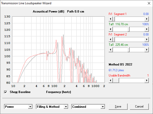

Hi Brian,
After giving it some further thought, perhaps it would be best to leave things as they are 🙂.
As indicated in my previous post, the system dimensions calculated by the TL Design tool models are independent of the Ang value setting. Also, before the TL Design tool opens a message is displayed prompting the user to check that they have specified the correct Ang value, as shown below.
If the user intends positioning the transmission line loudspeaker on the floor against a wall, then it seems to make sense to allow Ang = 1 x Pi to be specified in the TL Design tool so that the calculated results reflect the intended location, rather than setting Ang = 2 x Pi for all cases.
The first image below shows the 2 x Pi power response obtained using the BS 2022 method with usable bandwidth = 5. The second image shows the 1 x Pi power response obtained using the same method and bandwidth.
Given the above comments, can you see any problems in leaving things as they are?
Kind regards,
David

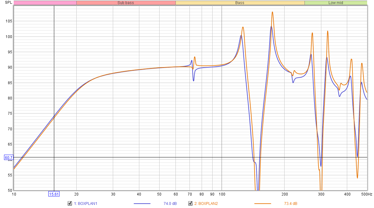

The estimates for optimum Fb are based on 2*PI space but going by the sim'd results the only thing that noticeably changes at low frequencies is amplitude, so I'd leave it as it is.
Fb in the BS 2022 method is calculated as shown below, using driver parameter values only. The power response level will change due to the different loading conditions (which are dependent upon the value chosen for Ang).
Vb = 20 * Qts ^ 3.3 * Vas
Fb = (Vas / Vb) ^ 0.31 * fs
Excellent. The 'missing OD alignment' bug you found will of course still be fixed in the next update.

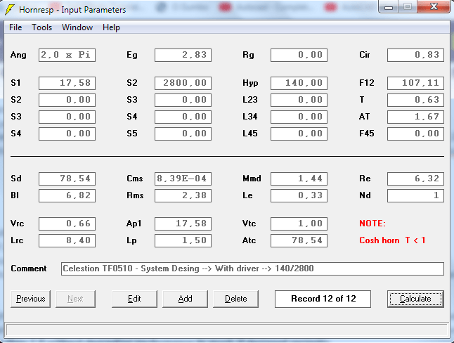

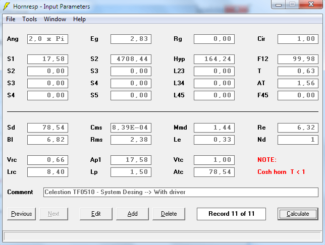

I have a few questions regarding the profile design. Front loaded mid-bass horn, 200 to 1000Hz, home use.
Is there any difference in the horn response when choosing a rectangular horn profle vs the "standard" profile proposed by Hornresp ? Also, how the widht flare (con - exp - uni) has an influence (if any) on the horn response ?
With regard to "bent" horns, I read somewhere that this should be avoided, but I see plenty curved horns. Is there any rule that one is supposed to follow to "bend" a horn so that this doesn't influence the response too much ? I am talking rounded "bend" in a front loaded not "fold" as most back loaded.
Should the bend be distributed throughout the whole lenght or it can be implemented at some point around the middle of the horn (provided that the bend is not tight) so that the segments near the throat and the mouth are rectilinear ?
The idea is to wrap a 140-160 cm mid bass horn around the top and back of the box that hosts the woofer, with the driver pointing upward. This would result in a 90° bend at about half the lenght of the horn. A mid-high horn goes on top of it.
I've been trying to model a 80-90cm horn for two days (with several drivers) so I don't have to bend it, but I lost hope as in no way I can make it nice and linear down to 100Hz (so it can be crossed at 200).

There is a difference in how the mouth radiation impedance (and therefore the reflections from the mouth) behave in circular vs rectangular horns. They are pretty similar when the horn is square, but as it becomes more rectangular, with a larger aspect ratio, you need a somewhat larger mouth area for the same level of reflection. In general, horn mouth size for a circular horn should be about one cutoff wavelength in circumference (Cir = 1), as the horn is placed near walls and floor, the required physical area is reduced. Hornresp automatically adjusts Cir when Ang changes so that Cir = 1 would produce about the same level of reflections for all values of Ang.
Cir = 1 means the diameter is one third cutoff wavelength. For a rectangular horn with an aspect ratio different from 1, the smallest dimension should be one third cutoff wavelength for the same level of reflection. The first attachment shows the difference in throat impedance between a circular exponential horn (overlay) and a rectangular horn with an aspect ratio of 1:3 (H:W). The difference is not huge, and only really becomes important for fairly large aspect ratios.
Also, when a horn is placed near boundaries, these boundaries act like acoustic mirrors, and the total mouth area is the sum of the physical horn mouth and all the mirror images. This means that the effective mouth aspect ratio should be taken from the total, not just the physical horn. A horn with an aspect ratio of 1:1 (H:W) placed on the floor, will have an effective aspect ratio 2:1 and so on.
The influence of the width flare is small, no noticeable effect on reflections unless you get a very pinched throat part. Directivity will change a little, but the horn doesn't have much control over directivity in this range anyway.
When it comes to bends, bends are better than folds, and large bends are better than tight ones. Usually folds create big dips and notches in the response, sometimes quite wide ones too. With bends it's easier to get a wideband response. A couple of years ago, I build a bass horn with two bends, which has smooth response up to 900Hz (this is just looking at the smoothness, it starts to roll off above 600Hz). See Big Bend horn performance measurements. The blog article series may have some other info that's useful to you.

Hello David,
I'm a new Hornresp user and really like your work, thank you.
I've been trying to use Hornresp for micro speaker simulation, but somehow can't input accurate chamber volumes below 0.0005 Ltrs, (On AJ Horn I am able to input very small values). Also how we can view the loudspeaker wizard simulation above 2000Hz? I would really appreciate your help. Thanks
GQZ
GQZ
Hi GQZ,
Pleased to hear that you like Hornresp 🙂.
Double-click on the Vrc label in Edit mode to select the cubic centimetre option. You can then specify a rear chamber as small as 0.01 cm^3 (10 mm^3). The standard minimum value for the throat chamber volume Vtc is also 0.01 cm^3 (10 mm^3).
Double-click on the Loudspeaker Wizard Frequency (hertz) chart label. Not applicable when absorbent filling material is included.
Kind regards,
David

Kolbrek, thank you very much for your reply, which I took some time to elaborate.
It is not clear to me if one should take into account the acoustical power diagram indipendently of the Cir value or viceversa.
I have modeled two horns. One with Cir = 1 and another with Cir= 0,83, the second one being MUCH smaller and a little shorter.
The difference in the acoustical power diagram is marginal and it happens on the top corner of 100Hz on a horn which is supposed to be crossed at 200, so that "difference" should be well above the actual crossover curve. For this reason I'd rather trade that small difference at 100hz for a much smaller mouth and shorter lenght. See attachments below
Big Mouth Long Horn 4700/164 (Cir =1).
Small Mouth and shorter horn 2800/140 (Cir = 0,83)
Now if I make the "small horn" rectangular this results in 70x40(height)cm. horn size.
Wavelenght at actual crossover frequency of 200Hz is 1.725 which divided by 3 = 0,575 which is larger than the calculated 40cm height.
That's of course even worse if I take into account wave lenght at 100Hz, (that is one octave below actual crossover point).
Now the question is, how is that supposed to impact on the actual horn response, considering actual crossover point (200) and that the hornresp manual reads as follow:
In most modern horn designs the actual mouth area is smaller than the optimum mouth area (most often a compromise between gigantic size and actual performance needed). About the reasoning behind this you can find more information in the Speakerplans FAQ's and general horn theory found on the www. In short you can get away with a CIR smaller than 1.0 without degrading performance to much if designed correctly.
I guess the problem lies in the words "designed correctly".
In this regard the horns I designed appear to be MUCH more linear than the average midbass horns I've seen on the www, as most are not nearly as flat in the intended range (actually they all appear all "rounded"). Can mine be considered a "correct design" ? Too conservative ? (i.e. not required to be so flat).
The reason i am concerned about linearity at one octave from actual crossover points is that i read (and was warned) that acoustical cutoffs too near (less than one octave) from the actual electrical crossover points result in massive phase shifts at the electrical crossover point, which I'd rather avoid if possible.
Also it is not clear to me what the actual Ang value should be in "real life" home environment. This horn is to be placed on the woofer box at 90cm from the floor and the back wall, and 70cm from the side wall. I considered Ang as 2.0 x Pi (as average).
Is this correct or should I consider 1,0 x Pi (or maybe 1.5) due to the horn being relatively close to a corner ? As you explained this would result in the possibility to go for the smaller horn wihout much worries.
Also the hornresp manual suggests a Ang value of 1,0 x Pi for Hi-Fi applications so perhaps I am indeed being too conservative even on the Ang. value ?
I also have some questions about the "matching impedance" of the driver and horn you mention on your blog, but let's discuss one problem at a time.
Thank you for your patience and MUCH appreciated cooperation.
